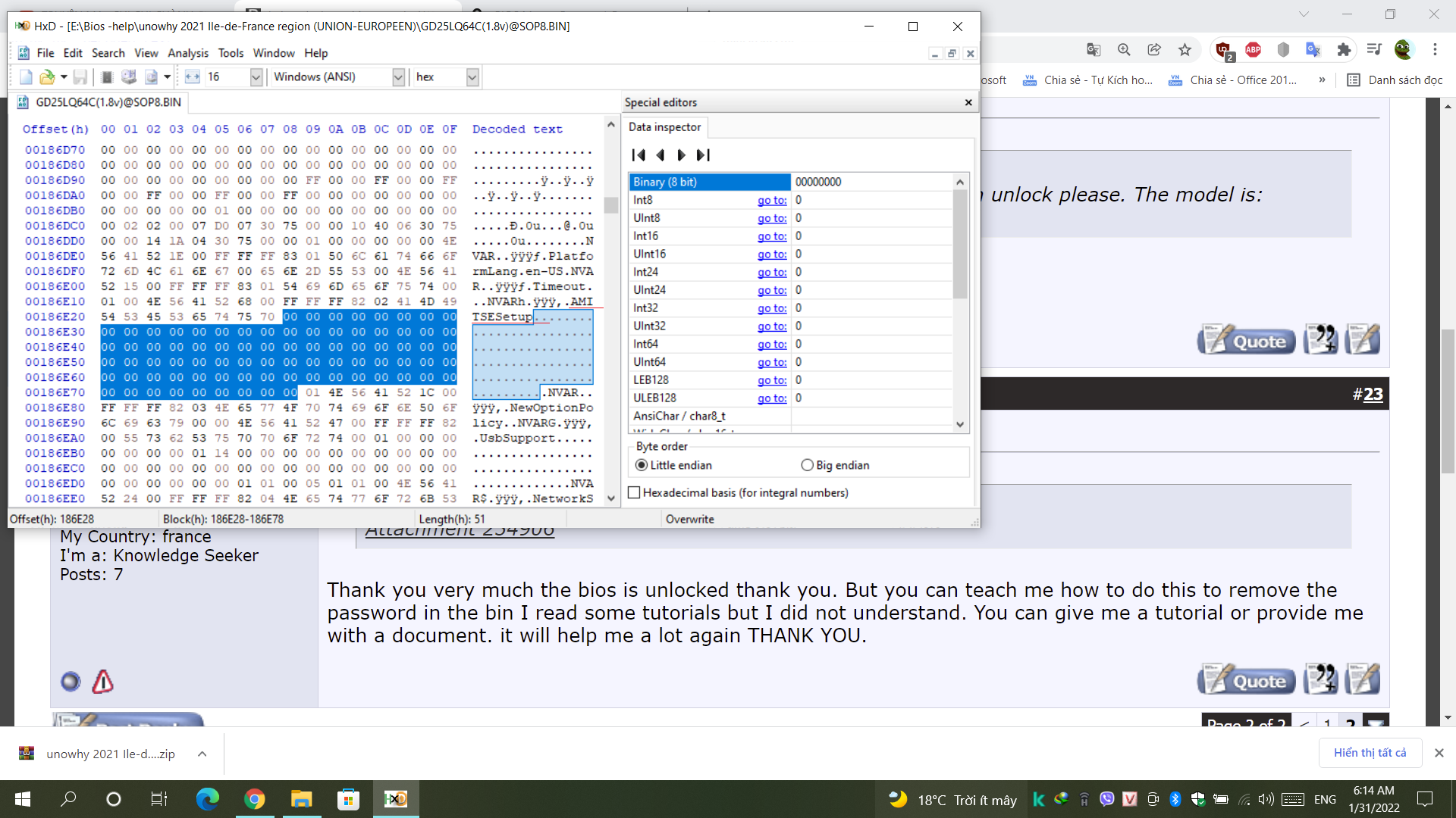

        Thank you very much the bios is unlocked thank you. But you can teach me how to do this to remove the password in the bin I read some tutorials but I did not understand. You can give me a tutorial or provide me with a document. it will help me a lot again THANK YOU.

          Find the keyword " amitsesetup" and select the block like the picture attached and fill it with the characters " 00 00 ...".

            Thanks I tried to do as you said so it works perfectly can I ask another question as I have a lot of questions about cleaning bios with HxD software.
            *To clean the original bios image?
            * How to remove bios password from another computer like: HP, LENOVO, ASUS etc...
            I stop on these two questions so THANK YOU.
