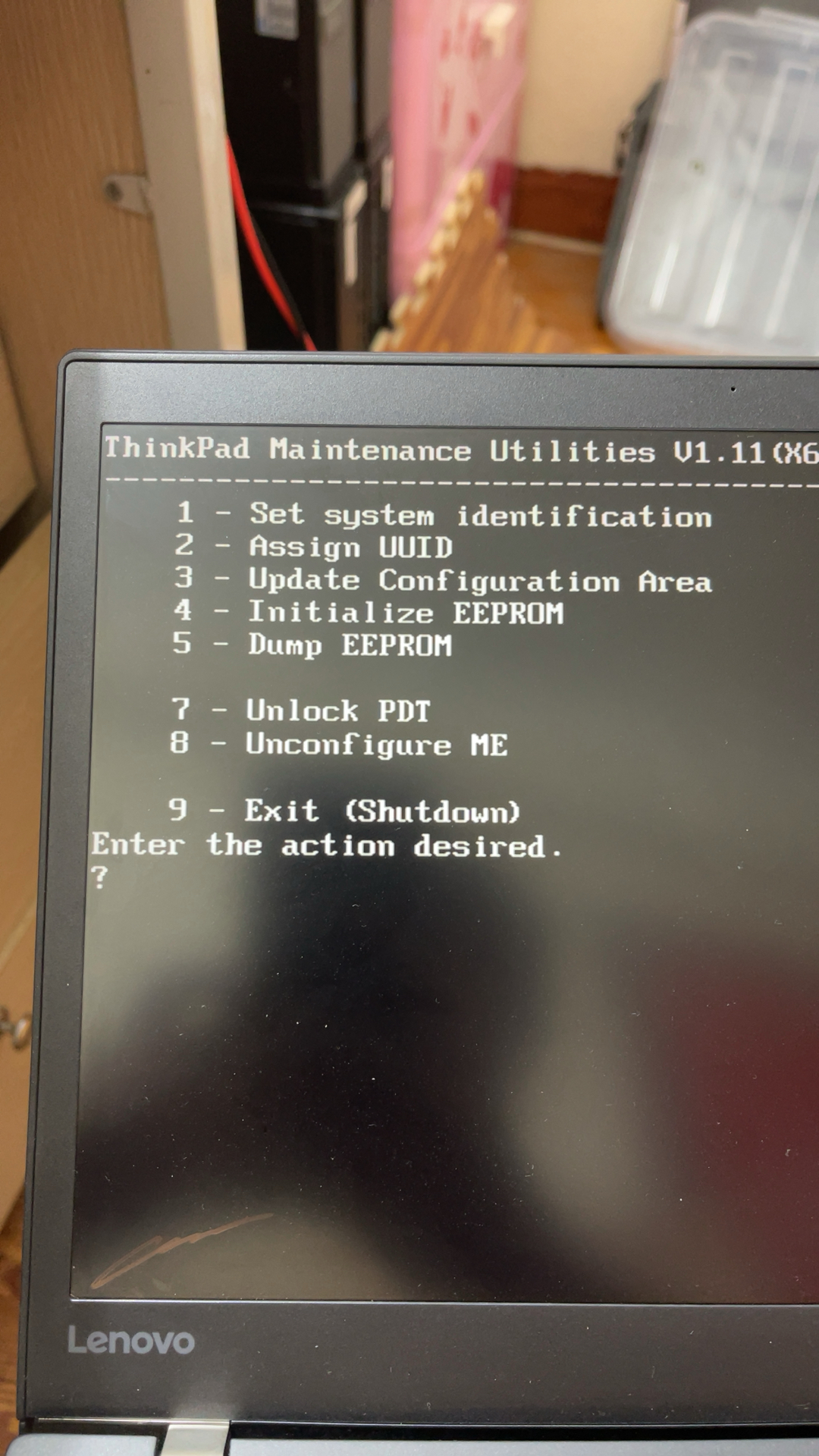

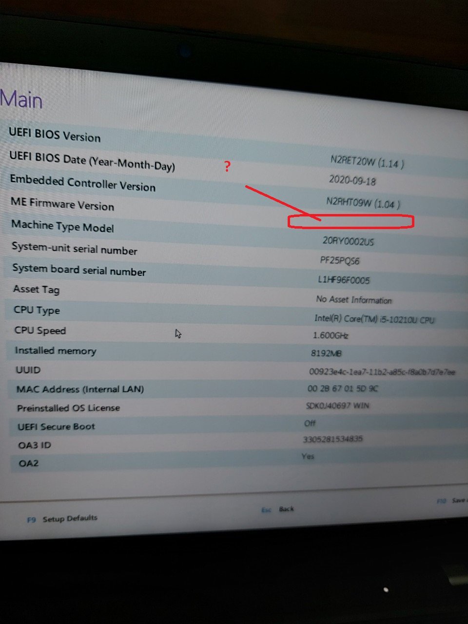

    HI, some one can help me clean this bios
    I using GoldenKey and Unconfigure ME firmware
    now ME not show on bios

      https://github.com/ASparkOfFire/lenovo-u1-tool

        Re: Need clean ME thinkpad 10th Gen T490s
        What programmer did you use to read/write MEC1663?
        And here's a T490s file with clear ME. It is not made from your file but maybe it helps.
        • black0hackers
          • Jul 2020
          • 369
          rtf809H. your file is t490s gen8, i need t490 gen10
          • RethoricalCheese
            • Mar 2013
            • 1519
            • Estonia
            Oh well, title has T490s
            Here's T490 with clean ME.
            • black0hackers
              • Jul 2020
              • 369
              your file is T490 CPU 8Th Gen. i need 10th Gen

                Why did you uncofigure it ?
                • black0hackers
                  • Jul 2020
                  • 369
                  i have wrong choise. haizzz
