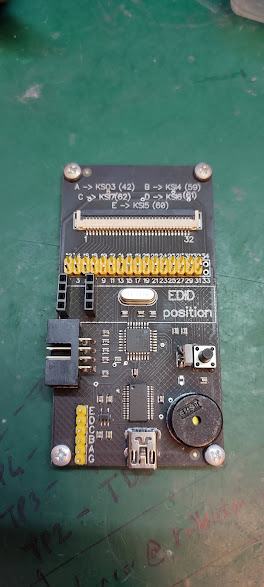

Lenovo ThinkPad E15 Gen2 NM-C771 need dump
  • clrscr
    • Dec 2020
    • 186
    • sing
    Re: Lenovo ThinkPad E15 Gen2 NM-C771 need dump
    hi every one, please help me remove password. in EC dump (lenovo E15 Gen2). thanks
    all donations are welcome,
    >>>>> click on this link to donate via PayPal. <<<<<
    • ChetanSethi
      • Oct 2015
      • 11
      • India
      Re: Lenovo ThinkPad E15 Gen2 NM-C771 need dump
      I have nm-c771 thinkpad e15 gen 2 i read ec chip ite8227e 256 but show 128kb how to read full ec 256kb
        • 21992
        Re: Lenovo ThinkPad E15 Gen2 NM-C771 need dump
        Originally posted by ChetanSethi
        I have nm-c771 thinkpad e15 gen 2 i read ec chip ite8227e 256 but show 128kb how to read full ec 256kb
        Post your programmer model
        • Gel0@2703
          • Oct 2022
          • 5
          • pangasinan
          Re: Lenovo ThinkPad E15 Gen2 NM-C771 need dump
          thank you for this bios
          • tomodachi
            • Apr 2012
            • 612
            • Turkey
            Re: Lenovo ThinkPad E15 Gen2 NM-C771 need dump
            How do I read / Write IT8227E KBC with vertyanov programmer ?
              • 21992
              Re: Lenovo ThinkPad E15 Gen2 NM-C771 need dump
              Originally posted by tomodachi
              How do I read / Write IT8227E KBC with vertyanov programmer ?
              Do you have a genuine one or a clone ? .If you have a genuine one you can use the latest software,or a version above 8.2 (i think?) .If you have a clone you could pay sergey vertyanov for the official software.If you try and use the latest software with a clone it can brick the programmer,as far as i`m aware, there are other threads about the same problem.
              • tomodachi
                • Apr 2012
                • 612
                • Turkey
                Re: Lenovo ThinkPad E15 Gen2 NM-C771 need dump
                I have geniune one and my programmers software version is 4.D, which does not contain this motherboard, a little guidance would be good
                  • 21992
                  Re: Lenovo ThinkPad E15 Gen2 NM-C771 need dump
                  Originally posted by tomodachi
                  I have geniune one and my programmers software version is 4.D, which does not contain this motherboard, a little guidance would be good
                  what hardware version is it
                  • tomodachi
                    • Apr 2012
                    • 612
                    • Turkey
                    #29
                    Re: Lenovo ThinkPad E15 Gen2 NM-C771 need dump
                    This is
                    marking on pcb says JIG_M88_Vertyanov
                    Last edited by tomodachi; 10-22-2022, 07:49 AM.
                      • 21992
                      #30
                      Re: Lenovo ThinkPad E15 Gen2 NM-C771 need dump
                      Originally posted by tomodachi
                      This is
                      marking on pcb says JIG_M88_Vertyanov
                      Its hardware version 2 . Try the latest software version 4.F http://vssh.store/VERTYANOV_JIG/OTHE...r%20PCB2.X.rar
                      • tomodachi
                        • Apr 2012
                        • 612
                        • Turkey
                        #31
                        Re: Lenovo ThinkPad E15 Gen2 NM-C771 need dump
                        Many thanks, will try
                        • tomodachi
                          • Apr 2012
                          • 612
                          • Turkey
                          #32
                          Re: Lenovo ThinkPad E15 Gen2 NM-C771 need dump
                          Originally posted by SMDFlea
                          Its hardware version 2 . Try the latest software version 4.F http://vssh.store/VERTYANOV_JIG/OTHE...r%20PCB2.X.rar
                          Many thanks, this version fixed my case.
                          • wishes2022
                            • Nov 2022
                            • 38
                            • china
                            #33
                            Re: Lenovo ThinkPad E15 Gen2 NM-C771 need dump
                            有没有刷bios能解密码的?
                            • hoaca388
                              Badcaps
                              • Jan 2022
                              • 12346
                              #34
                              Re: Lenovo ThinkPad E15 Gen2 NM-C771 need dump
                              Originally posted by wishes2022
                              有没有刷bios能解密码的?
                              English only , please !
                              • Koukou
                                • Mar 2022
                                • 4
                                • Algerie
                                #35
                                Re: Lenovo ThinkPad E15 Gen2 NM-C771 need dump
                                im disapointed i thought i bought the original one it turned out a clone and it can't read io chip with 256kb only 128kb
                                • massaru
                                  • Aug 2022
                                  • 2
                                  • nada
                                  #36
                                  Re: Lenovo ThinkPad E15 Gen2 NM-C771 need dump
                                  HI, i have this lenovo need unluck... i can read ite chip... I use vertyanov 4....
                                  but i try write other codes but dont can erase old code,,
                                  has anyone got this problem?
                                  it's like the ite only accepts the original code..
                                  I have already tried other codes, the vertyanov 4 can write, but when I analyze it, the code is the same as the original
                                  • huss584
                                    Hussein
                                    • Apr 2020
                                    • 230
                                    • Palestine
                                    #37
                                    Re: Lenovo ThinkPad E15 Gen2 NM-C771 need dump
                                    Hello
                                    I have Problem with attached dump the MTM & SN INVALED
                                    ThinkPad E15 Gen2
                                    MTM: 20TD004WIV
                                    SN : PF3J1X3H
                                    can Please somebody help me to edit SN & MTM
                                    Attached:
                                    Last edited by huss584; 09-04-2023, 03:50 AM.
                                    • huss584
                                      Hussein
                                      • Apr 2020
                                      • 230
                                      • Palestine
                                      #38
                                      Re: Lenovo ThinkPad E15 Gen2 NM-C771 need dump
                                      This is my old BIOS dump
                                      Attached file
                                      • phu885
                                        • May 2023
                                        • 2
                                        #39
                                        Re: Lenovo ThinkPad E15 Gen2 NM-C771 need dump
                                        i need help with removing Password for my E15 Gen 2
                                        SN: PF-22ED1P
                                        Type: 20T9-S01A00
                                        • hoaca388
                                          Badcaps
                                          • Jan 2022
                                          • 12346
                                          #40
                                          Re: Lenovo ThinkPad E15 Gen2 NM-C771 need dump
                                          Originally posted by phu885
                                          i need help with removing Password for my E15 Gen 2
                                          SN: PF-22ED1P
                                          Type: 20T9-S01A00
                                          https://www.badcaps.net/forum/showpo...42&postcount=4
                                            Lenovo ThinkPad X1 Yoga + USB-C Dock Gen2 (40AS0090AU) Hybrid (2-in-1) X Specification for Upgrade or Repair
                                            This specification for the Lenovo ThinkPad X1 Yoga + USB-C Dock Gen2 (40AS0090AU) Hybrid (2-in-1) can be useful for upgrading or repairing a laptop that is not working. As a community we are working through our specifications to add valuable data like the X1 Yoga + USB-C Dock Gen2 (40AS0090AU) boardview and X1 Yoga + USB-C Dock Gen2 (40AS0090AU) schematic. Our users have donated over 1 million documents which are being added to the site. This page will be updated soon with additional information. Alternatively you can request additional help from our users directly on the relevant badcaps forum....
                                            09-06-2024, 09:45 AM
                                            Lenovo ThinkPad X1 Yoga + USB-C Dock Gen2 (40AS0090AU) Hybrid (2-in-1) X Specification for Upgrade or Repair
                                            This specification for the Lenovo ThinkPad X1 Yoga + USB-C Dock Gen2 (40AS0090AU) Hybrid (2-in-1) can be useful for upgrading or repairing a laptop that is not working. As a community we are working through our specifications to add valuable data like the X1 Yoga + USB-C Dock Gen2 (40AS0090AU) boardview and X1 Yoga + USB-C Dock Gen2 (40AS0090AU) schematic. Our users have donated over 1 million documents which are being added to the site. This page will be updated soon with additional information. Alternatively you can request additional help from our users directly on the relevant badcaps forum....
                                            09-06-2024, 09:40 AM
                                            Lenovo ThinkPad X1 Yoga + USB-C Dock Gen2 (40AS0090AU) Hybrid (2-in-1) X Specification for Upgrade or Repair
                                            This specification for the Lenovo ThinkPad X1 Yoga + USB-C Dock Gen2 (40AS0090AU) Hybrid (2-in-1) can be useful for upgrading or repairing a laptop that is not working. As a community we are working through our specifications to add valuable data like the X1 Yoga + USB-C Dock Gen2 (40AS0090AU) boardview and X1 Yoga + USB-C Dock Gen2 (40AS0090AU) schematic. Our users have donated over 1 million documents which are being added to the site. This page will be updated soon with additional information. Alternatively you can request additional help from our users directly on the relevant badcaps forum....
                                            09-06-2024, 09:40 AM
                                            Lenovo ThinkPad X1 Yoga + USB-C Dock Gen2 (40AS0090AU) Hybrid (2-in-1) X Specification for Upgrade or Repair
                                            This specification for the Lenovo ThinkPad X1 Yoga + USB-C Dock Gen2 (40AS0090AU) Hybrid (2-in-1) can be useful for upgrading or repairing a laptop that is not working. As a community we are working through our specifications to add valuable data like the X1 Yoga + USB-C Dock Gen2 (40AS0090AU) boardview and X1 Yoga + USB-C Dock Gen2 (40AS0090AU) schematic. Our users have donated over 1 million documents which are being added to the site. This page will be updated soon with additional information. Alternatively you can request additional help from our users directly on the relevant badcaps forum....
                                            09-06-2024, 09:40 AM
                                          • Grafnus
                                            Lenovo ThinkPad P15 Gen2 Battery Mosfet Replacement
                                            by Grafnus
                                            Hey there,
                                            first time posting here. I have been lurking a bit trying to find a solution but with little to no avail.
                                            So I have a Lenovo ThinkPad P15 Gen2. When I got it (for free) it was turning on but not charging because the battery was unplugged. When I plug the battery in, the Laptop won't boot at all.
                                            Specs:
                                            • Type: Lenovo ThinkPad P15 Gen2 20YQ-001KGE
                                            • CPU, GPU, RAM work fine (not involved in the Problem)
                                            So the first thought was to toss the battery and get a new one, as clearly the BMS is throwing errors or something.
                                            Now I noticed...
                                            08-06-2025, 11:54 AM
