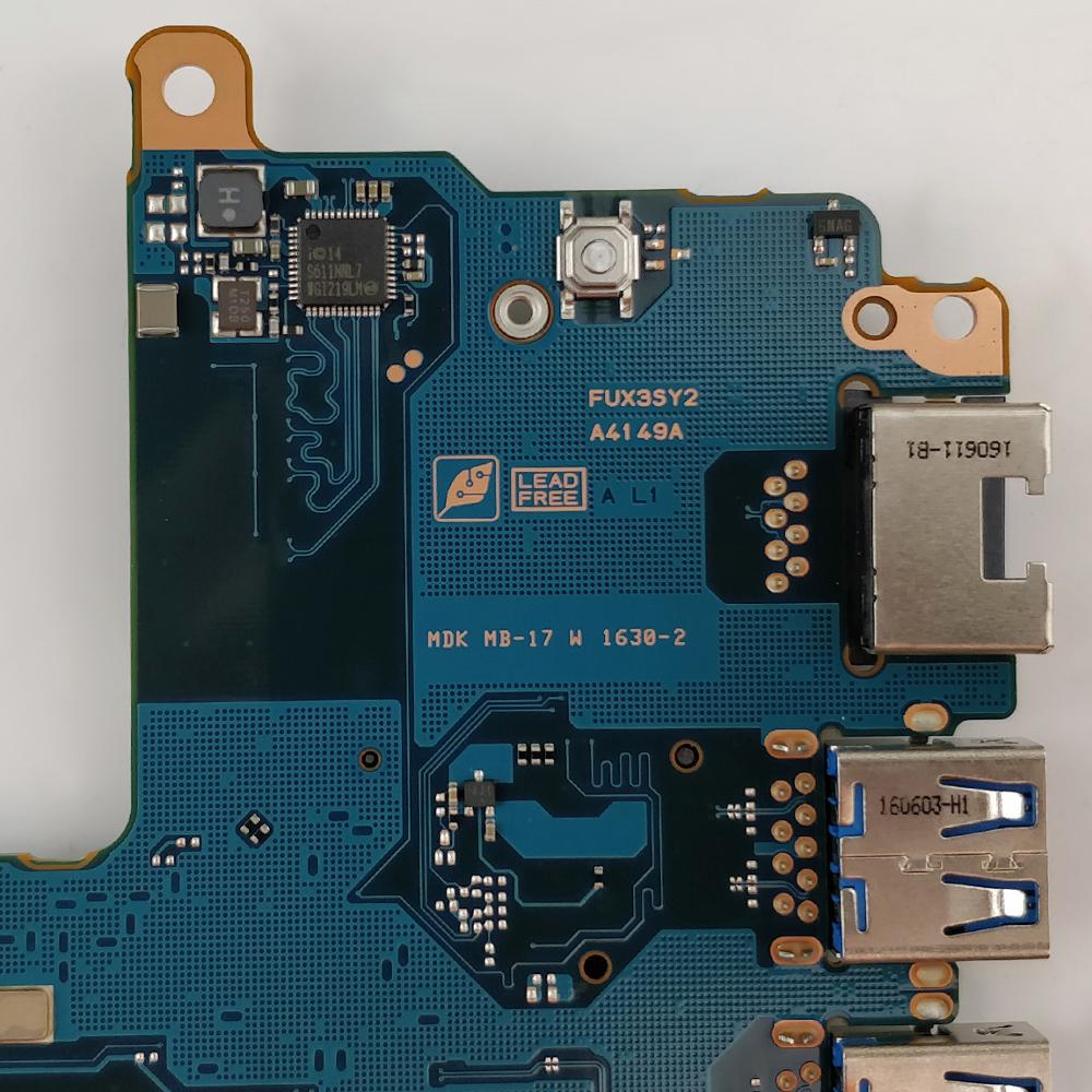

    I have Toshiba Z30-C1320 notebook with FUX3SY2 mainboard.
    I can't find bios dump without password anywhere. If someone can help, it will be highly appreciated.
    I have password protected (probably) bios dump from my mainboard, so if you can help to clean up it from udmp, please let me know and I will publish this dump
    Please, do not upload dumps from other Z30 modifications because they're not compatible.
    Thanks in advance

    password saved in EC

      Is there a way to remove it?

        Only by challenge response code or soldering a new KBC chip with no pass from a donor board. https://www.badcaps.net/forum/attach...4&d=1614422275
        Post your challenge code and someone might give you the code.This site is for free help only.

          The problem is that I got the laptop without SSD, so it doesn't show any image on the screen while trying to start
