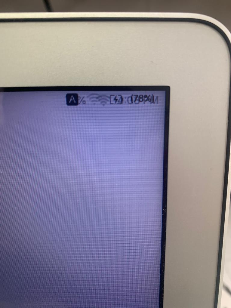

MacBook Air 2017 A1466 EMC 3178 820-00165-A No power
  • ssio187dd
    • Sep 2021
    • 6
    • Deutschland
    Re: MacBook Air 2017 A1466 EMC 3178 820-00165-A No power
    First of all, I had flashed some file that I had found here on the page and after that it did not even turn on, only the orange led shone on the power plug and and when I tried to switch it on, the led went from orange briefly for 2- 3 seconds to green then back to orange but no fan turns and the cpu stays cool. is that actually coming from the wrong biosflash?
    Ps.: vesko your data can i test later at this day i'm at work now
    • piernov
      • Jan 2016
      • 4435
      • France
      Re: MacBook Air 2017 A1466 EMC 3178 820-00165-A No power
      Bad KB/touchpad/touchpad cable
      • 2011dandela
        • Apr 2015
        • 36
        • algeria
        Re: MacBook Air 2017 A1466 EMC 3178 820-00165-A No power
        i want to remorve the efi code please
        • jhomhar08@gmail.com
          • Jul 2018
          • 6
          • philippines
          Re: MacBook Air 2017 A1466 EMC 3178 820-00165-A No power
          Originally posted by peste
          try..
          thanks this file works for 2017 macbook how many files i tried but slow on mac os set up only this one is working big thanks
          • nyknemesis
            • Aug 2012
            • 85
            • romania
            Macbook air 820-00165a
            Can somebody clean this dump please? not powering on, stuck in start loop 300mah draw pulse.
            works with other dumps but no image so maybe someone can fix the original.
            Thanks alot.
            • peste
              • Dec 2016
              • 12748
              • ROMANIA
              Re: Macbook air 820-00165a
              Originally posted by nyknemesis
              Can somebody clean this dump please? not powering on, stuck in start loop 300mah draw pulse.
              works with other dumps but no image so maybe someone can fix the original.
              Thanks alot.
              try..
              • nyknemesis
                • Aug 2012
                • 85
                • romania
                Re: Macbook air 820-00165a
                Originally posted by peste
                try..
                starts and stops 2 times then stays on but no image.....
                • jacospama
                  • Aug 2019
                  • 237
                  • Ghana
                  macbook a1466 emc 3178 clear me
                  clear me this bios (820-00165-a)
                  • hoaca388
                    Badcaps
                    • Jan 2022
                    • 11711
                    #29
                    Re: macbook a1466 emc 3178 clear me
                    Here
                    • jacospama
                      • Aug 2019
                      • 237
                      • Ghana
                      #30
                      Re: macbook a1466 emc 3178 clear me
                      Originally posted by hoaca388
                      Here
                      thank you for the file. but it didnt work. please what must do again?
                      • Instafixx
                        • Jul 2022
                        • 374
                        • India
                        #31
                        A1466 emc 3178, 820-00165-a
                        Need Bios for Macbook Air A1466 EMC3178, 820-00165-A .
                        Kindly help
                        • peste
                          • Dec 2016
                          • 12748
                          • ROMANIA
                          #32
                          Re: A1466 emc 3178, 820-00165-a
                          Originally posted by Instafixx
                          Need Bios for Macbook Air A1466 EMC3178, 820-00165-A .
                          Kindly help
                          post the original bios even if it is corrupted..
                          • Instafixx
                            • Jul 2022
                            • 374
                            • India
                            #33
                            Re: A1466 emc 3178, 820-00165-a
                            Originally posted by peste
                            post the original bios even if it is corrupted..
                            Please find attached
                            • peste
                              • Dec 2016
                              • 12748
                              • ROMANIA
                              #34
                              Re: A1466 emc 3178, 820-00165-a
                              Originally posted by Instafixx
                              Please find attached
                              be careful when writing because the bios you posted is longer...
                              try..
                              • Instafixx
                                • Jul 2022
                                • 374
                                • India
                                #35
                                Re: A1466 emc 3178, 820-00165-a
                                Originally posted by Instafixx
                                Please find attached
                                Getting this problem
                                • peste
                                  • Dec 2016
                                  • 12748
                                  • ROMANIA
                                  #36
                                  Re: A1466 emc 3178, 820-00165-a
                                  Originally posted by Instafixx
                                  Getting this problem
                                  reset PRAM
                                  • Ivandj983
                                    • Dec 2016
                                    • 16
                                    • Pozarevac
                                    #37
                                    A1466 emc3178 efi lock
                                    Hello fiend, please help me need urgent file to unlock and flash the efi chip
                                    • Ivandj983
                                      • Dec 2016
                                      • 16
                                      • Pozarevac
                                      #38
                                      MacBook Air 2015 A1466 EMC 2925 efi lock
                                      and this computer is also efi locked
                                      • peste
                                        • Dec 2016
                                        • 12748
                                        • ROMANIA
                                        #39
                                        Re: A1466 emc3178 efi lock
                                        Originally posted by Ivandj983
                                        Hello fiend, please help me need urgent file to unlock and flash the efi chip
                                        try..
                                        • peste
                                          • Dec 2016
                                          • 12748
                                          • ROMANIA
                                          #40
                                          Re: MacBook Air 2015 A1466 EMC 2925 efi lock
                                          Originally posted by Ivandj983
                                          and this computer is also efi locked
                                          try..
                                          • Sergio Kub
                                            MAcbook Air A1466 EMC 3178 - 2017 Boot
                                            by Sergio Kub
                                            Could someone help me?
                                            I have a Macbook Air A1466 EMC 3178 - 2017, board 820-00165 and sometimes the boot interrupts with an image of a folder and a question mark.
                                            Could it be the BIOS?
                                            07-08-2025, 04:41 PM
                                          • Sergio Kub
                                            Macbook Air A1466 EMC 3178 - 2017 Boot
                                            by Sergio Kub
                                            Could someone help me?
                                            I have a Macbook Air A1466 EMC 3178 - 2017, board 820-00165 and sometimes the boot interrupts with an image of a folder and a question mark.
                                            Could it be the BIOS?
                                            07-08-2025, 04:12 PM
                                          • BMCappelletti
                                            Macbook Air A1466 EMC 3178 missing power and liquid damaged
                                            by BMCappelletti
                                            Hi everyone.
                                            Macbook Air A1466 EMC 3178 (board 820-00165 A) not turning on and no charging light. Completely dead. With no battery connected it would power up and I could hear the chime, but nothing on the screen and then a sudden turn off. Sometimes during the chime. Opened it up and found some liquid damage. The flat that connects both boards has damage in one side (with a missing pin already). The connectors on the boards are fine, though.
                                            Also, there was liquid damage on the included picture area, which are R8111 and C8111. A quick and soft brush on it made the resistor be gone....
                                            04-15-2024, 01:24 PM
                                          • sherifu
                                            Macbook Air A1466 Emc 3178 No light charger after spilling liquid
                                            by sherifu
                                            Hello guys, i have an Macbook Air A1466 Emc 3178, board number 820-00165-A and i encountered following problems. At first no light, no power..after opening and cleaning the LCD socket(Red dot under LCD plug and also Orange dot near wifi card)..got light on charger, fan working and chime...Tried several times and working, then short time after dead...next day work again for short time...after removing the board and cleaning the back(rust on components) with alcohol and soft brush, one of the resistor is gone and no power ..I want to change 5 (buy from China) of them (1 missing and 4 bot looking...
                                            03-26-2024, 04:54 PM
                                          • ACS-Repair
                                            MacBook Air A1466 2017 Operating Very Slow
                                            by ACS-Repair
                                            I'm hoping someone can help me with a 2017 MacBook Air A1466 820-00165 that is running very slow. This is a board that I picked up on ebay recently.
                                            This is not being caused by a sensor issue. All sensors report normal operation and the fans run at normal speed. Geekbench gives me a single core CPU value of 124, when it should be closer to 400. I was unable to complete an install on the SSD without putting it into a different computer first.
                                            The board appears clean with no sign of liquid damage. I have done a PRAM and SMC reset, and I have done a reflow of the SMC. I have inspected...
                                            08-18-2023, 02:30 PM
