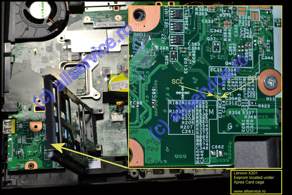

    Need unloked bios Lenovox 201 tablet please

    send old bios let me create patch

      This is my dump with password

          Originally posted by aLEXSTARLING
          Fail is upload!
          The bios can`t be patched.The pass is stored on a small chip . Short SCL and SDA on the chip or by the 2 vias (scratch down to the copper) to clear the pass. https://www.alisaler.com/lenovo-thin...bios-password/
          See post #9 https://www.badcaps.net/forum/showth...ghlight=P24S08
