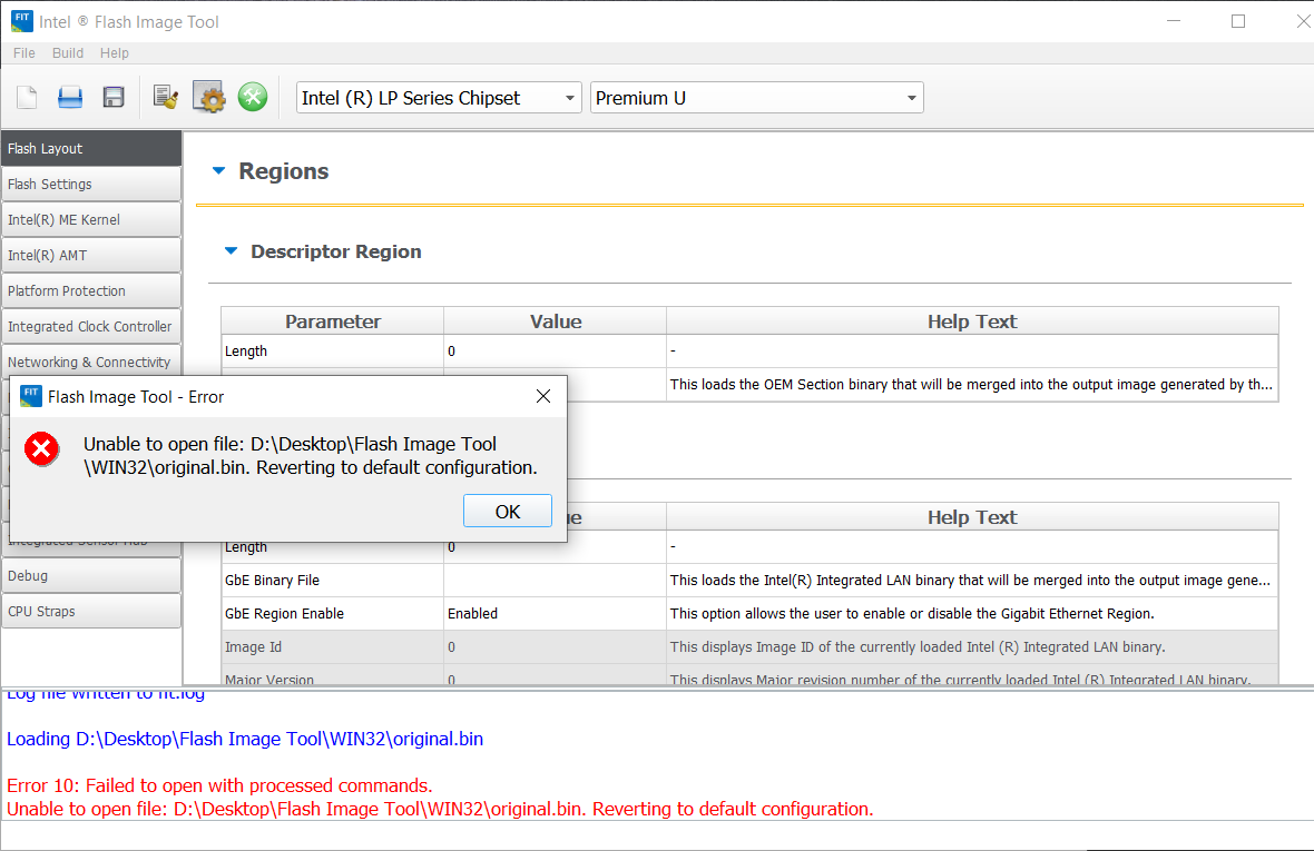

      Furthermore, I tried to clean the ME with the guide you had posted here, but the Flash Image Tool (FIT) complained about the BIOS image:
      Unfortunately, I figured that maybe I don't need to go down this road and ignored the ME cleaning part as I trusted that the BIOS images I found online had clean ME regions.
      Do you know why FIT did not want to open my and your BIOS image? I just couldn't find a more elaborate error message to try to at least debug for myself.
      I would just love to get to the solution by myself as well.

        When you first boot the machine the ME firmware becomes married to the PCH. You should always clean the ME after changing a PCH.You can`t always trust any bios you find online to have clean ME FW even if it says so in the title.The 9.0.14.1402 version is listed on the HP support page under Firmware (4) ,thats what i used,although you can upgrade or downgrade to a different version as long as its 9.0.x.x (not 9.1.x.x in most cases). Whenever you use FIT i find its best to always make a new folder on the desktop,or other working directory and copy FIT,the ME FW and bios into that folder, then delete the folder afterwards. Happy reading at win-raid its a good community over there .

          I did not know that the version of the FIT tool is important as well as the newest version (11) did not work with my BIOS (showed the error message I shared previously). I just assumed that the newest version should work.
          To clean the ME region by myself, I used FIT 9.1.10.1000 and it worked!
