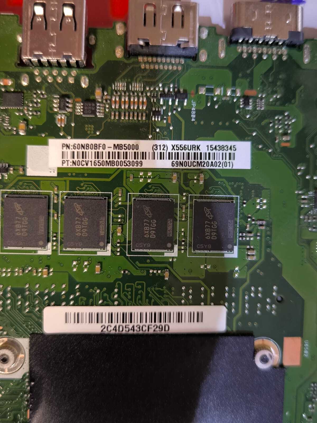

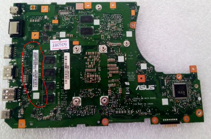

                  NeoProgrammer is good software for the CH341A,so you should be ok reading the chip if you`ve desoldered it and not using a clip.If youve desoldered it then youve tried your best and the bios must be reall badly corrupted. Can you post a picture of the barcode sticker next to the soldered ram, it should have a model number on it.We check that model on the sticker to see if X556URK is the right bios or not
                  • Wellcome
                    • Jul 2019
                    • 36
                    • Italia
                    this is the Motherboard
                      • 22077
                      Try this bios
                      • Wellcome
                        • Jul 2019
                        • 36
                        • Italia
                        it works! thanks a lot, sorry for previous troubles
