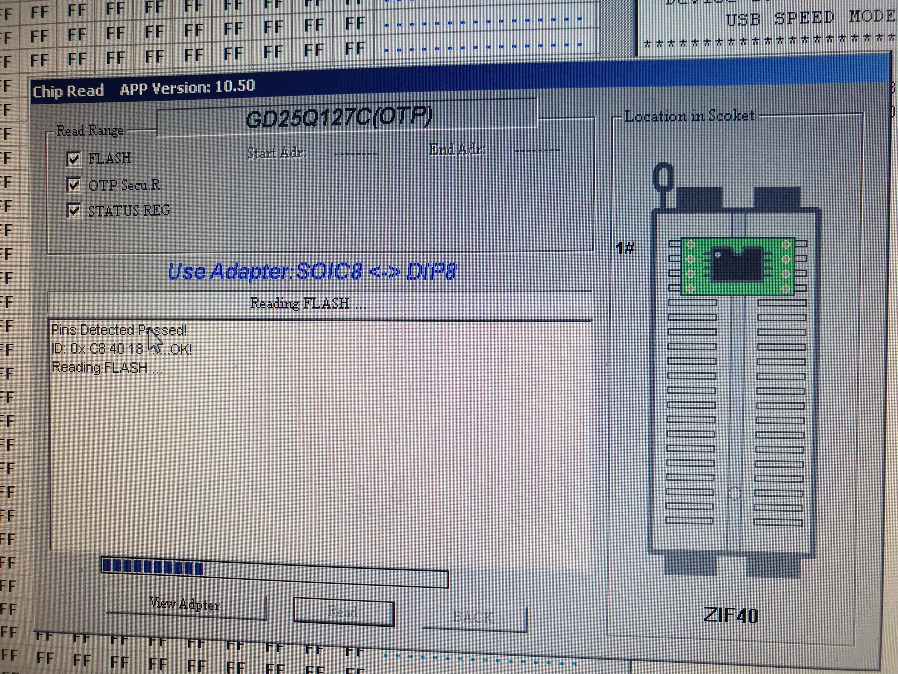

    i have an ASUS X412F laptop with a password request when starting the laptop.
    i dumped the BIOS (i have a TL866II PLUS) but the eeprom is an 25B127DSIG that is not (i think) supported by this programmer... (it suggest GD25Q127C or GD25Q128B)
    not sure that the dump is a right one and i can't try to reflash another clean image beause the recognized eeprom is not the right one.
    any suggestion?
    this is the dump: (reading it using the GD25Q127C preset)

    the posted bios is longer ... remove the bios chip from the motherboard before writing or reading ... if you use the clip you may have errors..use for writing GD25Q127C ... try the bios ...

      the eeprom was removed i also noticed the wrong length... this is maybe because is not correctly recognized by the programmer?

        this is screen of programmer.. tested again and the lenght of the produced dump is always: 16.780.288

          Try it as GD25Q128

            do not use (OTP) ..

              Ok thank you guys!

                guys just received the new 128mbit eproms and the Orig+X412FAAS.rar works fine....
