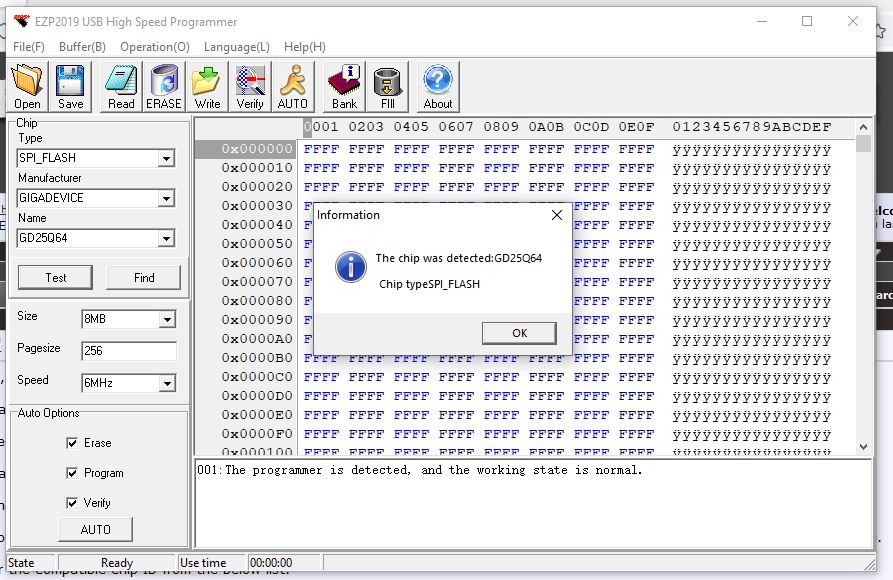

    I am new here.
    Need your help with similar situation.
    I am using EZP2019+ programmer.
    The bios chip is 25B64CSIG, assume the manufacturer is Gigadevice since the "CSIG" type keywords come after their produces.
    However in the EZP2019+ this is not listed under their brand. How can I add the missing chip in it's library. could someone please help.
    Or the compatible chip ID from the below list.
    https://www.hklrf.com/24download/img/EZP2019-List.txt
  • mcplslg123
    • Jun 2015
    • 7262
    • india
    Re: Bios Chip 25B64CSIG and EZP2019+ help request
    select GD25Q64 and its likely to work. If your chip is 1.8V, then select GD25Q64(L)
      I have the same BIOS chip , i used Neo programmer suggested by a senior member
      https://www.badcaps.net/forum/showth...Programmerchip.
      Neo Programmer will easily choose your correct and single IC marking.Neo Programmer has 25B64CS1G IC in it's list.
      No need to choose another just try Neo Programmer and it will work
      It is not helpfull to use clip adapter instead remove chip from motherboard and use SOC adapter to reflash the chip
            EZP2019+ can detect 25B64CSIG
