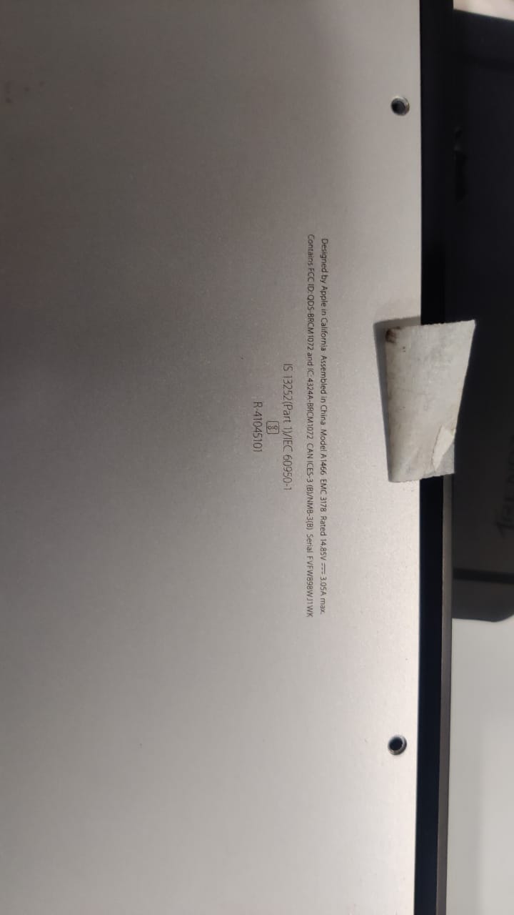

    i was have a password in macbook air
    Model A1466
    Emc 3178
    than i got unlock bios from different macbook air & i Flash With That Bios
    after flash bios password is unlock
    After That i change serial number and correct checksum also
    now the problem is only bootup is very slow
    i try to clean ME but still same.....very slow
    what is the possible reason causing macbook very slow

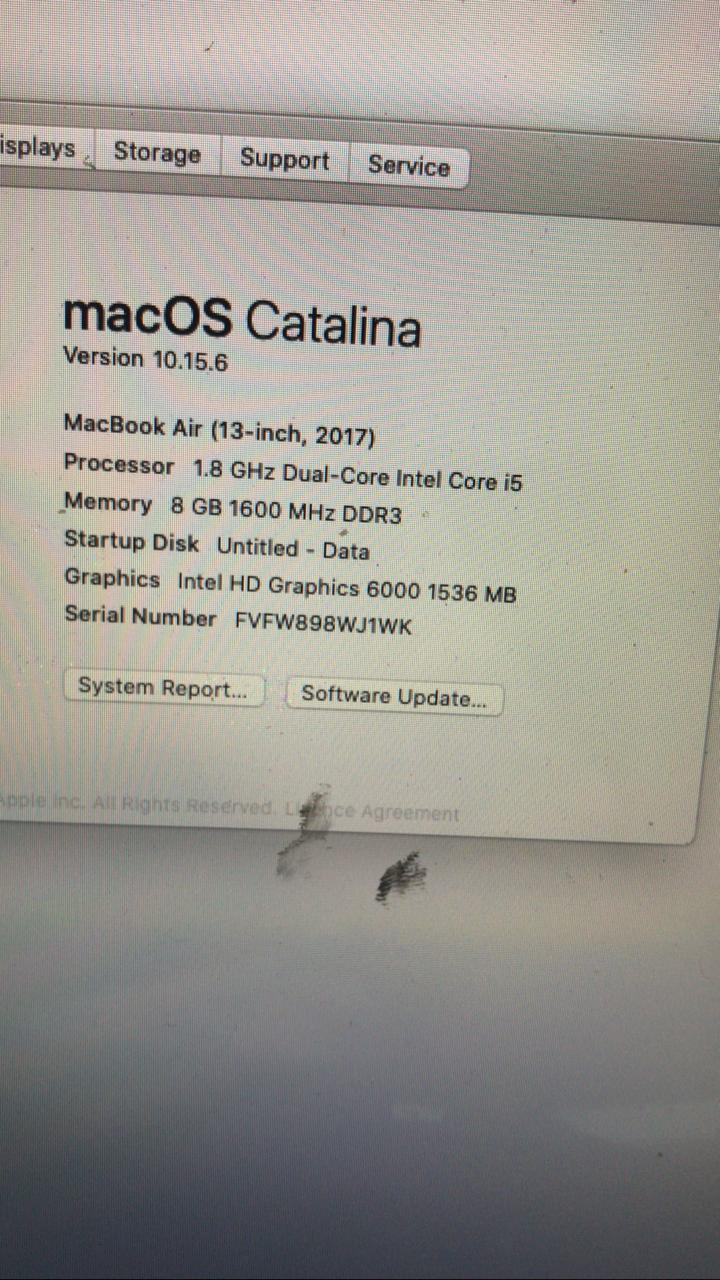

      Re: MacBook Air Very Slow After Flashing Bios
      Thanks Sir SMDFlea........ Ok So this bios is UNLOCKED & from different macbook with different serial number
      i want change serial number with this The Given Below
      NEW SERIAL NUMBER:- FVFW898WJ1WK
      And Want To Fix Slow Bootup
