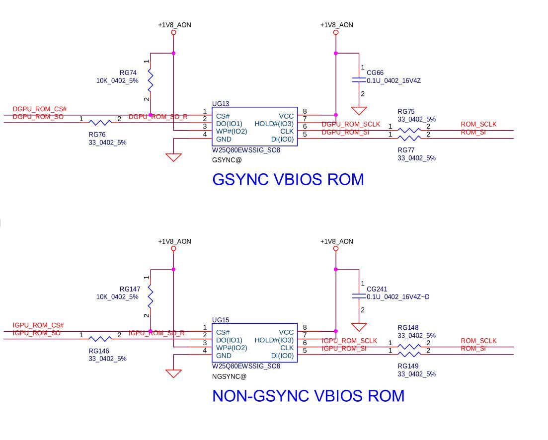

                                    It looks as if the BIOS is working, but I'm getting a CPU error with the flashing codes. (2 red, 1 blue)
                                    tried two other clean BIOS files, flashing both the 1 MB and 8 MB ones, but the service code doesn't fit and the device starts up. I was able to enter the BIOS normally.
                                    However, the keyboard, the logo under the screen, etc. do not work with the other files. With your clean BIOS files from my original file, everything works fine and it works until the flashing error occurs.
                                    Is there anything else that can be changed in the clean files with regard to CPU detection?
                                    • smartonaut
                                      • Nov 2025
                                      • 8
                                      • Deutschland
                                      So the BIOS consists of 2 chips, 1 MB and 8 MB.
                                      I think the second one also needs to be adjusted so that it works correctly.
                                      I'll upload the 1 MB version that I read out here as well.
                                      You've already adjusted UH4, so maybe you can do the same with UG13.
                                        • 22424
                                        UG13 and/or UG15 is the vBios firmware, for Gsync and non Gsync. There wasn`t much code in your backup. The chip is 1.8V ,you need to use a 1.8V adapter. Anyway, they are probably not needed. The error you`re seeing is due to charger detection. Are you using a genuine dell charger and is it the correct wattage ? .If it`s the right charger then there is a hardware issue on the motherboard with charger ID detection. When the correct charger can`t be determined the cpu will run at a slow speed.
