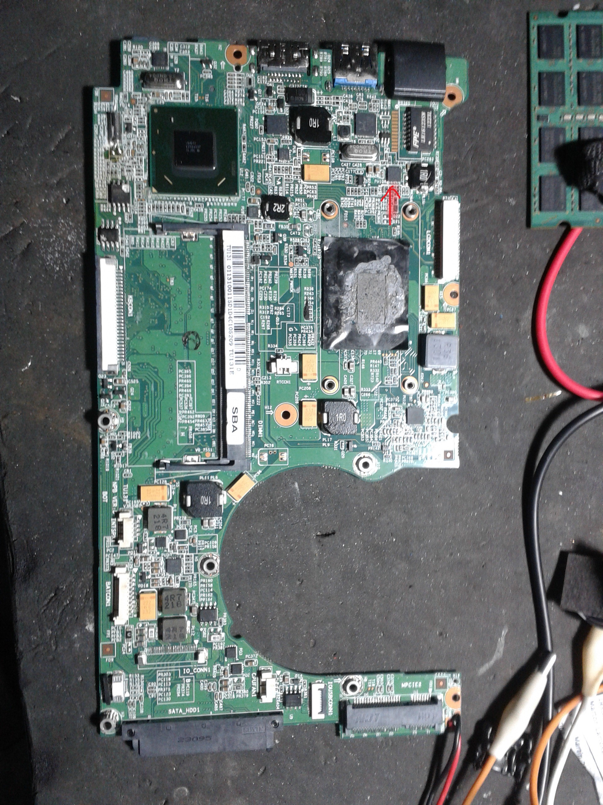

    All voltages fine, Main-PWROK signal goes high. If the board has no RAM, power turns on and stays on, but if a working RAM is in the socket, it cycles on and off constantly, with no picture on screen at all. CMOS battery is OK.
    Could this symptom be a bad BIOS? Can somebody help with a BIOS dump to try?
    I know this might be hard because this is a Brazil / Argentina model, but maybe one of the gurus around here has it. A schematic does not even exist for this
    Thanks in advance!

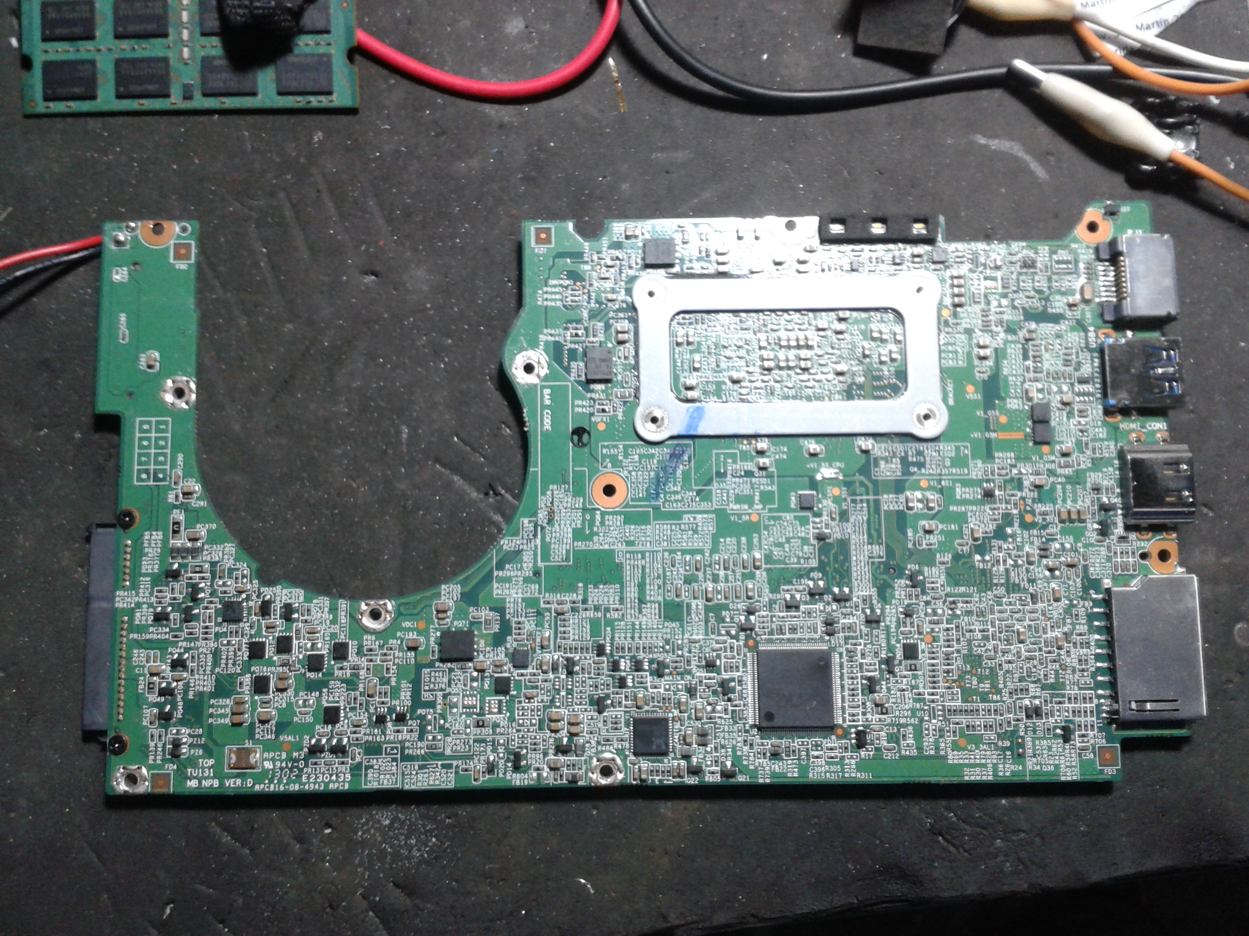

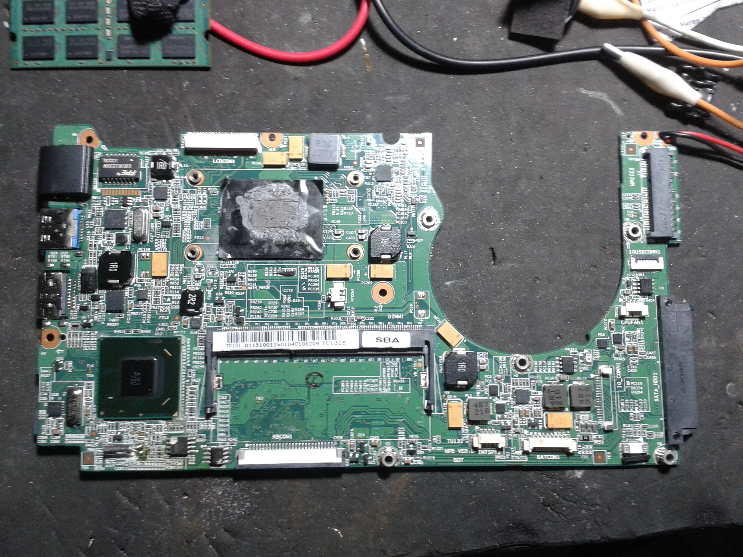

        BTW I dumped the original BIOS (attached, don't know if it is OK or not), and I'm also attaching pics of the mobo.

              Oh I see, thanks for the cleaning. Anyway, I guess the dumps I got are OK, as after more diagnosing I found that VGFX is actually missing, and even without that voltage Main-PWROK goes high, so this signal is not monitoring all voltages actually as I thought.
              Now I need to find why it is missing, on pg 43 of the schematic I see it is coming out of the ISL95837 power driver IC, which also handles VCORE. But VCORE is fine, so I don't know if this chip may be the culprit and be "partially" dead.
              • PinGuy
                • Oct 2016
                • 74
                • Argentina
                Re: CCE UltraThin S23 / Bangho Zero 1309 + 1310 - Mobo: TU131 NPB Ver
                Ok, goes to trash. uP's gfx is shorted
                A very crappy board this is.
