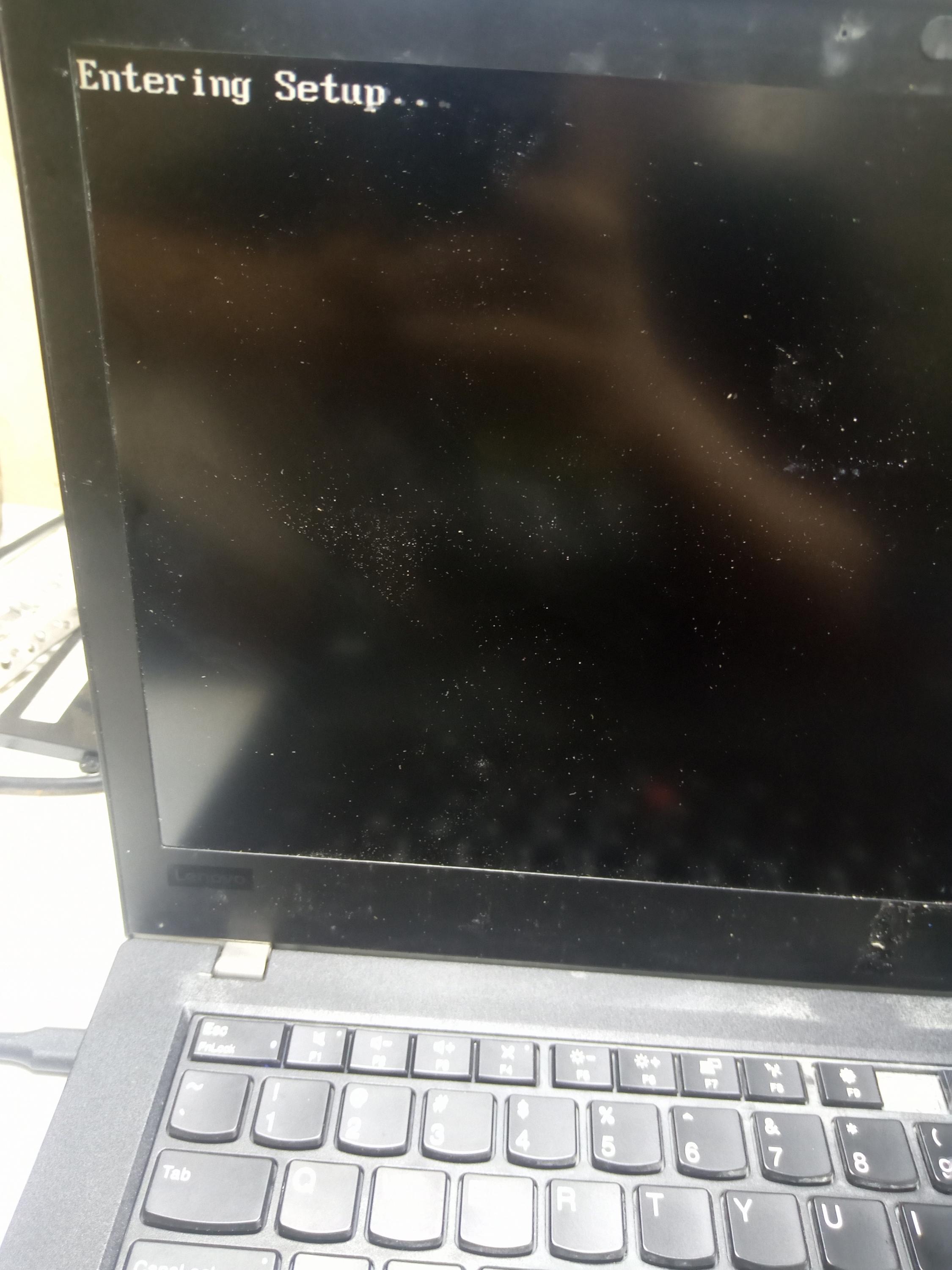

        thinkpad t480s need help to unlock supervisor password,,thankyou

            #1505
            Re: LENOVO BIOS AUTO-PATCHER for Supervisor Password Removal
            Originally posted by Markus1741
            Try this ... Good luck ...
            Thank you, I'm trying, but it stops entering setup
