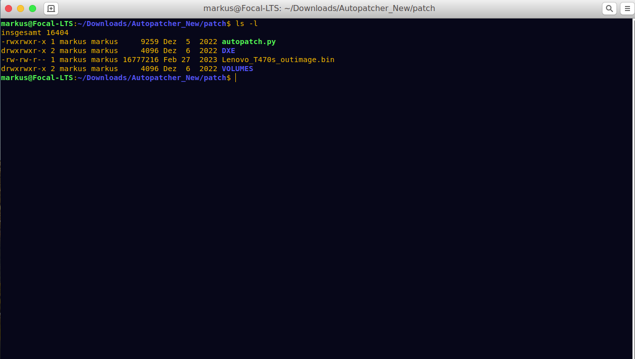

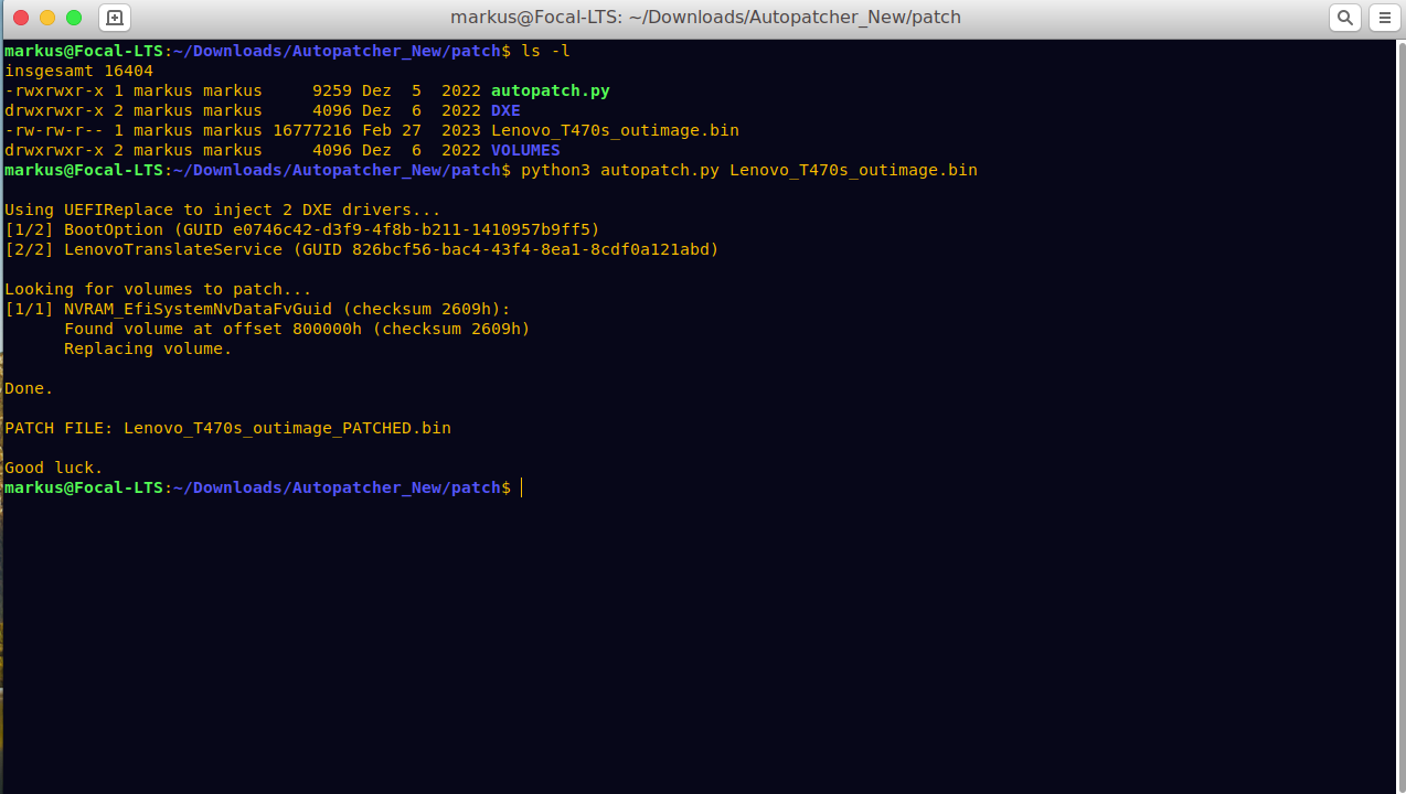

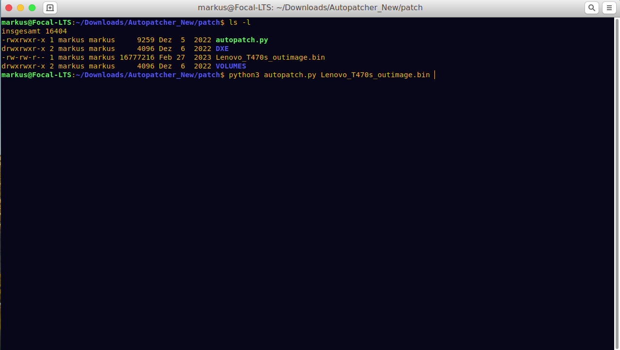

          Two things are very important.
          1. After downloading the script, it is important in Linux that autopatch.py can be executed.
          chmod +x autopatch.py
          2. Also very important is a good backup from the original BIOS as haoca388 says.
          You should be particularly careful that no resistor or capacitor is damaged during reading.
          See image 4 as an example
          This happens more and more often with newer models due to their compact design.
          It is better to de solder the chip and not use a clip.

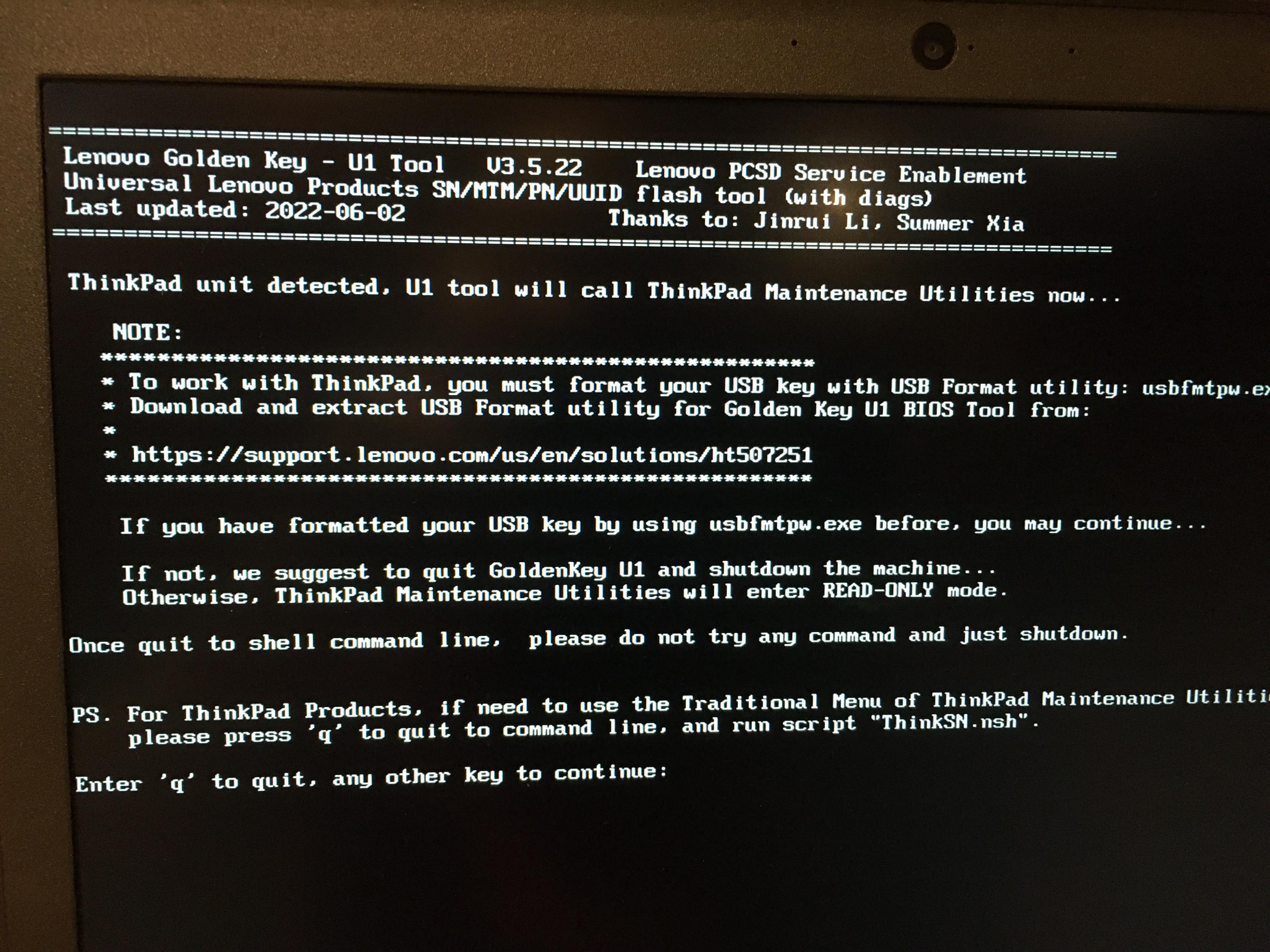

              Hello i found this in the Internet ...
              Lenovo Golden Key - U1 Tool V1.18
              https://github.com/HackerajOfficial/Lenovo-U1-Tool

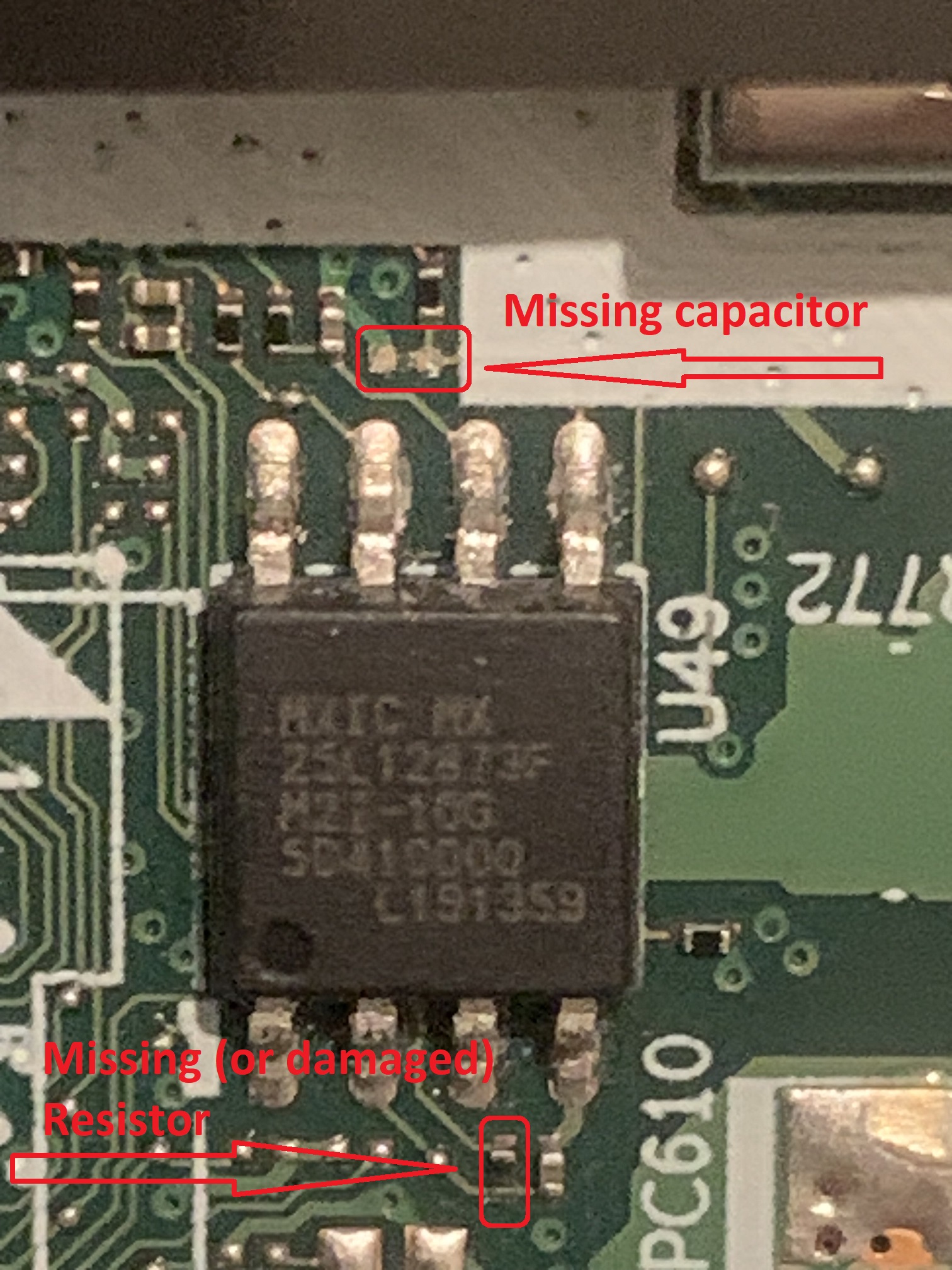

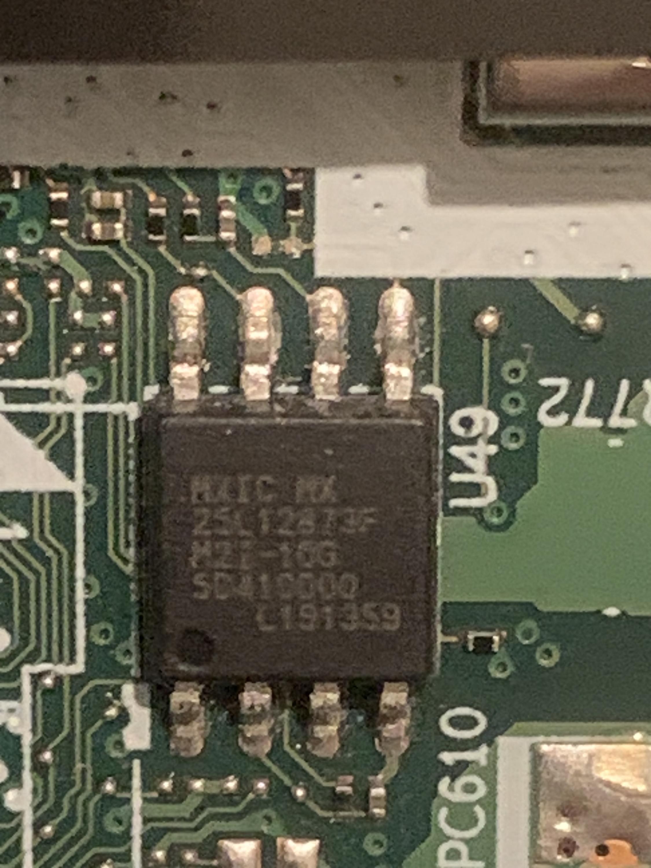

                            Hi, I tried this yesterday with the ch431a, followed everything to the letter and everything worked up until reprogramming the bios with the original bin file. It programmed and verified ok but my laptop won't turn on now. Not sure why this is. I am a noob at this stuff so I don't want to do anything else without some advice. I have a Lenovo Thinkpad t480 if anyone can help I would be eternally greatfull. Many thanks in advance.
                            • Markus1741

                              Hello make a picture from your BIOS chip ....

                                Re: LENOVO BIOS AUTO-PATCHER for Supervisor Password Removal
                                Image is available here as I don't know how to upload sorry. https://*******/pQ0QfgH

                                    Thank you for that, I had not even noticed I’m not sure how that happened unless I was a little to rough with the chip clamp, I will need to find out what they are and how to source them if I can’t find a donor board online. Thank you for your help Vesko356.
                                      Originally posted by Kugaman2021
                                      Thank you for that, I had not even noticed I'm not sure how that happened unless I was a little to rough with the chip clamp, I will need to find out what they are and how to source them if I can't find a donor board online. Thank you for your help Vesko356.
                                      You're welcome.
                                      No need to buy a donor board for that, according to the schematic the capacitor is 33P_0201_25V and the resistor is 33_0201_5%, you can source both easily.

                                        #2819
                                        Originally posted by Vesko356
                                        You're welcome.
                                        I will look into them this evening, thank you again your a fountain of information. Again I really appreciate your help.
