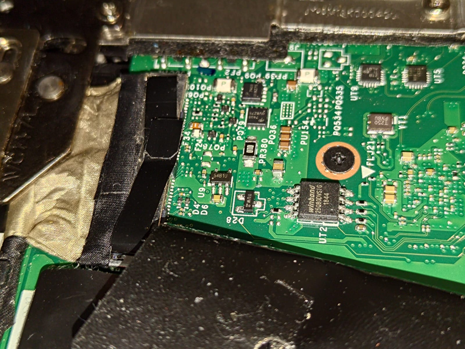

    i have two winbonds on my X380 Yoga:
    1 - winbond 25q80dvsig 1844
    2 - winbond 25q128jvsq 1844
    thanx in advance ^_^

      25q128

                  Worked perfect for our Lenovo ThinkPad T480s and its MX25L12873F chip [1], flashed from a Raspberry Pi with a simple SOIC-8 clip from ebay ☺️ Thank you very much for this great tool!
                  [1] T480s has a second chip, a Winbond 25Q80DVSIG, so make sure to read/write the right chip!
