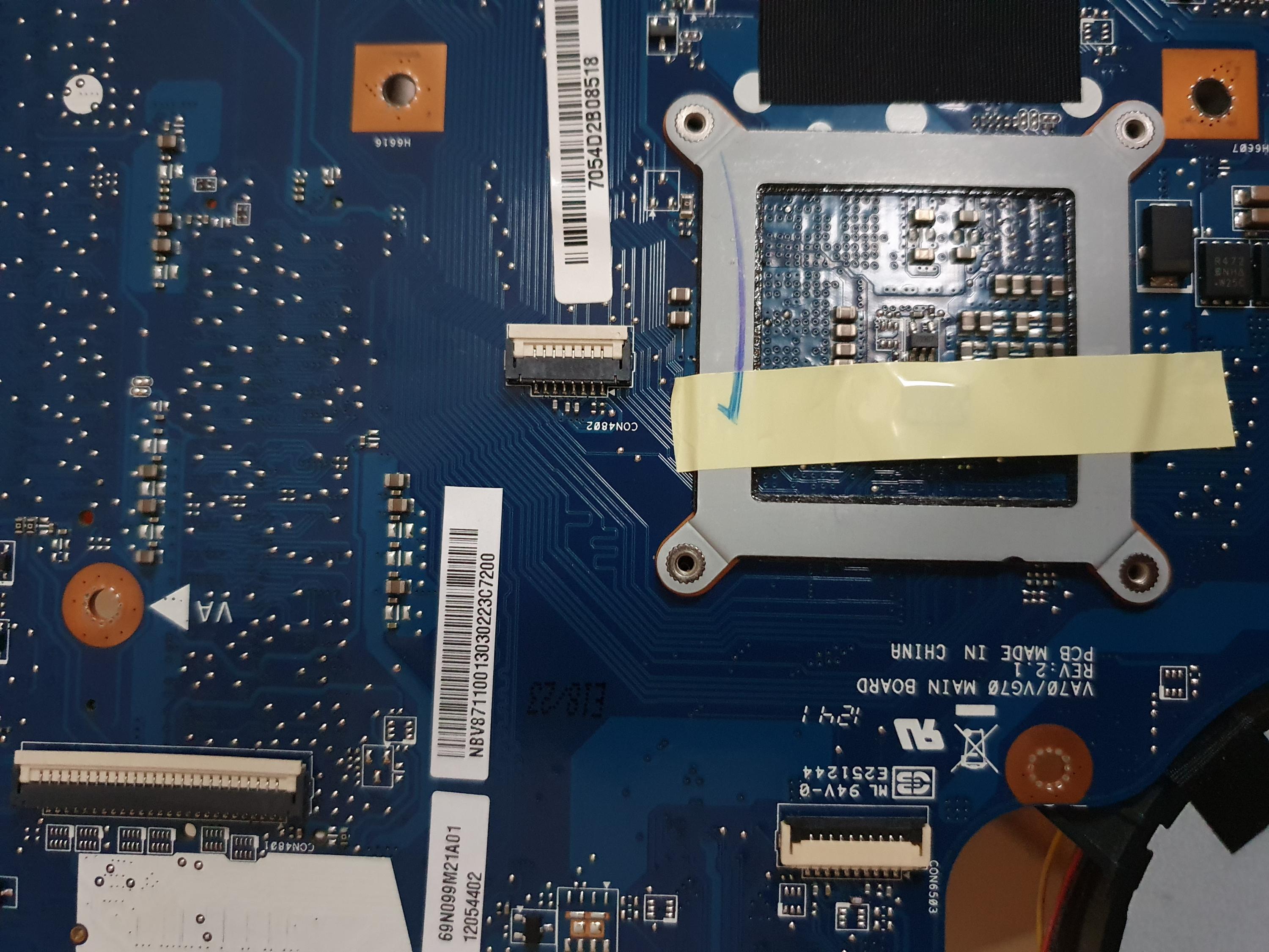

            • fyzeler
              • Aug 2020
              • 26
              • Holland
              Re: Acer TravelMate P273-m bios
              I'm not sure which one is the serial number.
              Not using a clip, because the dumped bios makes no sense? Maybe the flashing went wrong and it's like that to begin with when I went from 2.03 to 2.11
              • fyzeler
                • Aug 2020
                • 26
                • Holland
                here is a picture of the numbers.
