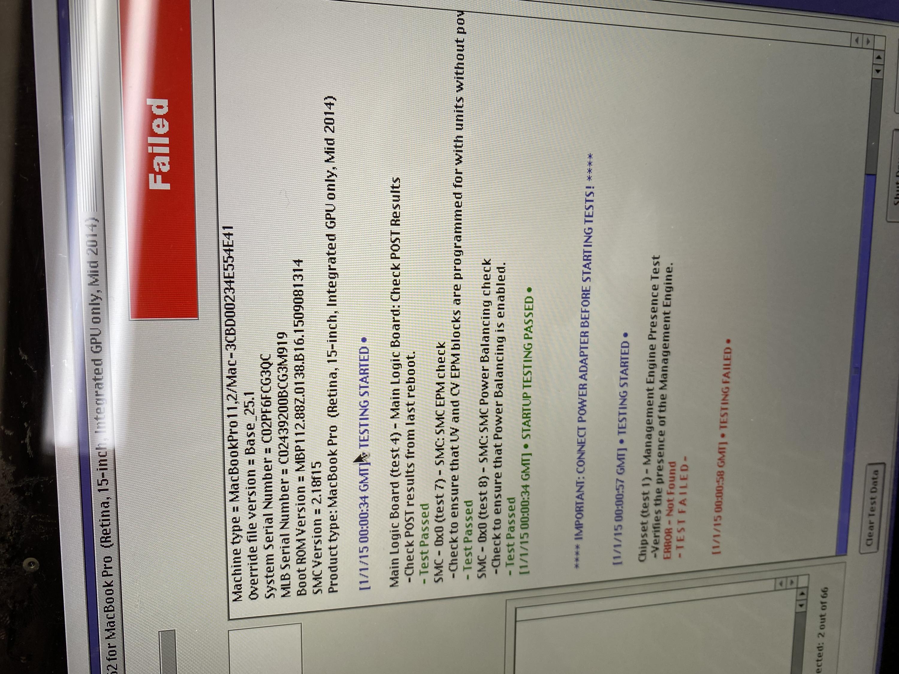

                            2014 A1398 Need BIOS with ME help
                            Hello. I have 2014 A1398 2.2/16. Original BIOS destroyed by liquid. Tried cleaning ME region of replacement and tried EFI found here and simply cannot get ME to restore.
                            ASD keeps failing for ME not found. Cannot boot, stuck on full load bar and logo in best scenario. Help pls ?

                              Whats the EMC and board number 820- ?
                              • irnard
                                • Jun 2017
                                • 7
                                Re: 2014 A1398 Need BIOS with ME help
                                It’s a 820-3662-A. EMC 2876. Serial number is also on attached picture above if needed
