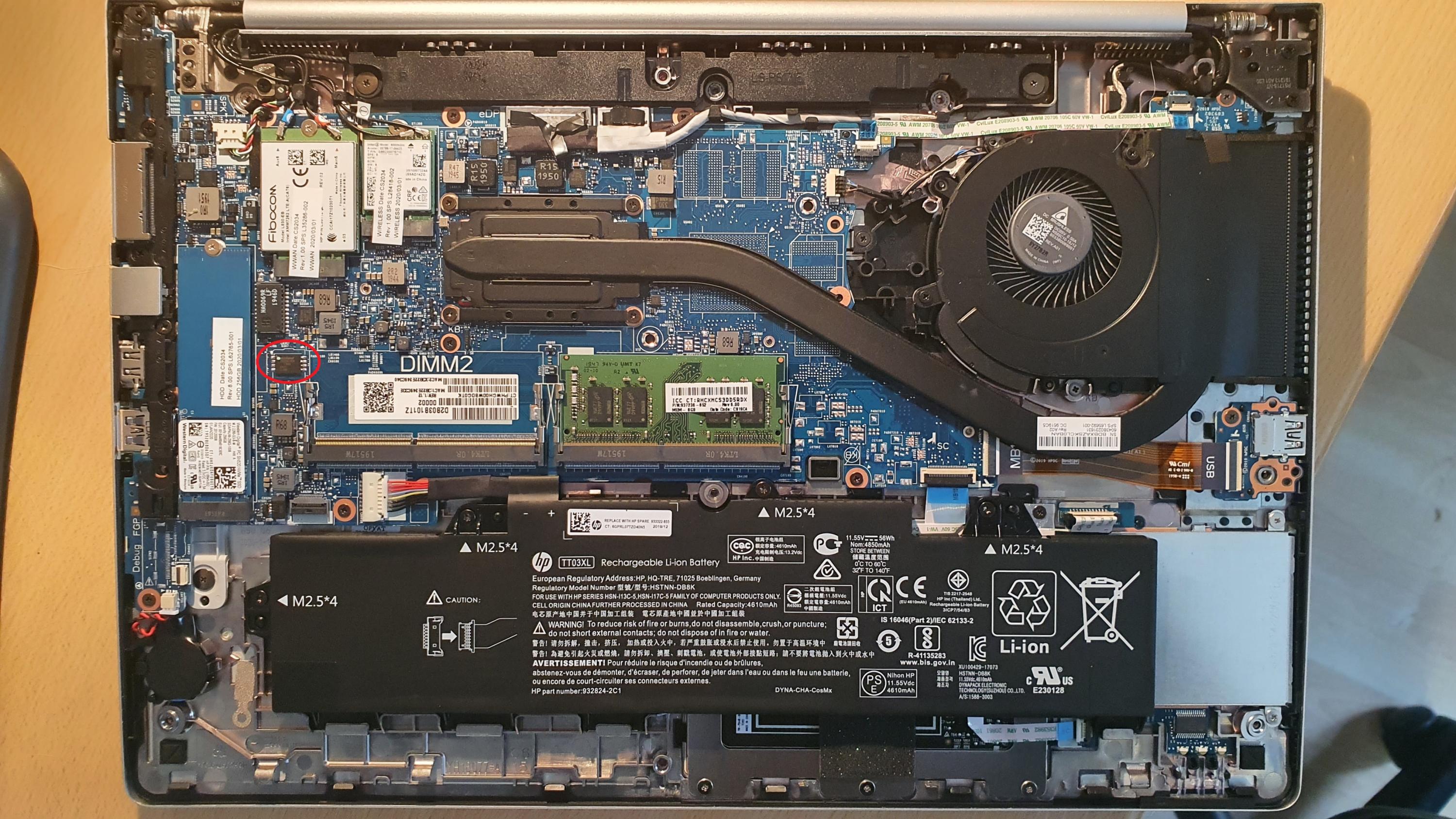

    Hi, I am trying to remove the bios admin password of a HP elitebook 850 G6.
    I have a pomona clip for programming the bios.
    Is this the right bios chip? see red circle in the photo.

    Re: HP elitebook 850 G6 bios chip
    yes
      Thanks.
      It is a winbond 25Q256JVEN
      Which programmer would you recommend with this?
              I managed to read the bios chip with my raspberry pi and flashrom.
              To be sure the reading was ok, I read the chip 3 times, all files were the same and the size was 32 MB.
              Then I used HP Unlocker to remove the password and I wrote the file to the bios chip.
              So far so good, the laptop boots.
              When I use esc to enter the bios during startup, I no longer get the screen where the administrator password is asked, and it even lets me boot from usb etc.
              But in the bios menu, when I choose the menu "enter bios setup", I get asked for the administrator password again.
              Are there multiple administrator passwords set?
              How to remove all of them?
              I attached the original bios as well as the file which HP Unlocker created.
              Could somebody help me out?
                    Great! Thanks =)
                    I'll try as soon as I receive my CH341A reader.
                    It seems there's 2 bios chips on the 850G6, one 32MB (the one on your picture) and an other one of 16Mb at the back.
                    To fully remove the password it seems you need to unlock the 16mb chip
