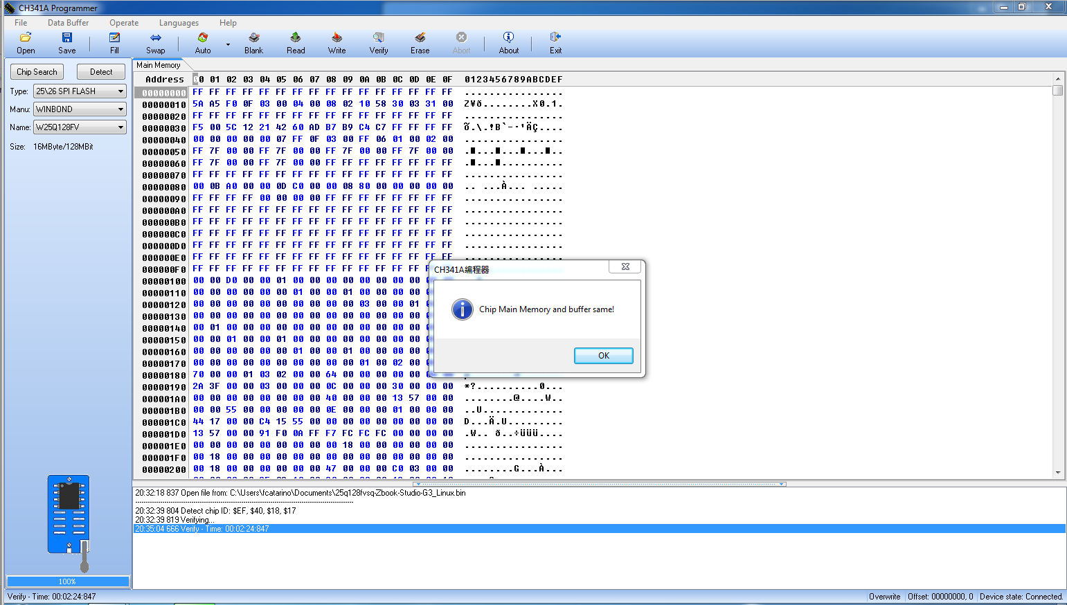

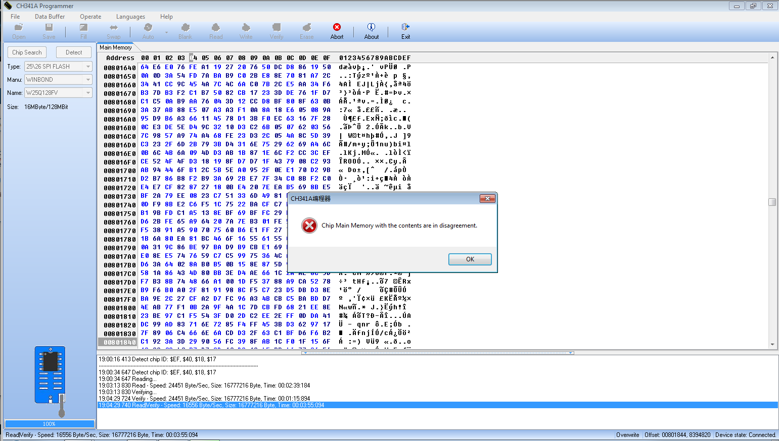

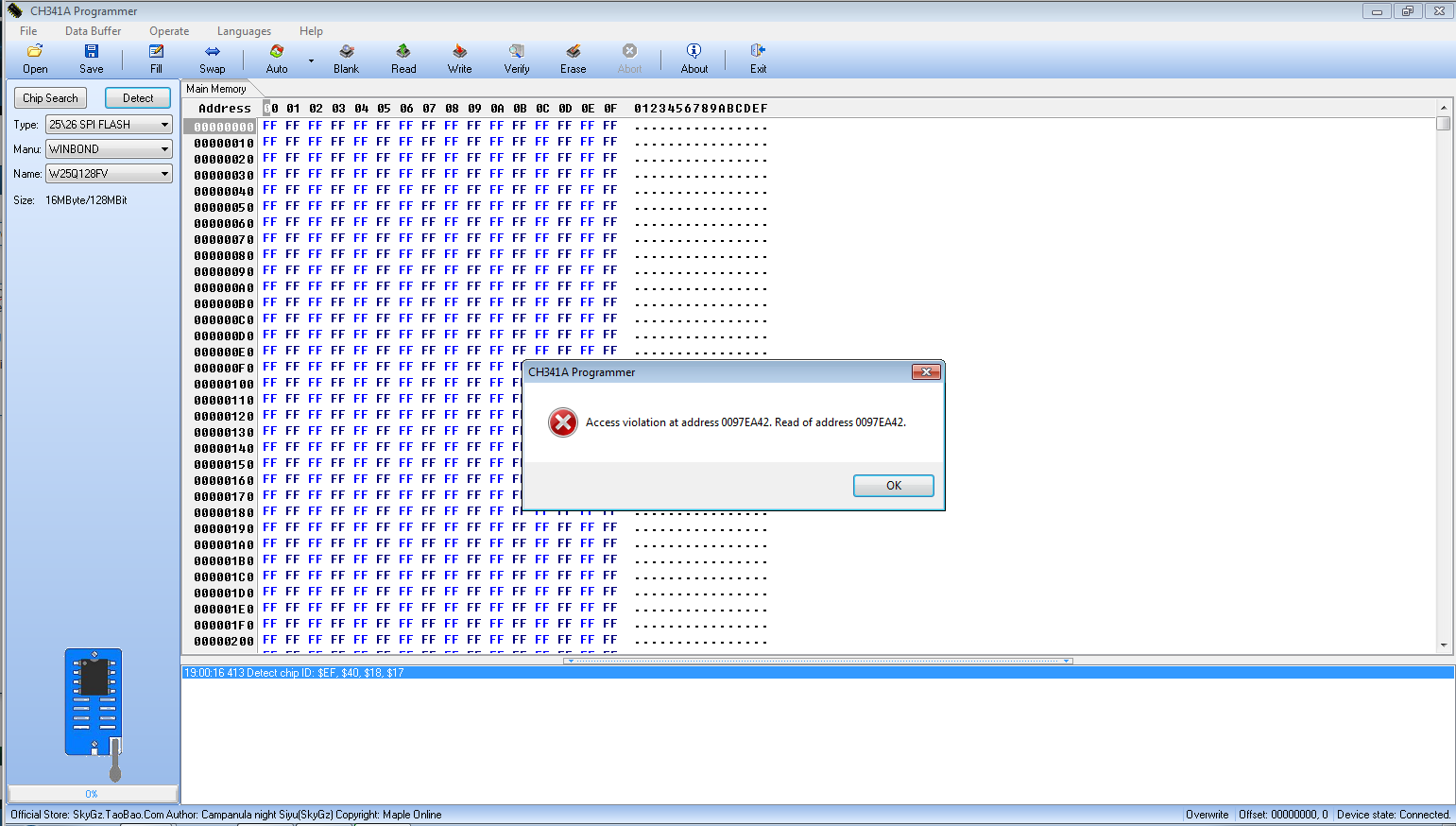

    Hi Guys i have a HP Zbook Studio G3 with PowerOn BIOS Password and cannot remove it that have a BIOS CHIP 25q128fvsq i use a ch341a to read the chip and take a Backup of that with ch341A Programmer 1.29 (Selection_999(773).png image), read the content OK but if use the Verify button send a message that Don't Match
    With with ch341A Programmer 1.30 the same message, of mismatch in the verify (Selection_999(776).png image)
    The Full MB data are: HP ZBook Studio G3 Mobile Workstation LA-C401P APW5U Rev: 1A
    That is a normal situation or in effect the Reading are Wrong?
    Some on can help me to know what need to modify from the Bin file or if exist another method to do it?
    The Backups are in the rar files attached, are Winrar 5 version of the Files
    as comment the Verification failure dont make sense for me so i run it again over Linux OS and now see

    and make the Verification
    Backups]$ sudo flashrom --programmer ch341a_spi -v 25q128fvsq-Zbook-Studio-G3_Linux.bin
    flashrom v1.0 on Linux 5.1.16-200.fc29.x86_64 (x86_64)
    flashrom is free software, get the source code at https://flashrom.org
    Using clock_gettime for delay loops (clk_id: 1, resolution: 1ns).
    Found Winbond flash chip "W25Q128.V" (16384 kB, SPI) on ch341a_spi.
    Verifying flash... VERIFIED.
    Backups]$
    So now i have a message o Verified as i'm expect
    the other binary shows failed
    Backups]$ sudo flashrom --programmer ch341a_spi -v '25q128fvsq-Zbook-Studio-G3_(ch341A Programmer 1.30).bin'
    Verifying flash... FAILED at 0x00801844! Expected=0x29, Found=0x28, failed byte count from 0x00000000-0x00ffffff: 0x1e1ef4
    [fcatarino@SparkyII Backups]$ sudo flashrom --programmer ch341a_spi -v '25q128fvsq-Zbook-Studio-G3_(ch341A Programmer 1.29).bin'
    Verifying flash... FAILED at 0x008008e8! Expected=0xcb, Found=0x0b, failed byte count from 0x00000000-0x00ffffff: 0x210c24
    Backups]$
