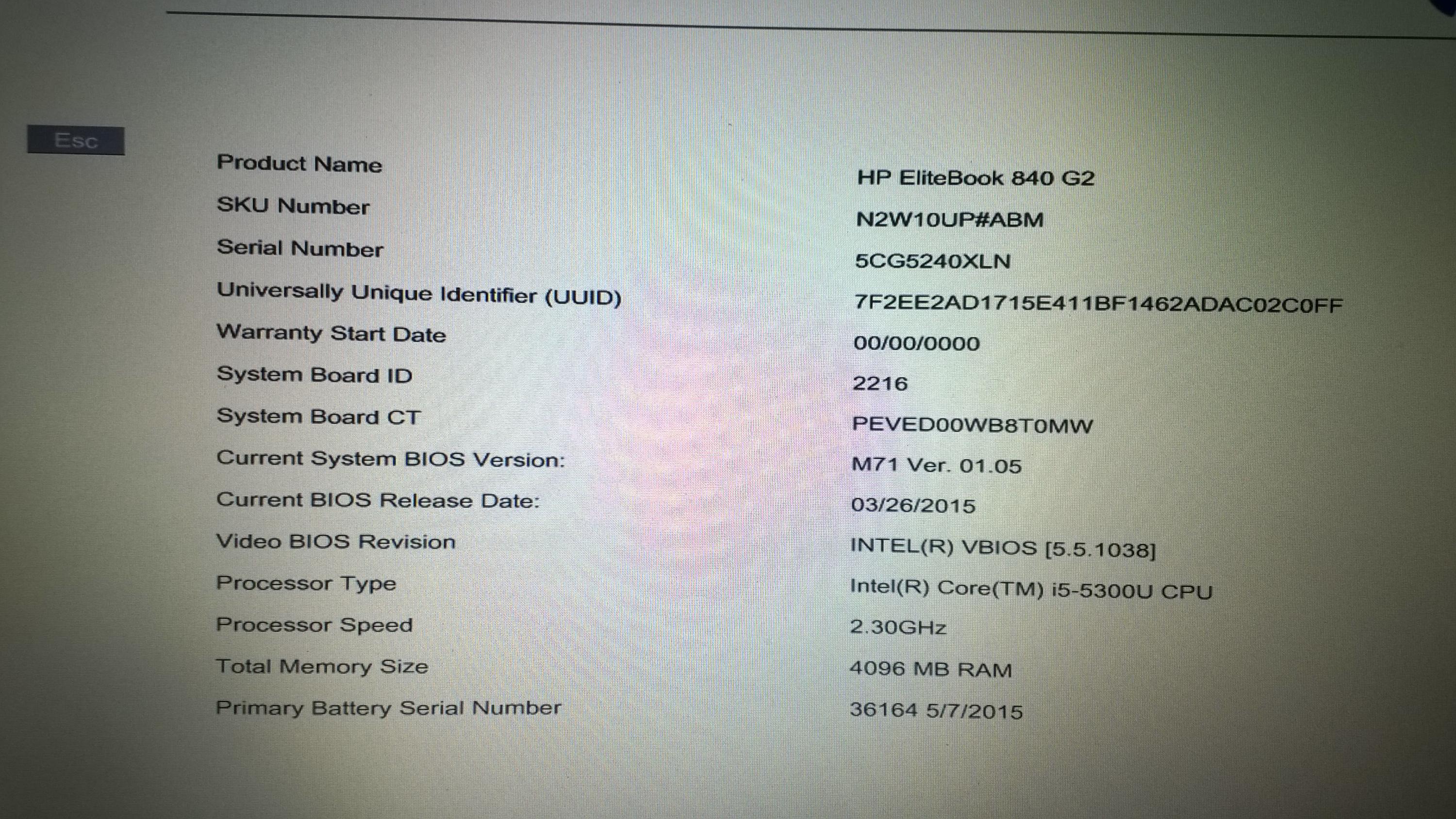

    HEllo, how are you . I have a Hp Elitebook 820 G2 laptop in service, the problem is that it turns on but does not give a display and the FAn is surrounded very quickly. Main Bios, I think it's broken because the programmer doesn't know me, What Bios can I replace it with ??? and I need a clean bios plzzz

    in RAr is photo of bios broken

            turn on laptop stay light for 2 min and restart this and not display .. with the first bios
              • 22279
              Re: Need Bios for EliteBook 820 G2
              Your photo is a bios from an 840 G2. Can you post a photo of the sticker/s inside the battery compartment with model number,serial etc .

                this photo is wrong

                  I confused it with the bios photo

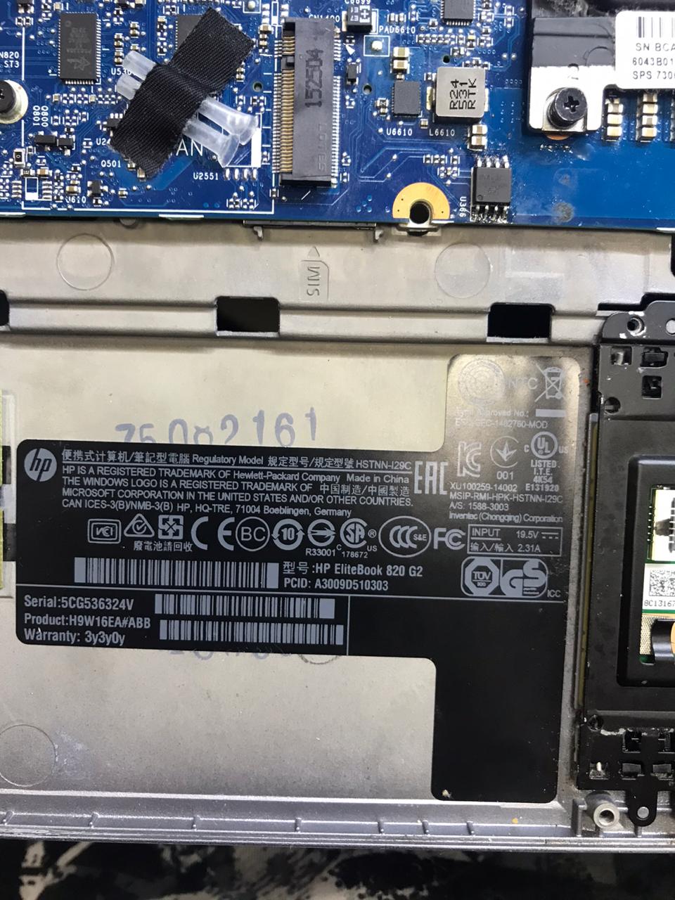

                      press help plzz

                          yesi try but its same problem with the first bios .. and this file upload now not work , turn on but the fan spining fast
                            • 22279
                            Bios .

                              its work thanks
