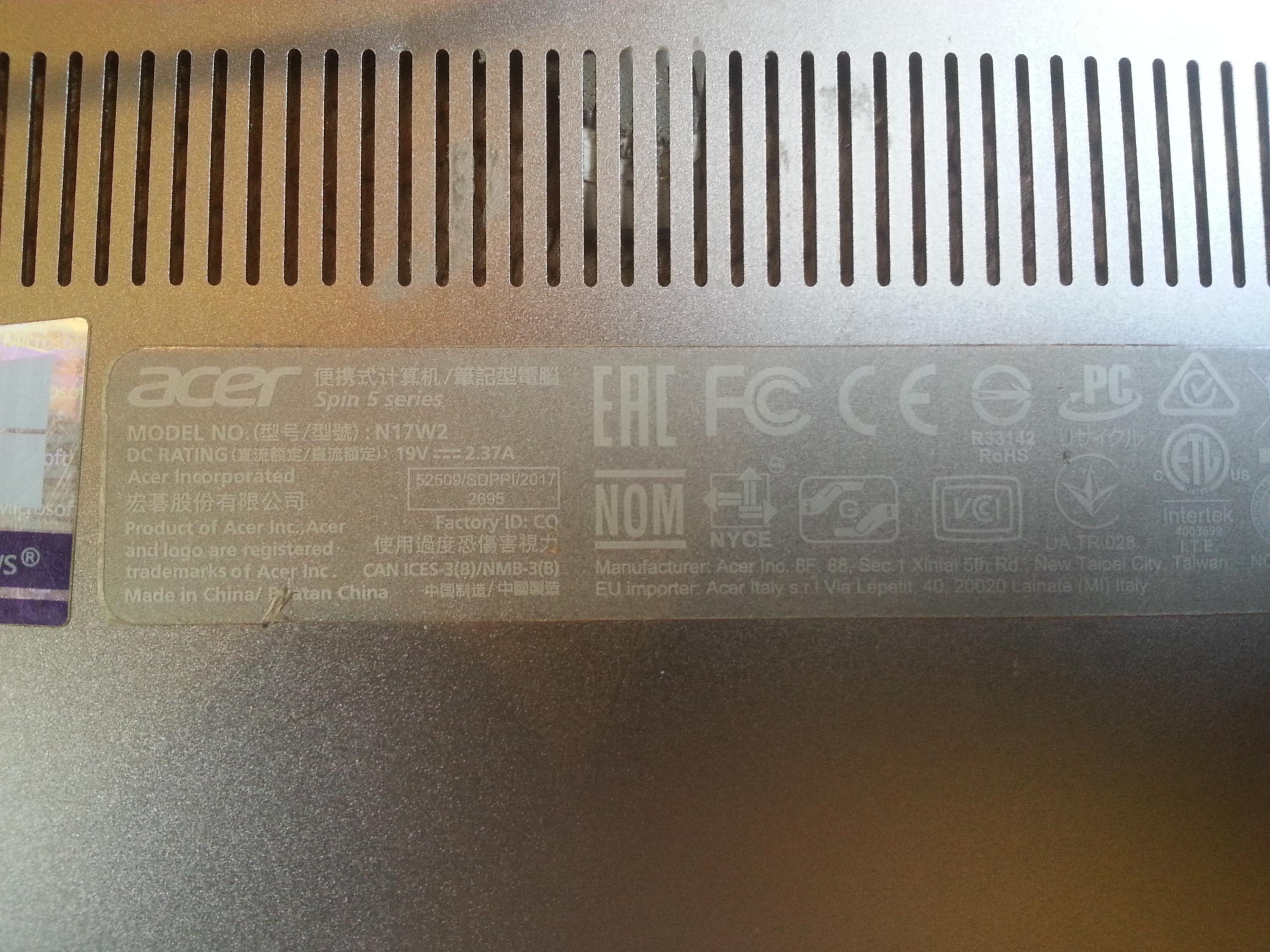

                The bios is from a SP513-53N .Whats the history of the board,and can you post a photo of the label on the base cover.

                  I don't know much about the history of the laptop. It was brought to me only with a note saying "Turns ON, no display". I have attached the back cover photo, I can't find the serial number.

                    Are there any other stickers on the motherboard. The bios you posted is from an SP513-53N (53N) ,its a 16MB bios.The Acer N17W2 SP513-52N-552K (52N) in your thread title has an 8MB bios. You could have the wrong bios chip ? Try an 8MB bios chip with the bios posted by @Claudiomfa

                      No one seems to have touched the Bios chip, could I please have the SP513-53N bios. The SP513-52N, I got from Googling "N17W2"...I could be using the wrong model.
