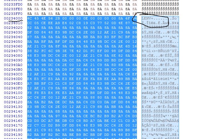

    lenovo 310-15ikb bios repair
    board info: NM-A982 rev: 1
    the unit keeps on restarting. i flashed with other dump and it's now normal but the problem with the dump that being posted here was it had an invalid SN, Model etc... i attached my backup that if somebody could repair it...
    thanks..

      The DMI is 234000 - 235FFF .Those are the off-sets to enter with a hex editor. Open your bios and the working one, enter the off-sets ,copy from the backup ,paste-insert into the new one using the same off-sets .

        Re: lenovo 310-15ikb bios repair
        Thank you very much for the fast reply.. DMI is now back to its original state...
