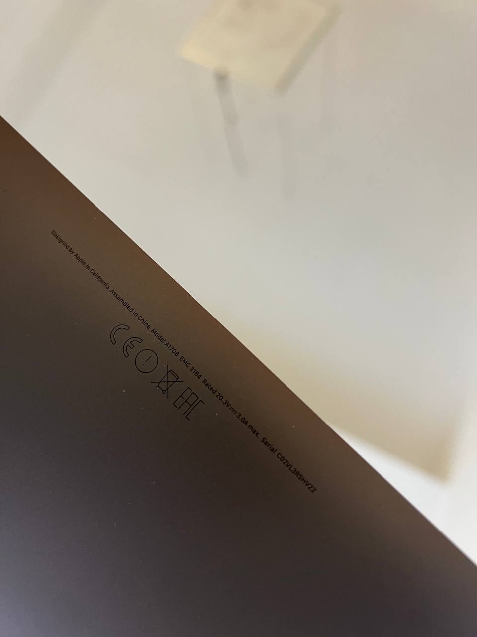

          Re: Please Help Apple macbook pro A1708 EMC 3164 efi Lock
          Looking for help bypassing bios lox on MacBook Pro. A1708 SN: FVFVG17NHv22
          • Vesko356
            VIP Moderator
            • Aug 2018
            • 4386
            • Bulgaria 🇧🇬
            Upload your dump.

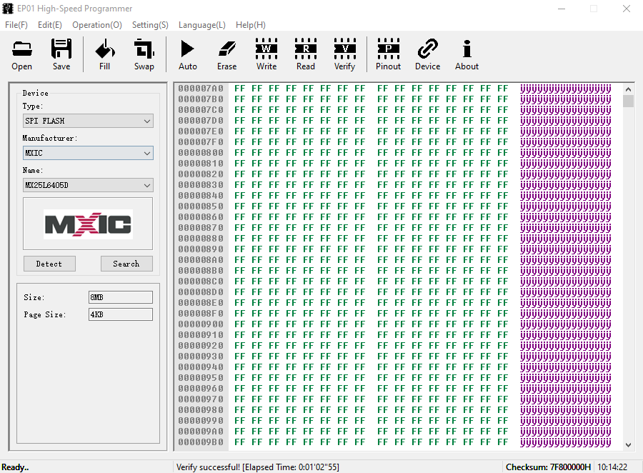

                      • Japacell
                        • May 2022
                        • 3
                        • Brasil
                        #31
                        hello friends, sorry to resurrect an old post, but I have a macbook a1708 locked in the efi too, I would like to know if I can extract the necessary file with a ch431a recorder?
                        sorry for my bad english, I'm using google translator

                          • Japacell
                            • May 2022
                            • 3
                            • Brasil
                            #33
                            Originally posted by Vesko356
                            Please read the rules before posting:
                            RULES UPDATE for BIOS requests/offers *AVOID BANNING, READ BEFORE POSTING*:
                            BIOS guides, methods, resources and tools:
                            https://www.badcaps.net/forum/showthread.php?t=103526
                            Hello Vesko356, I read all the warnings and also read about the ch341a, I saw that you have to lower the voltage to 3v, but the question I need to know is.
                            I'm going to remove the chip from the board and solder it to the ch341 adapter, by doing this I save the file and send it here to unlock it? should i lower the voltage to 3v or can i use 5v? I did not find anywhere on the internet anyone doing the unlocking with this programmer.
                            I'm a little lost, if you can help me!
                            • Vesko356
                              VIP Moderator
                              • Aug 2018
                              • 4386
                              • Bulgaria 🇧🇬
                              #34
                              Yes.
                              The answers to all your questions are given in the topics I mentioned above.
                              Once again the answers to all your questions are given in the topics I mentioned above.
                              Originally posted by piernov
                              Likewise, if you want to modify the BIOS to remove a password, it must be done with an external programmer.
                              When flashing a BIOS always make a backup first. Take 2 or 3 different dumps and make sure they are identical.
                              On Windows, you can use the command "fc /b" to check if two dumps are identical.
                              Make sure that the dumps looks good, i.e. not filled with 0x00 or 0xFF. After compression, if the file has a size of only a few kilobytes, the EEPROM was most likely not read properly.
                              Additionally, please read the FAQ at:
                              https://www.badcaps.net/forum/showthread.php?t=98665
                              1.1.1.6. CH341A
                              Supports I2C (24-series), SPI (25-series).
                              This programmer is not recommended but it is the cheapest programmer available.
                              It has several shortcomings:
                              • Limited interfaces support, only SPI and I2C
                              • Several different software with varying level of reliability and ROM IC support (especially troublesome with 128Mb and larger ICs)
                              • Several different hardware design, some of them having design defects
                              • No proper detection of communication issue with the ROM IC
                              Available software include: NeoProgrammer, Colibri, AsProgrammer, Flashrom…
                              Read the guide there: https://www.win-raid.com/t4175f16-GU...rogrammer.html
                              If you have a black PCB, it is very likely that it needs to be modified for 3V operation instead of 5V. Failing to do so could damage the ROM IC.
                              Watch the instructions there:
                              https://www.youtube.com/watch?v=-ln3VIZKKaE
                              https://www.youtube.com/watch?v=HwnzzF645hA

                              • Japacell
                                • May 2022
                                • 3
                                • Brasil
                                #35
                                Hello friends, good morning, I recently acquired an ezp2013 programmer, I removed the MXIC chip and put it to run, the programmer program recognizes the type, brand and name of the chip, but when reading it, it only comes out as ff without any code, I did something wrong? because he recognizes that the chip is there but does not read the files inside.
                                follow an image https://*******/RNdsx7h
                                Last edited by Vesko356; 07-05-2023, 07:30 AM. Reason: External url removed. Image attached to the post.
