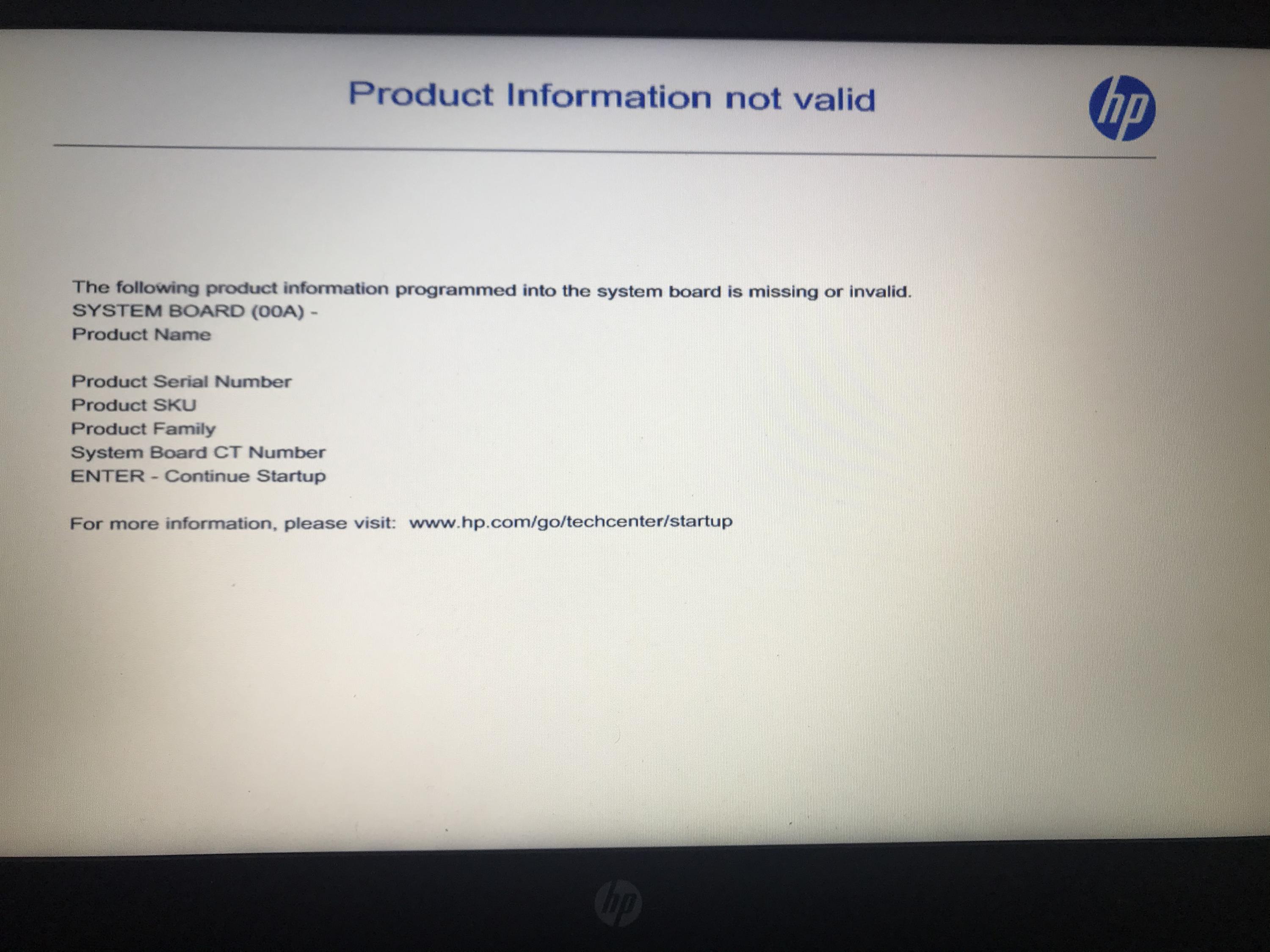

                thank you very much now it's working good but it keep showing up this twoo errors
                • peste
                  • Dec 2016
                  • 12944
                  • ROMANIA
                  Re: Hp probook 640 g1
                  DMI information must be written.
                  try this..
                  https://www.youtube.com/watch?v=9T57ktw8n3Y
                  • shiriffsm
                    Banned
                    • Aug 2019
                    • 35
                    • 87116973284
                    try this..
                    Thanks again, now it working great.

                      • jc_cuerdo
                        • Sep 2020
                        • 13
                        • Philippines
                        mates, what did you put in product name??
                        product name:
                        i got the SKU or Product ID <<--- im sure
                        i got the serial number <<--- im sure
                        i got CT number <<--- im sure
                        i put product name HP Probook 640 G1 <--- im not sure to this
                        after edit and save still PRODUCT INFORMATION NOT VALID
                        The following product information programmed into the system board is missing or invalid
                        SYSTEM BOARD (00A)
                        Product Family
                        ENTER - Continue Startup
                        • jc_cuerdo
                          • Sep 2020
                          • 13
                          • Philippines
                          mates its ok already i miss the Product Family which is HP Probook thanks for the bios file and the link for bios edit thank you sir
