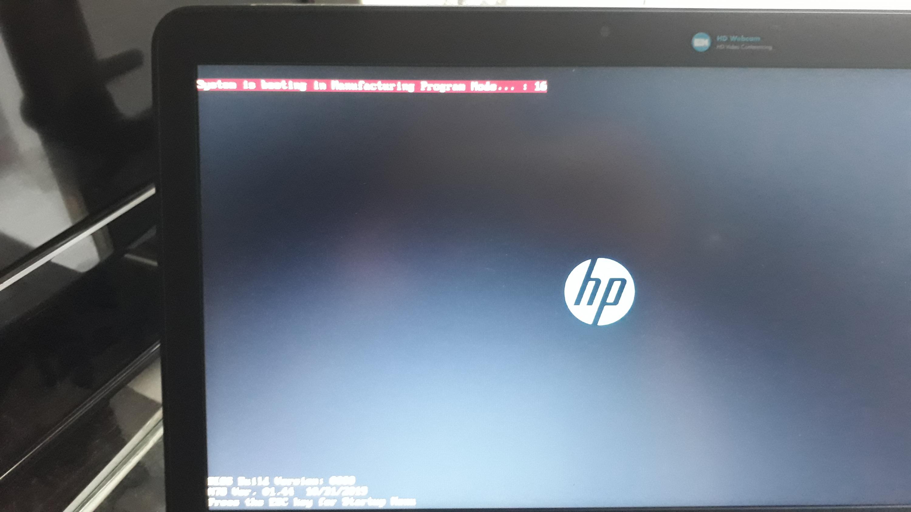

Hp probook 430 g3 bios problemes

    Re: Hp probook 430 g3 bios problemes
    try..
      1) Check in BIOS that Serial etc is set
      2) Cold boot 16 times and MpM Mode is locked back or use WnDMIFit to lock MpM
