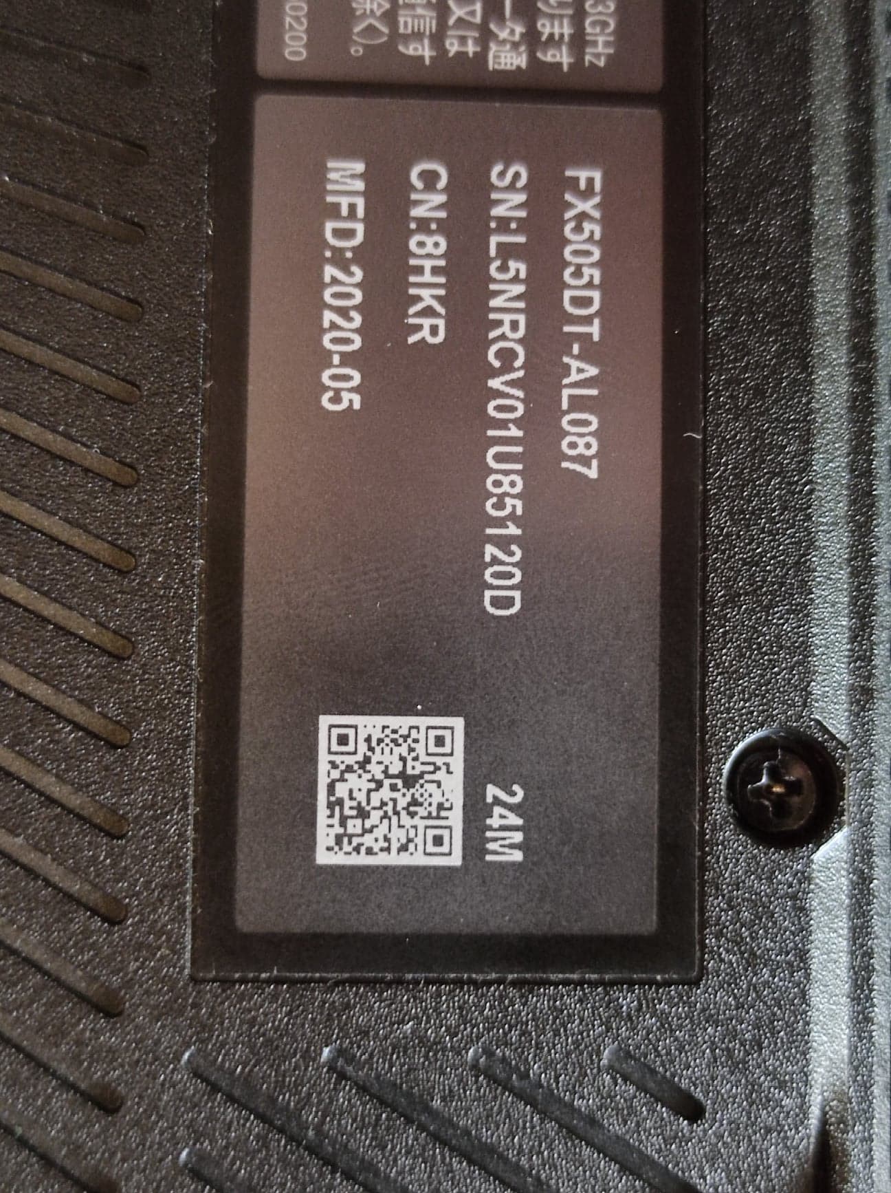

                      Asus fx505dt
                      my old saved BIOS in attach.
                      Where can i find number SN and Windows code?
                      • mattom941
                        • Jan 2021
                        • 8
                        • Polska
                        Re: Asus fx505dt
                        sticker with the QR in attach.

                          Re: Asus fx505dt
                          Originally posted by mattom941
                          where can i find serial number and windows code in peste attached by bios file?
                          Number SN in this bin: SSN12345678901234567
                          How u find this ?
                          in the bios from post # 6 you will not find it, because it is the update from the site, and there is no DMI information, for anyone to use ... but you can write the bios chip of your laptop, with the bios from post # 6, because at Asus at the first start, you will have the DMI information ... they are in the I/O chip ...
                          • mattom941
                            • Jan 2021
                            • 8
                            • Polska
                            Re: Asus fx505dt
                            I succeeded, I made a copy of the SN from the old bios. Thanks!
