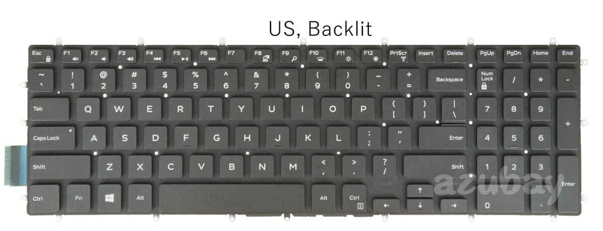

          Try, From bios-pw website
          Code:
          2BEyLGpNazkGQrJh
          37M5IZIqyDhU9GRy
          Codes above are on US QWERTY layout
          Substitute "a" with "q", and "w" with "z", use US QWERTY keyboard pictured below as reference, for uppercase characters hold Shift
          Click image for larger version  Name:	us keyboard.jpg Views:	0 Size:	38.2 KB ID:	3707600

            I have tried the codes in qwerty mode as u suggested but none worked ..
            I have used a converter to convert from qwerty to azety so my 2nd code looked like this : "èIWIayDhUçGRy
            Problem is i cant see what i'm typing

                #88
                Try to find any USB QWERTY keyboard, any language should work, i suggest Spanish or Italian if you can't find English USB keyboard
                Noticed one extra difference, the M key, on QWERTY is to the right of N, on AZERTY is to the right of L; also the numbers require pressing Shift on AZERTY, where on QWERTY no need to press Shift
                Manually "translated" to FR AZERTY, try both
                Code:
                2BEyLGpNqwkGArJh
                37?5IWIayDhU9GRy
                The ? symbol above is Shift+comma, to the right of N
                Use numbers from top row above AZERTY, don't press Shift on the number keys
                Instead of shift, toggle Caps lock on for UPPERCASE, Caps lock off for lowercase
                Do it slowly one key at a time
                Press Ctrl-Enter twice after finishing entering the code
                Code:
                &é"'(-è_çà
                azertyuiop^
                qsdfghjklm
                wxcvbn,
                1234567890
                qwertyuiop[
                asdfghjkl;
                zxcvbnm

                  Thank you both for your help , i have managed to unlock it with CTR-ENTER i was doing ctr-enter-enter;
