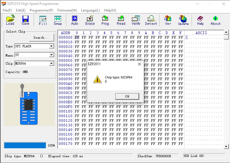

                      I have the same problem, the two bios posted are 16mb while mine is on a 64 chip and is 8mb?
                      The laptop bugged during an official update that I had to do because I had problems booting (ME corrupted?) I access the bios which seems to have done the update, but no more boot...
                      If someone can look at it and tell me I'm interested, I put the original

                        Thanks for the quick response.
                        Then the pc starts the bios seems to have initialized (2 restarts) but black screen

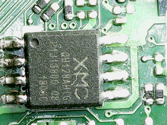

                              sure the bios chip a wanted original 64MB ??
                              • Rhork
                                • Apr 2020
                                • 28
                                • France
                                Re: Bios Acer A515 LA-G521P FULL TEST
                                I got it like that I didn't change the chip and the bios provided is the one that was on it after the bios update, and I had been able to do my Windows installation with everything functional before doing this update!

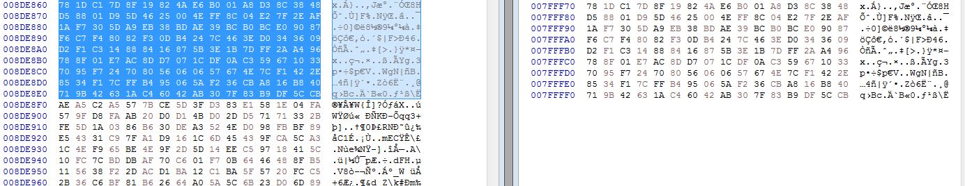

                                  Whats the part number on top of the bios chip. Look at the attached picture, on the left is the bios update from acer with only 8MB selected (of the 16) 0 - 7FFFFF ,on the right is the code at the end of your bios, both have the same code.I think you or the programmer have selected the wrong chip.If it really does have an 8MB chip replace it with a 16MB

                                    yes..consider item # 18 and install a 16 MB chip..write it with this content extracted from the Acer site update ...
                                    DMI 670000 - 671FFF

                                      So thank you, in fact when I said that it was a 64mo chip it was because the programmer detected it as such...!
                                      But no, it's a 128MB chip!
                                      I understand better the problem of the bios, I will change it and install the bios provided.
                                      Sorry I was a bit stupid...
                                      I'll keep you informed, thanks to both of you

                                        All is good now thanks a lot !
