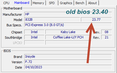

                        • ecnebi
                          • May 2023
                          • 4
                          • TR
                          Re: HP 15 BS102NT Bios need
                          Originally posted by peste
                          post the original bios even if it is corrupted..
                          sp146927
                          F.72
                          2 MAY 2023
                          • ecnebi
                            • May 2023
                            • 4
                            • TR
                            I found the method that works, for those who are having trouble.
                            Use Ch341a V144
                            Power cable plug'in (not power on)
                            1- Erase Chip
                            2- Fill the buffer
                            3- Read
                            4- Write
                            5- Verify
                            I tried many times and it didn't work, I tried again today and the bios is (F.72) ok. Which of these files is the correct file?
                            084D4
                            0832D
                            0832E
                            08328
                            08445
                            I saw via cpu-z, The old bios F.24 motherboard model 823B - 23.40
                            I don't remember which new file I used, there are changes. F.72 823B - 23.77
                            Is the bios correct? (I think 8328)
