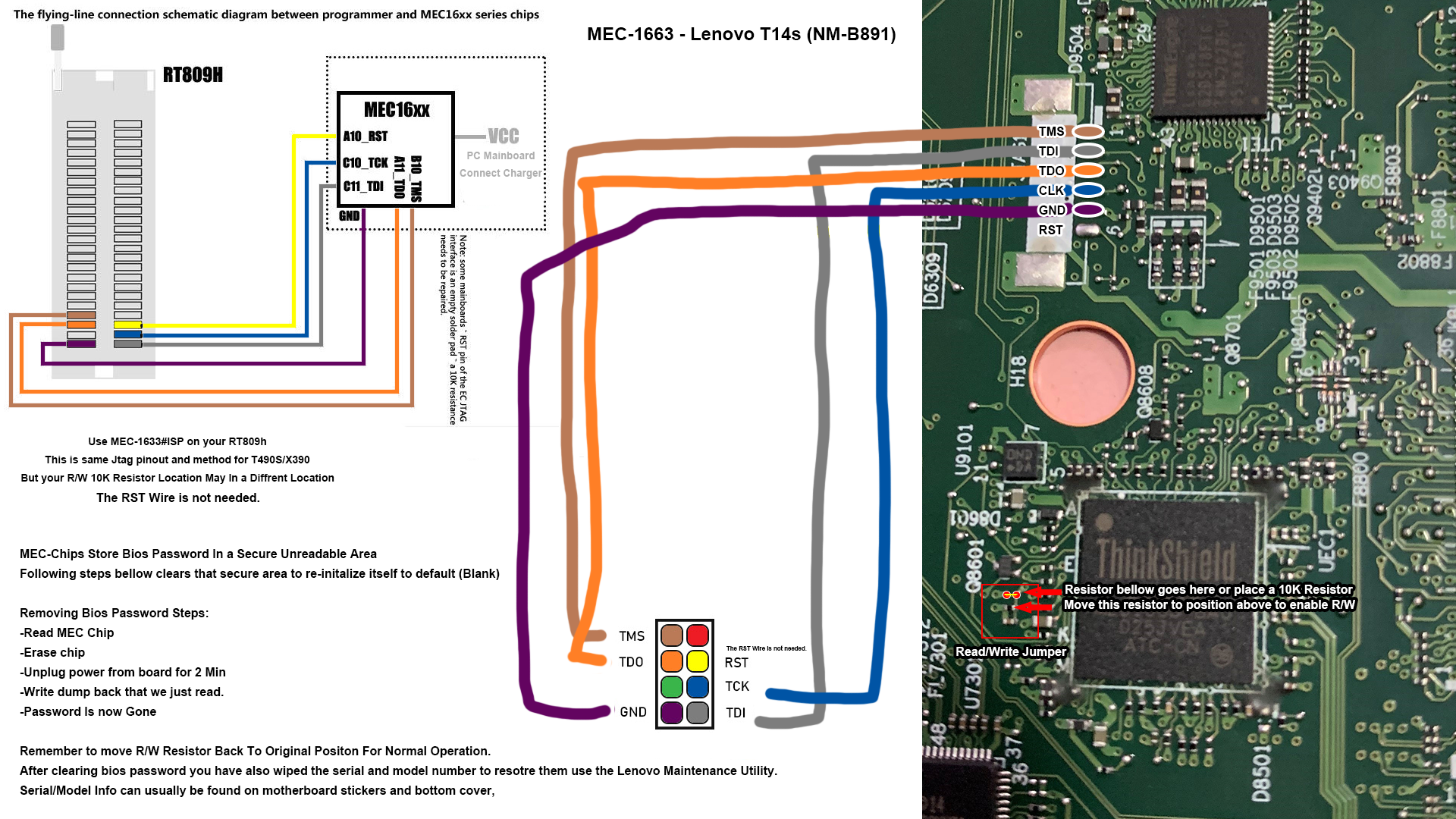

    Ok now that that is solved ill share my diagram and instructions.
    T14s - MEC-1663 - Jtag - Pinout - Bios Password Removal
    Now next issue setting Serial / Model / Etc.
    Lenovo T14s (NM-B891)
    Iv Tried to Use Lenovo Maintenance Utility 1.89 (i7tm38us)
    But I get and error *EEPROM Overflow
    Same issue here: https://www.badcaps.net/forum/showth...EPROM+overflow
    You are using MEC-1633#ISP in RT809H Settings, the resulting file is 192k, is this the correct size? shouldn't it be 256 or 290?

                Using RT809F, choosing MEC1633-256K , unlock done.
                Don't choose MEC1633#ISP , it provide 192K file and password is not removed after write back.

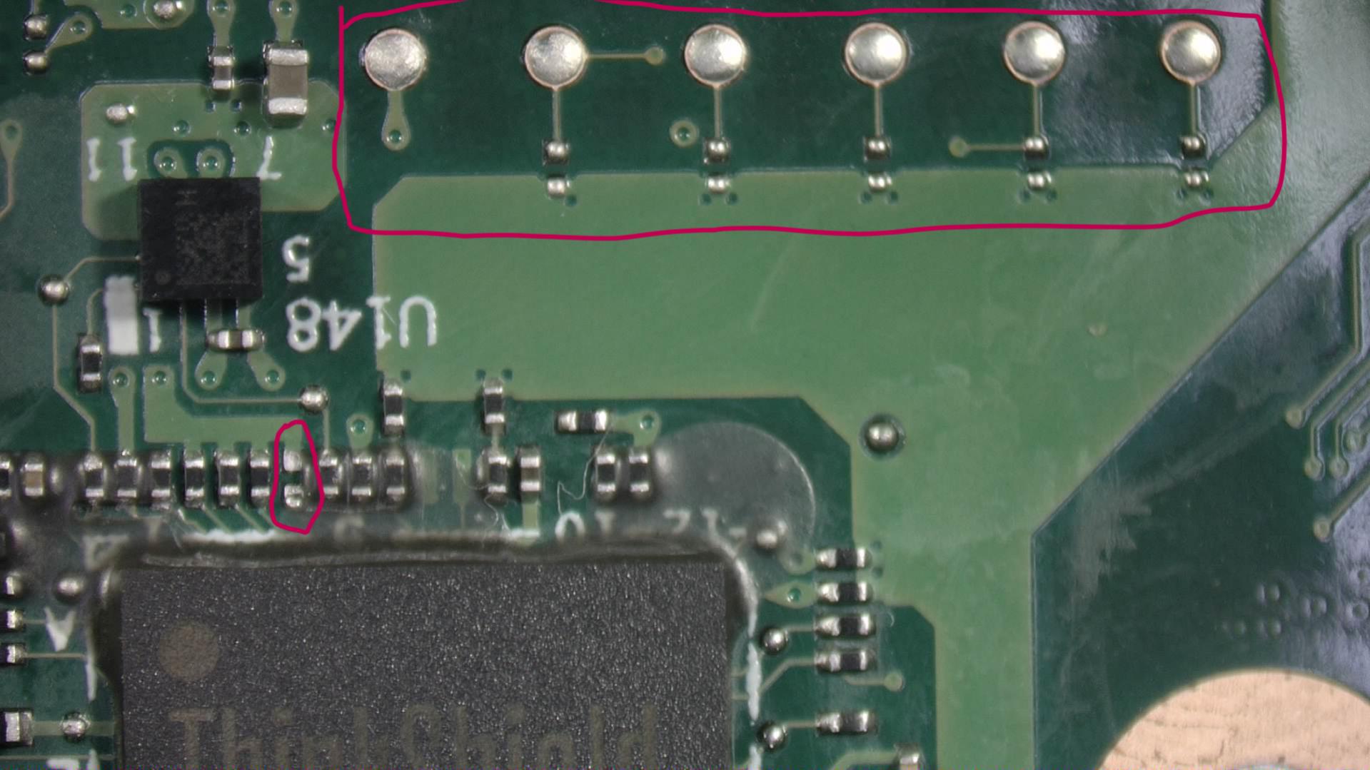

                      Hello, This board is for the Lenovo X1 Yoga gen 5, I need to read the MEC1663 chip but I am asking if the indicated red button is the JTAG pins outs ?
                      Also I knocked out one resistor and i believe it is 10K 0201 resistor.
                      thank you in advance.
                        Re: mec 16xx dump with info block
                        Yes, somebody connected like the attachment photo.

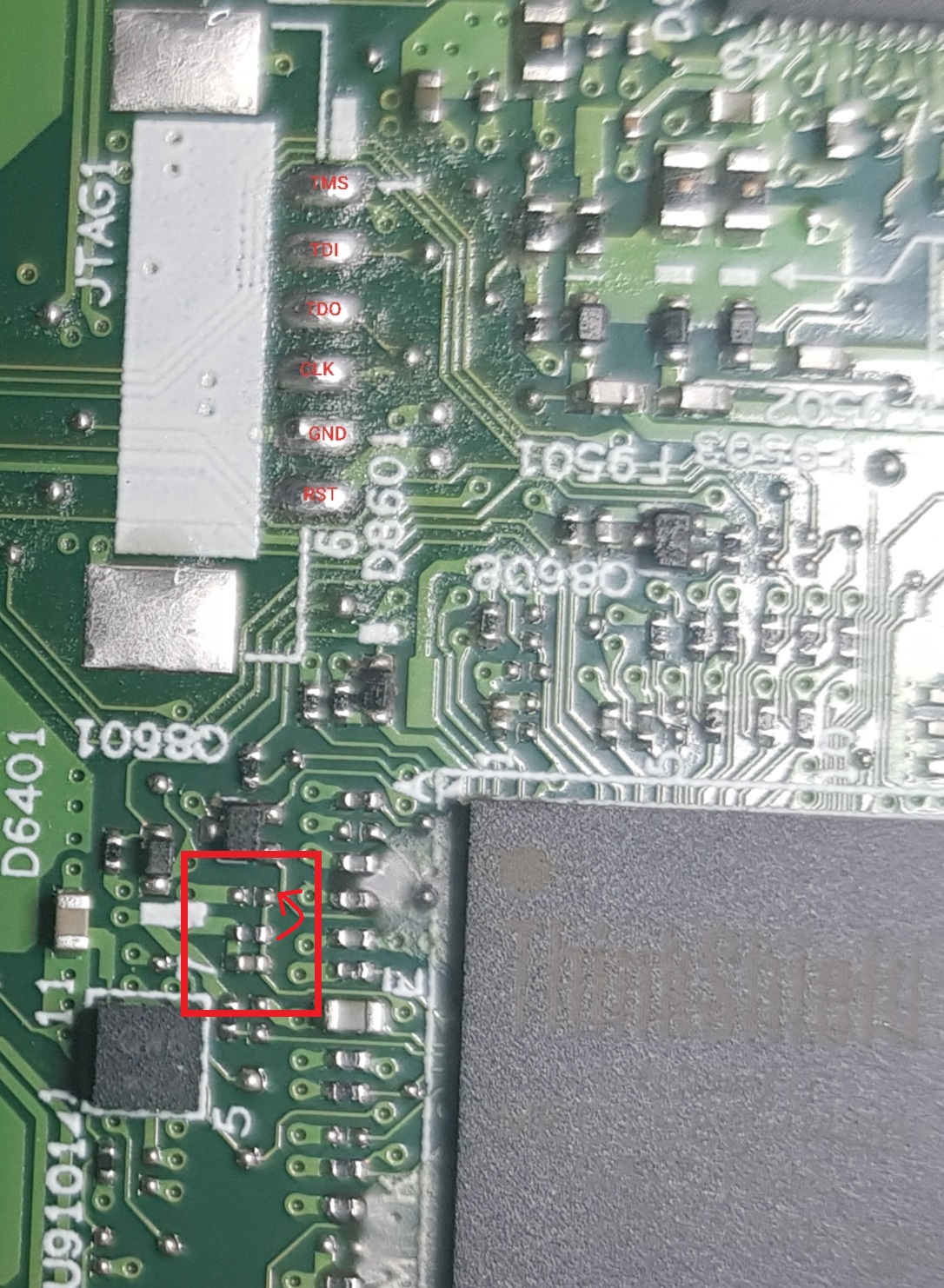

                                Please can you help me label which one it is TMS, RST, TDI, TDO and GND. Thank you
                                  like this :
                                    Originally posted by dimah77 View Post
                                    like this :
                                    Yes I saw the flying configuarions from previows post and or on the RT809H but this is different. On your image looks like the jtag pin number 5 is GND but on the x1 Yoga Gen 5 pin number 6 is GND

                                      Lenovo: ThinkPad T14 Gen 1
                                      MB: NM-C931 with MEC1663
                                      Issue: Need to remove BIOS PASSWORD
                                      SVOD4
                                      I moved R8715 to R8716 position and solder the wires to the JTAG Port, I am getting this from the SVOD: (see image)
                                      And when clicking read, it reads the MEC but I cannot see any data on the HEX section. (The machine does power up)
                                      I am afraid to clic on erase and brick the computer!
                                      Any help?
