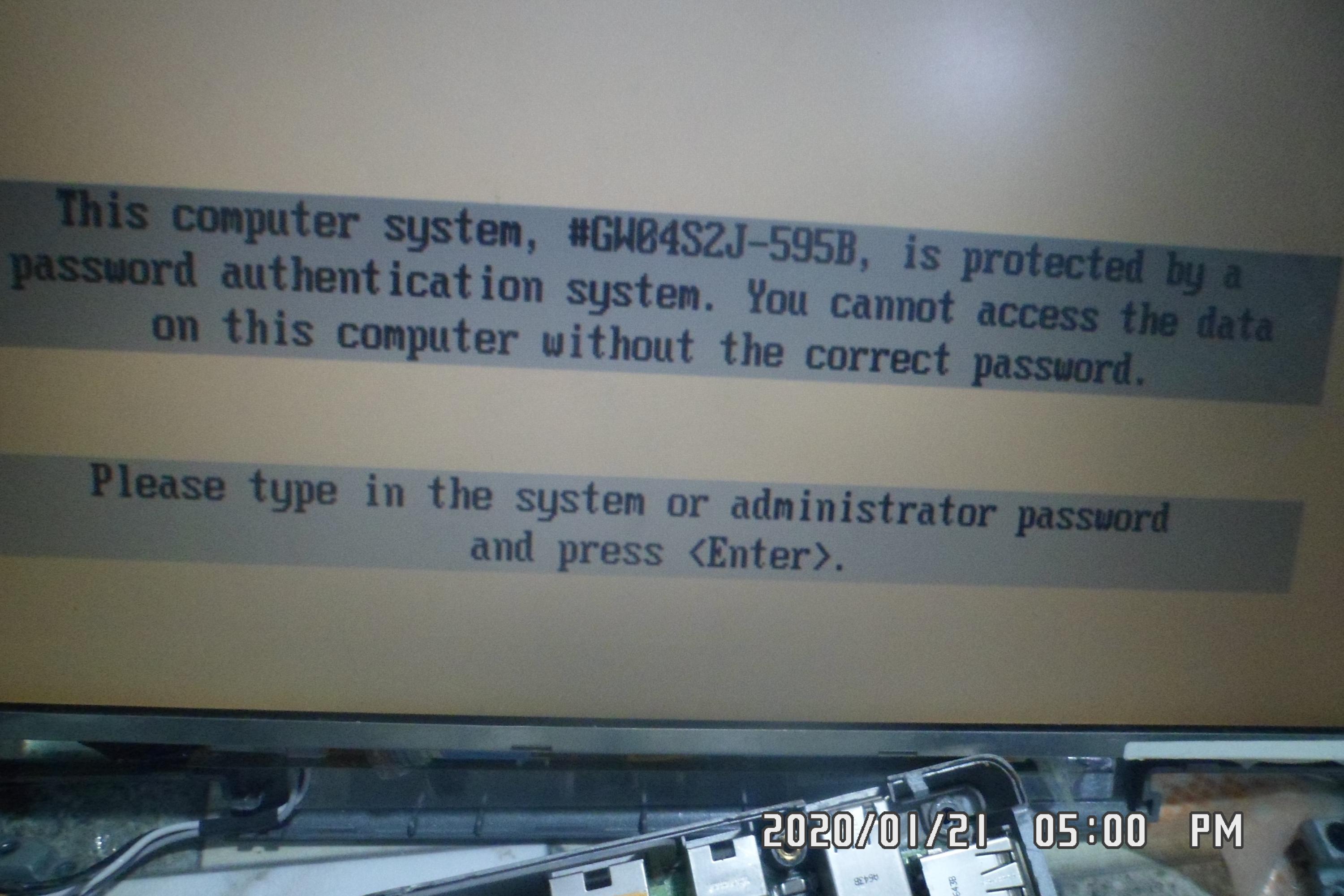

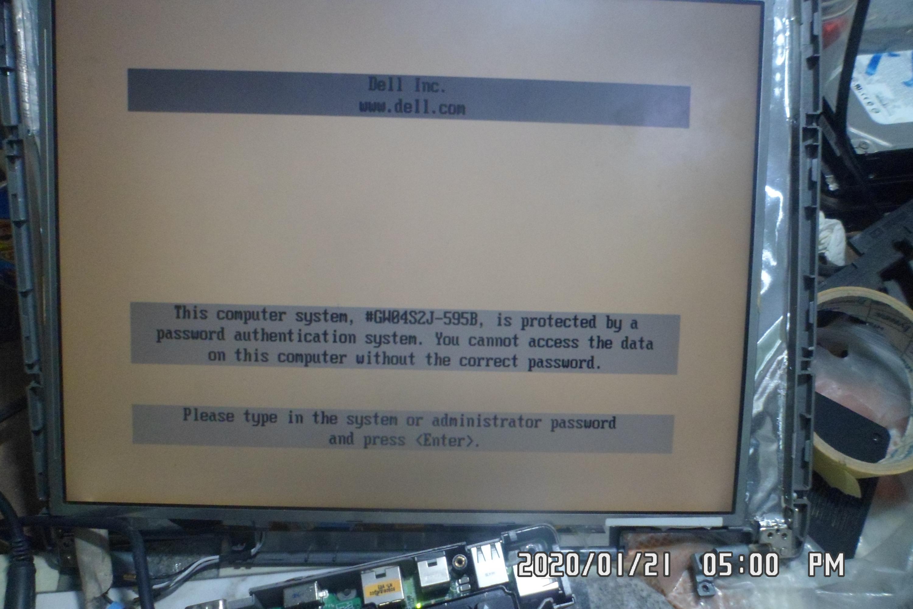

    i have a problem with dell LATITUDE D520
    i have a PASSWORD in bios and forgoten
    this is the message

      Enter Dell Service Tag followed by a 4 digit, hex suffix (ABCDEFG-1234)
      Input: GW04S2J-595B
      Password: 1zxqpxrz
      1 - ( digit )
      z - zulu ( lowercase )
      x - x-ray ( lowercase )
      q - quebec ( lowercase )
      p - papa ( lowercase )
      r - romeo ( lowercase )
      Password is case sensitive!
      Passwords are for QWERTY keyboard only (standard US)
      Enter calculated password carefully, Then holding CTRL push ENTER key twice

        If it doesn't work, use that password.
        Old Dell Suffix 595B bug
        ( passwordA95B: vsi53lny)

                    @Gnikosalalalal33
                    Other thing to consider with a non-working password is the keyboard layout, as according to Dell website, this laptop was sold in France, hence it has an AZERTY keyboard layout.
                    Are you using a US QWERTY keyboard to type the master password?
