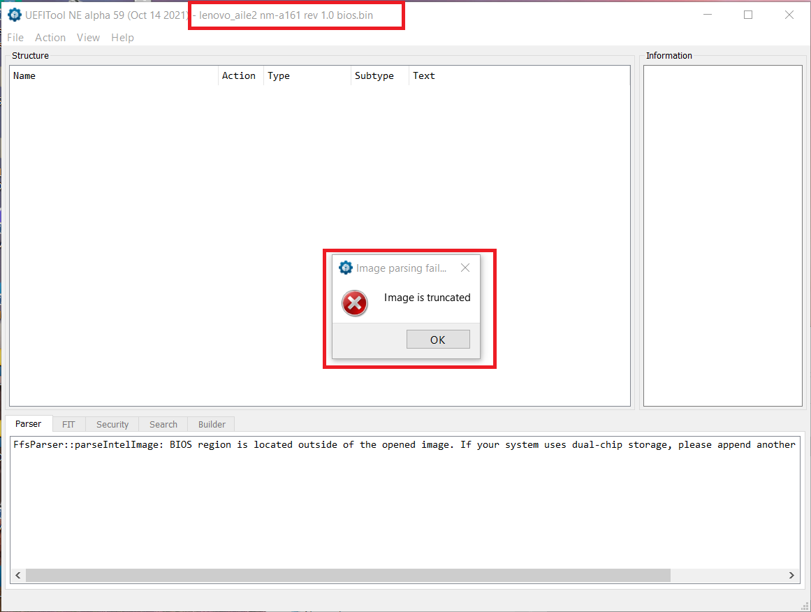

    e540 NM-A161
    Old dump : late image and 30 min power off
    Can you fix this ?

          shutdown problem continues
            • 20837
            Re: e540 NM-A161
            The ME firmware can`t be fixed properly (the manual way using the guide at win-raid) because you only posted one bios backup. The E540 has a dual bios, 8MB and 4MB.To clean the ME firmware you have to merge/stitch both bios together using a hex editor first,and only then can the ME be cleaned with FITC.
            Post your 4MB bios here or find a bios on the forum using the Search .

              @peste ,how are you cleaning the ME firmware,are you using the manual way with fitc or using some software,such as easy me clean ??

                here :

                      The program "easy me clean" use it less ,and only for older laptops, for new model laptops the method does not work very well. I usually use the fitc method.

                        Can you tell us the PCH number on your mb And which processor you are using to test the mb? Just check processor compatibility as some pch like SJTNV supports only celeron and dual core processor.

                          please were you able to find the clear ME file for your laptop?

                            here is the clear ME

                              GODIT3 THIS BIOS IS WORKING THANKS MANB
