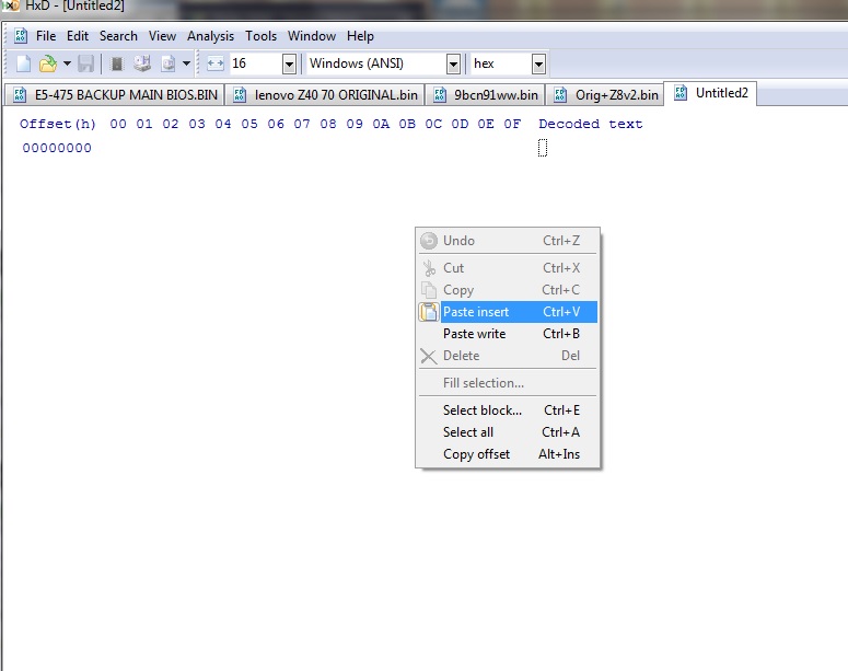

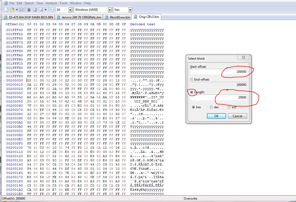

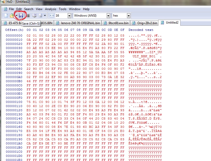

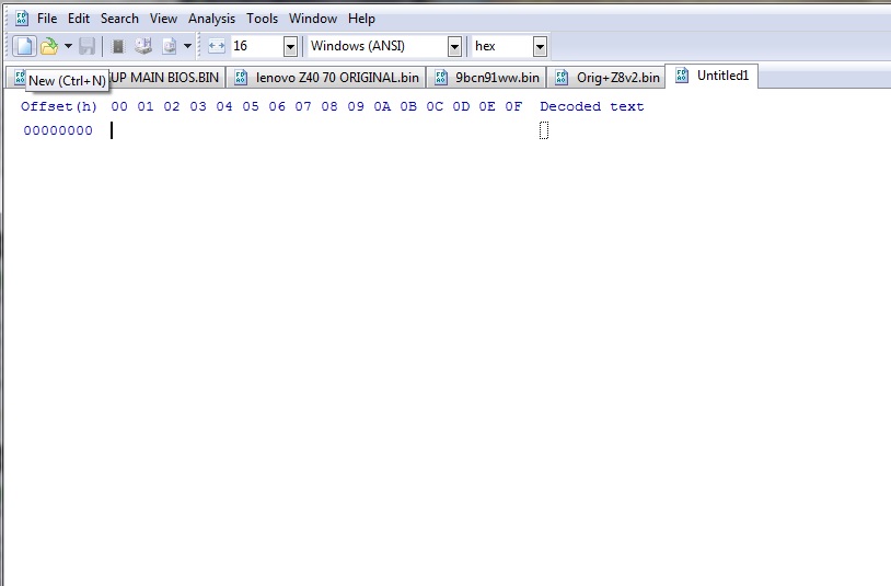

              Re: Acer Aspire E5-575 Bios
              Originally posted by peste
              try this version too..for EC writing you need another programmer ... see on the net.

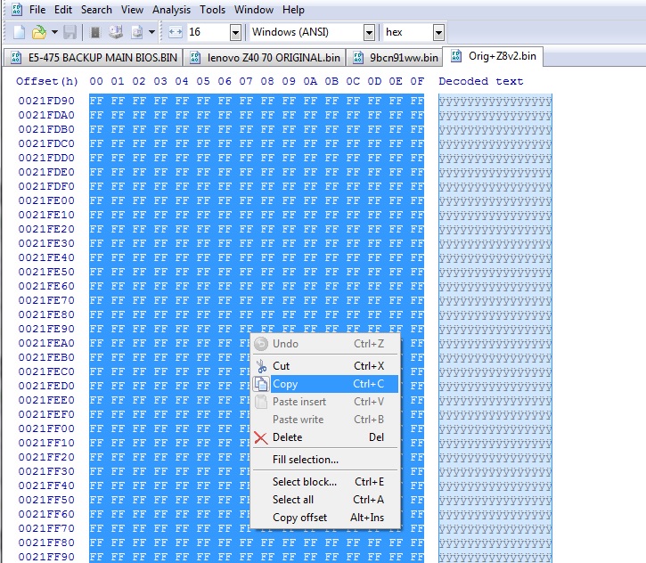

              Hello, I bought RT809H programmer.
              Can you tell me, please, how can I extract 128kB file for EC from the big 8MB BIN file?
              • peste
                • Dec 2016
                • 13199
                • ROMANIA
                use the HxD program....
                • mauda
                  • Mar 2016
                  • 24
                  • Czech republic
                  Wow, thank you very much. I understand it well.
                  I should write the full BIN to the 8pin EEPROM chip
                  and the extracted 128kB BIN to the 128pin EC chip.
                  Am I right?

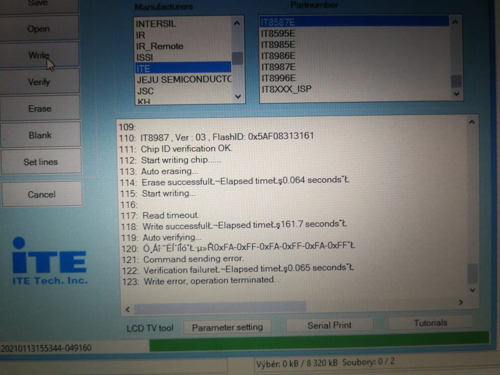

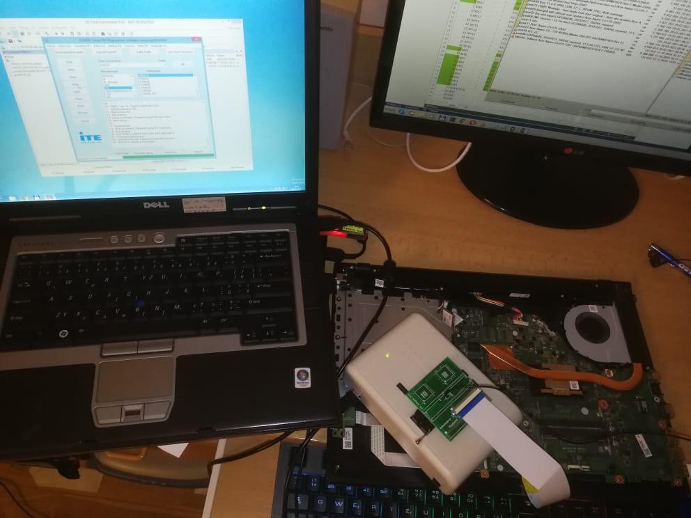

                  • mauda
                    • Mar 2016
                    • 24
                    • Czech republic

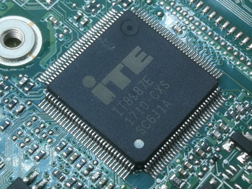

                    #29
                    I found out the correct programmer settings and now I can read the contents of the EC chip. I backed it up.
                    But when I try to write to the EC any other content, I get an error. I also tried the backup file.
                    Where can the problem be?
