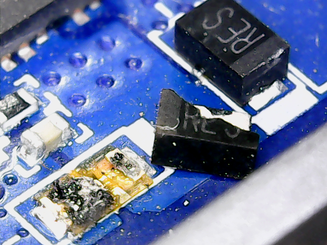

                    Re: HP ZBook Studio G5 BIOS Plz
                    I fixed the problem, but there is a password any help ?
                    there are 3 eeprom
                    32MB + 16MB + 1MB
                      Here is
                                1) in the main Bios i cleaned all the NVRAM and the password still showing.
                                2) i have a new problem : I hit a circuit with the fan, now he does not want to start pffff
                                3) I do not know if it's a resistor or diod .....
                                i need a schematic or boardview to fix it
                                  this is a diode brother put same size without schematic maybe working
