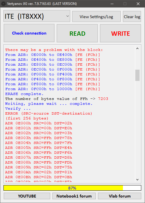

                    UPDATE:
                    Ok, the Bios works fine, It got back all the features and it says GL502VMK again.
                    But, when I compare the EC file with my dump, the dump is of lower size.
                    I think it is related to the Veryanov parameter of FLASH=56
                    Should I erase that parameter?
                      • 20978
                      Re: Asus Rog Strix GL502VM EC Bios Needed
                      Yes try it, or change parameter to 64 and try that.
                        It gets corrupted if Flash>56 I think>
                        Here is the new dump.

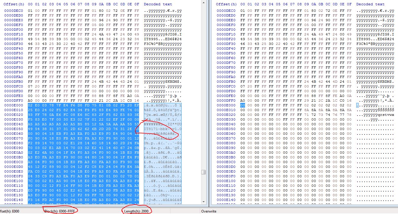

                          • 20978
                          See the attatched picture,your ITE_2.bin is on the left,the 128KB EC i cut from the VMK bios is on the right. Compare the 2 files.At offset E050 the ITE_2 says IT8171-bbk--v1.0 ,itmust be the 8KB bootblock from E000-FFFF.The first dump ITE_.bin is 56KB ,there`s no bootblock, all 3 files compared the same (56KB) from block 0-DFFF .Did you delete the FLASH=56 parameter before you dumped the ITE_2.bin
                            Yes, ITE_2.bin is with FLASH=64, I also tried removing the FLASH parameter (The default makes FLASH=128) But it has the same results.
                            Also looking at boardview, I managed to dump and program IT8995 with the full EC file.
                            But I also checked that Main bios reprograms it after first boot. (After first boot I compare both dumps and they're different)
