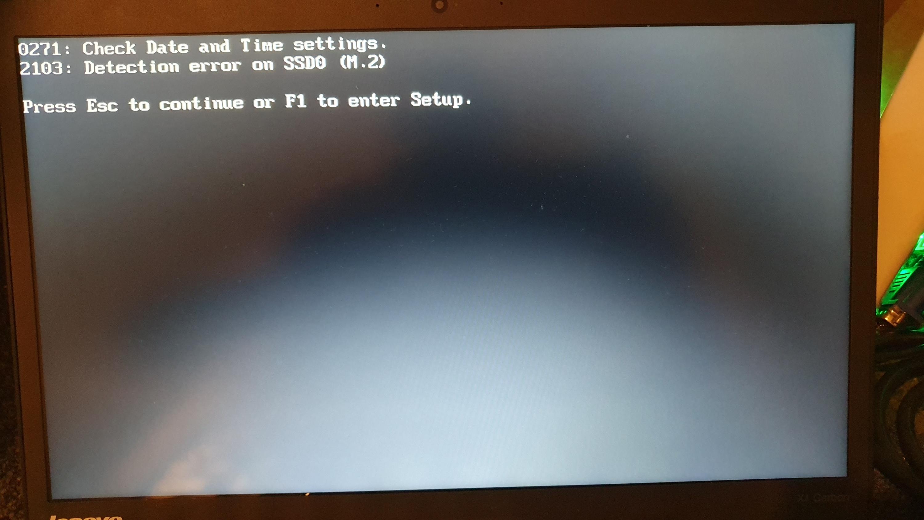

                  Hi guys, I'm trying to repair my lenovo x1 carbon 2nd gen and I'm stuck because I need a file that I can't find. Could someone upload a Me 10.0.57.3000_5MB_PRD_RGN.bin?. Thank you very much in advance
                    Here it's. I got it from Win-Raid Repository.

                      I bought a motherboard and it came with a password in the bios. I downloaded a bios ver-10.0.57.3000 that promised to remove the password and it did, but now it does not recognize the ssd0 and does not load the O.S. If I flash the original bios ver-9.5.63.3002 I don't have video and before I did, so I'm a bit confused. I'm going to try to create a clean bios with ver-10.0.57.3000 and see if it recognizes the SSD,Let's see what happens, this can't get any worse, so...
                        If your Main Problem was the Password, why you didn't use the Patching Method to remove it?
                        I attached your Patched file, it's created by Lenovo Auto-Patcher tool, you should follow the steps in that Thread: https://www.badcaps.net/forum/showthread.php?t=87588
                        But before that, your device should works with the Original Backup.
                        If the device doesn't work with the Backup, write your device Serial Number and we will try to fix your file. Also maybe you have moved any component nearby the BIOS Chip.

                          I don't know, I don't have much knowledge about programming and I spent several days looking for how to remove the bios password and I didn't find much except this video tutorial that had exactly my problem and apparently the process seemed simple, but I was very wrong, if I had found this forum before. .. https://www.youtube.com/watch?v=T4jLczSIUYE
                          Regarding the missing component near the bios chip, it's impossible because I use CH341A with the clip, so I don't need to desolder the chip for flash.
                          I have tried many different bios versions but only the chinese bios that I use to remove the bios password turns on the screen and I can access the bios settings, but it does not recognize the SSD.
                          When I flash my original bios, if I first erase the chip and then flash the bios, when I plug in the charger the power led turns on and when the keyboard light turns on the laptop turns off. If I flash the bios again without erasing the chip, when I connect the charger the power led blinks 3 times and then goes off. So I erase the chip again, I flash the Chinese bios and again I have video and bios screen. Now without deleting the bios chip I flash my original bios and when I connect the charger it turns on normally but without a video screen (black screen).
                          I also tried with my bios patched, with no positive result.
                          I'm still stuck and I think this problem is already beyond my little knowledge on this topic.
