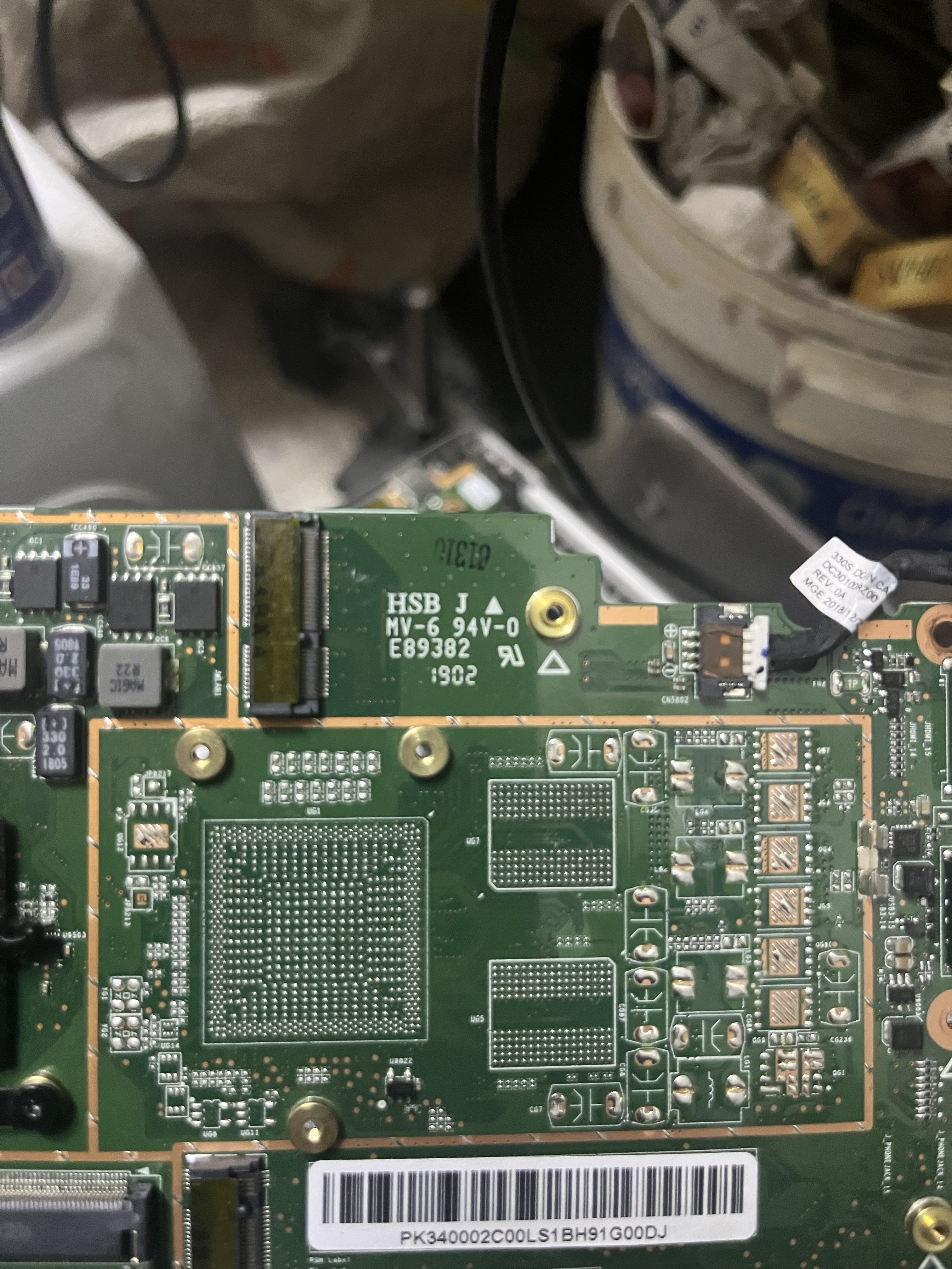

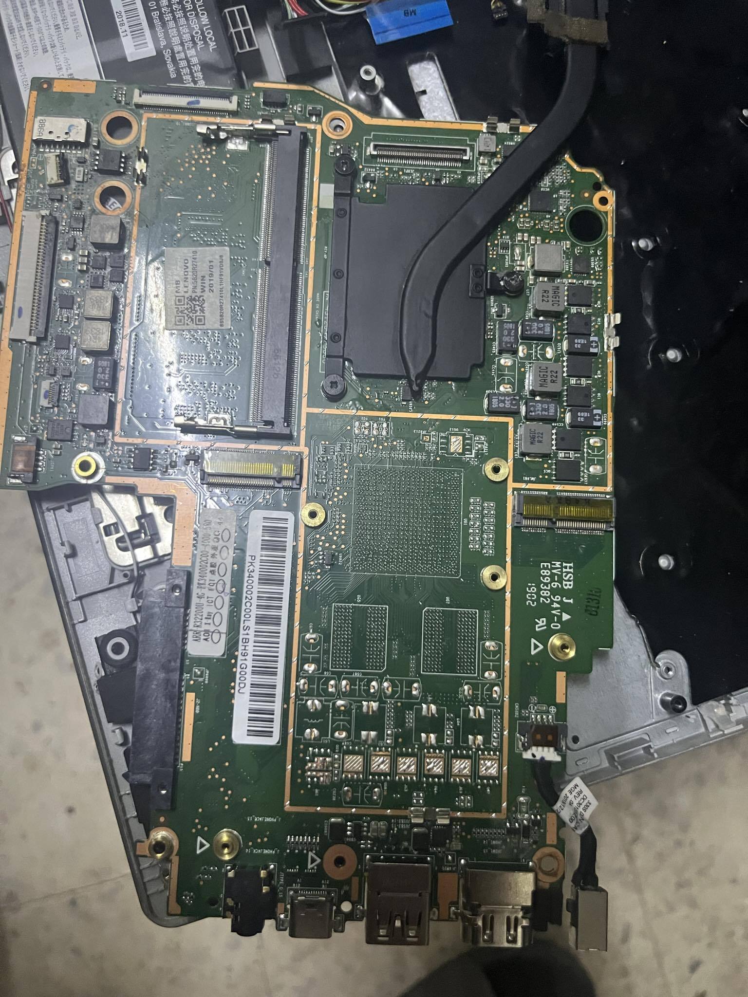

                                    LENOVO hsb j mv-6 94v-0 e89382 OLD BIOS

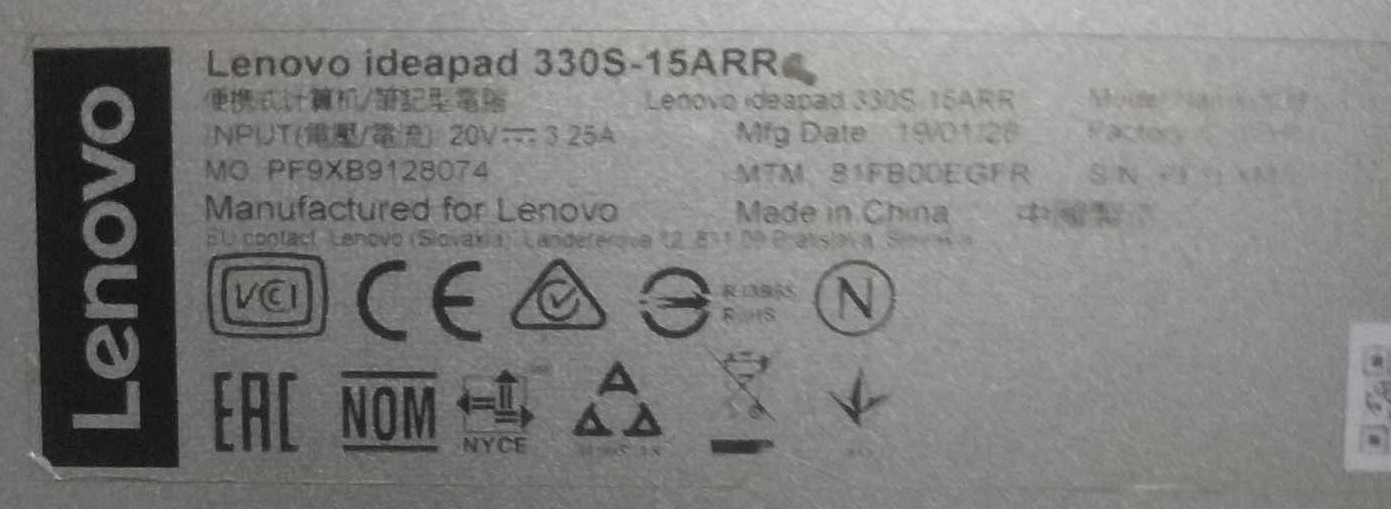

                                        SORRY ineed this bios : LENOVO hsb j mv-6 94v-0 e89382
                                        LENOVO
                                        hsb j
                                        mv-6 94v-0
                                        e89382
                                        pc : lenovo ideapad 330S-15ARR
                                        MTM : 81FB00EGFR ( its not clear )
                                        MO : PF9XB9128074

                                          try post#27si 29
