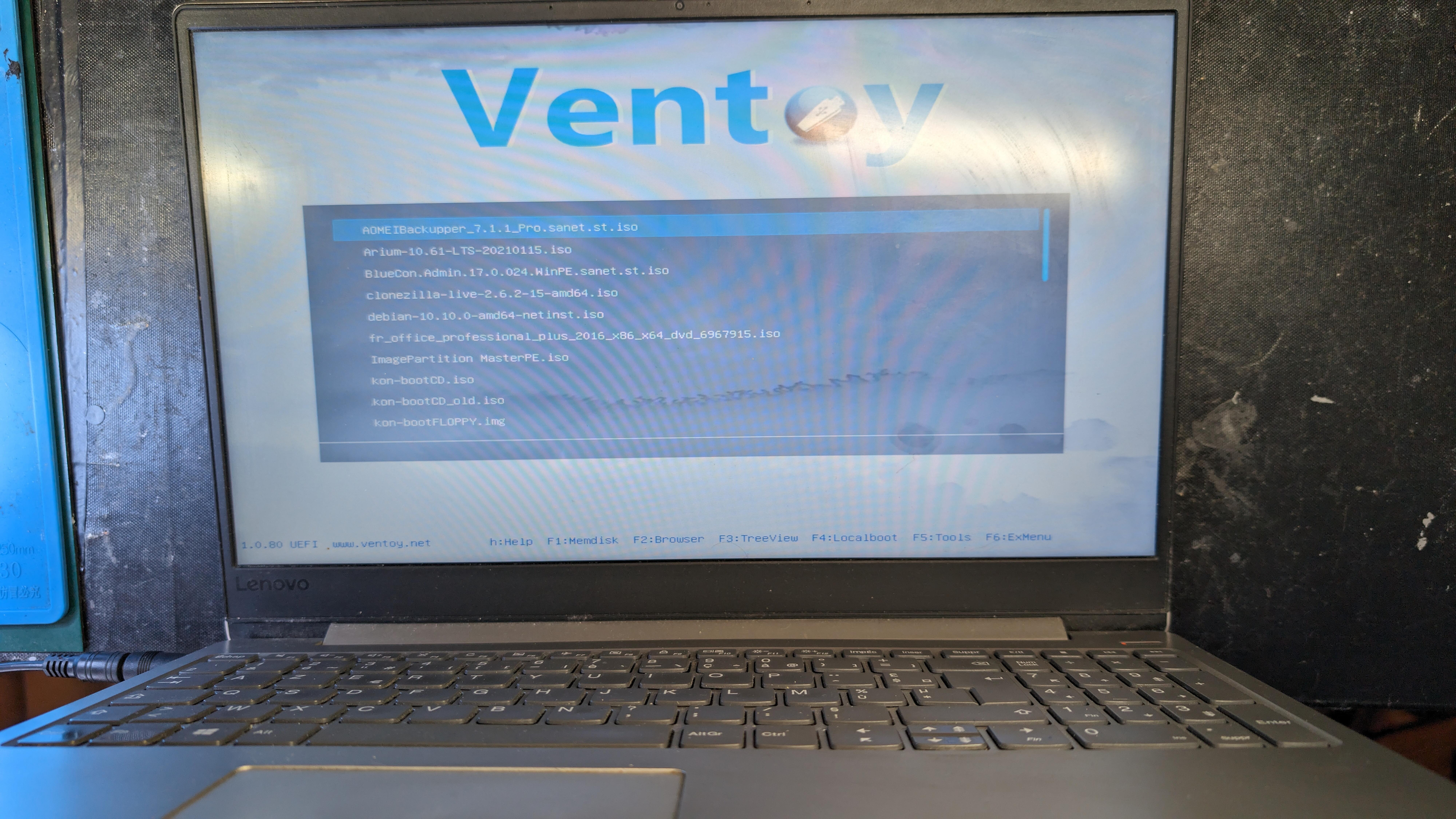

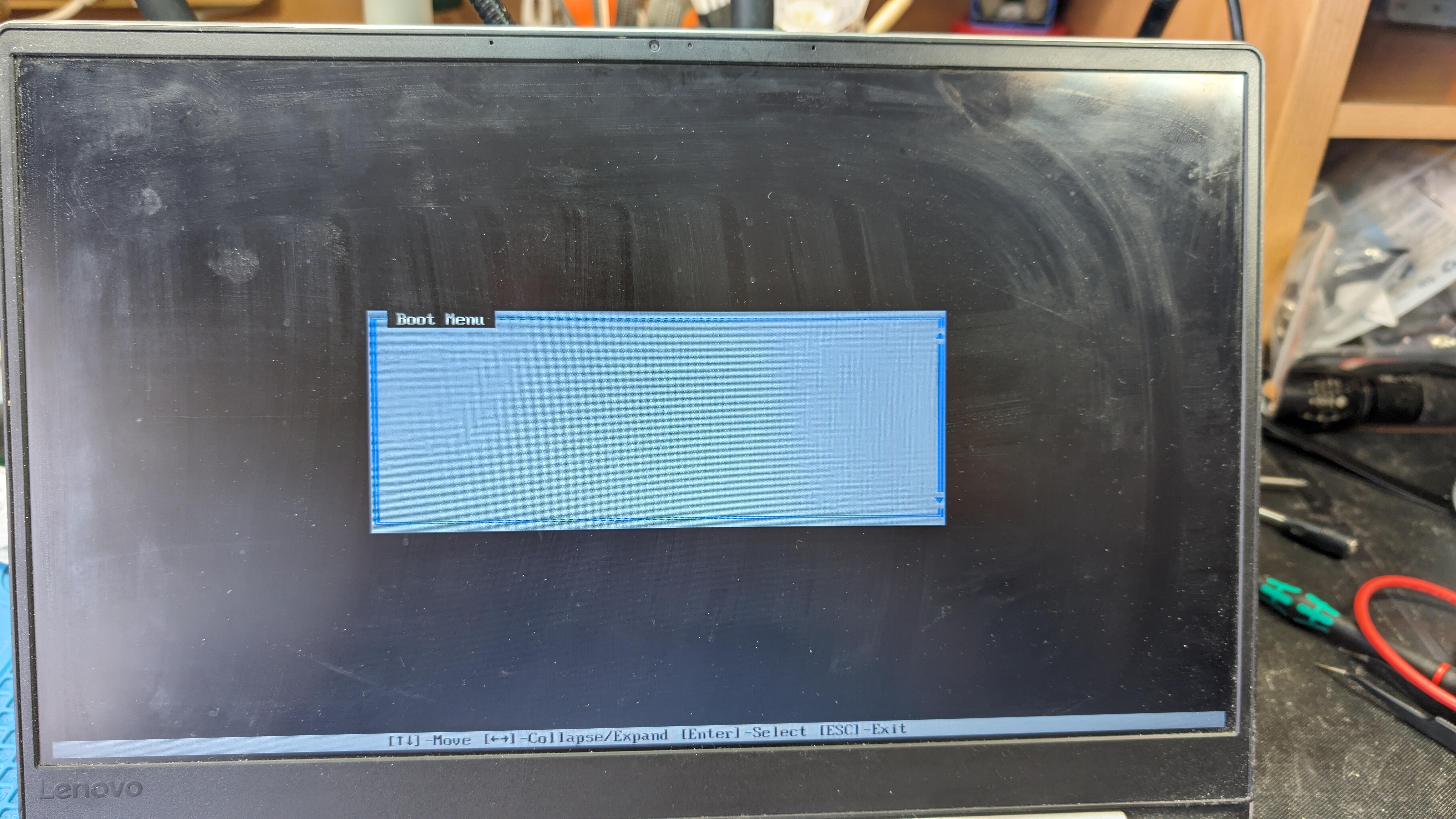

            • Christian0734
              • Nov 2020
              • 92
              • France
              #106
              With the BIOS provided by danito , the 'LENOVO' logo appears and I can boot from my Ventoy SSD, as you can see in the photo. But as soon as I select an application and press Enter, the computer shuts down instantly. The same thing happens if I boot into Ubuntu: I can select the version, but as soon as the desktop is about to appear, the computer shuts down. It's not just the screen; the entire computer shuts down, with no power consumption. I've tried flashing it several times, but the result is the same. Does anyone have another BIOS to suggest?
              • Christian0734
                • Nov 2020
                • 92
                • France
                #107
                The PC is working, so I'll take this opportunity to remind everyone of a basic rule that I had forgotten! If the PC boots into the BIOS, make sure to load the default settings before proceeding further. I had forgotten to do this, and my PC was showing the symptoms I described in my previous post. Hopefully, this can help someone. Furthermore, for serial numbers and keys, I followed the procedure of a contributor in this thread using the HxD software, which is super easy. Thanks to all the contributors of this irreplaceable forum
