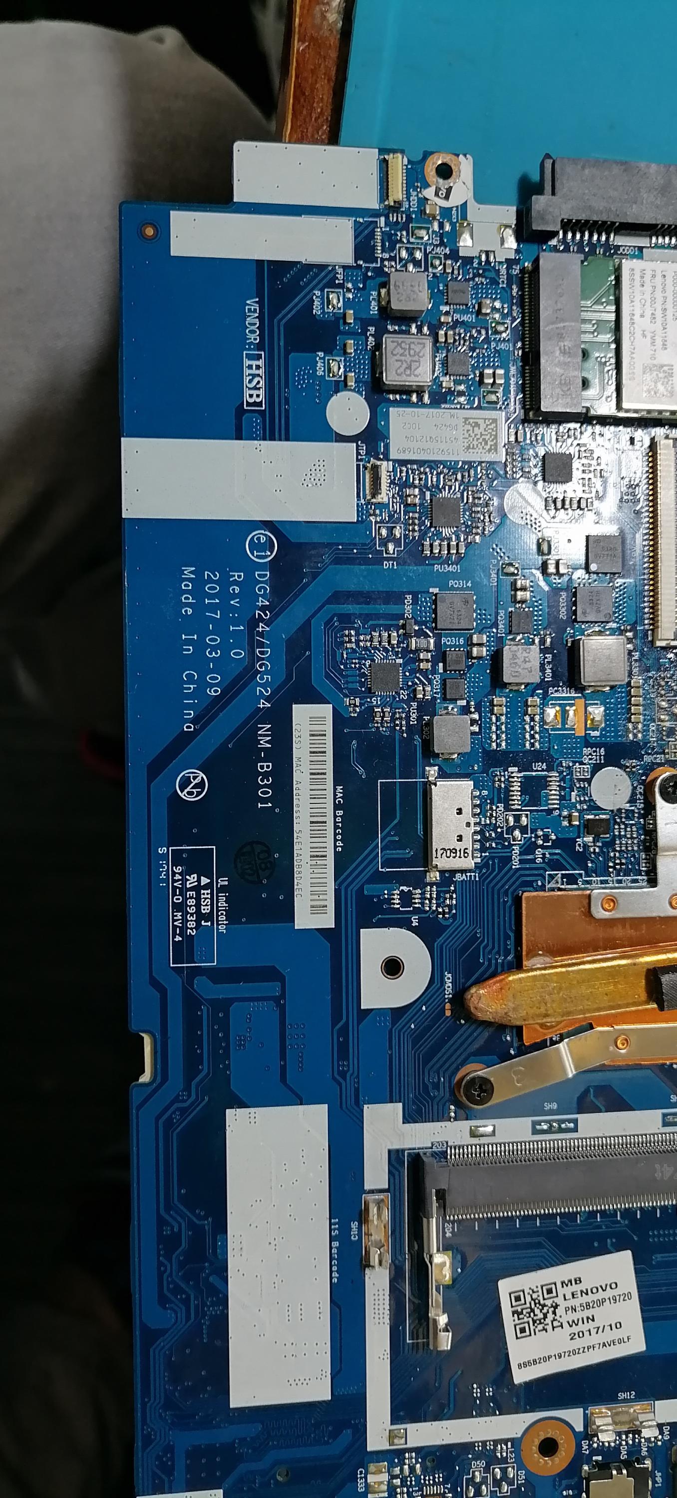

        please help i have lenovo ideapad dg424/dg524 nm-b301 rev 1.0..
        problem is bios password..so i try all basic intruction to solve it but no result...

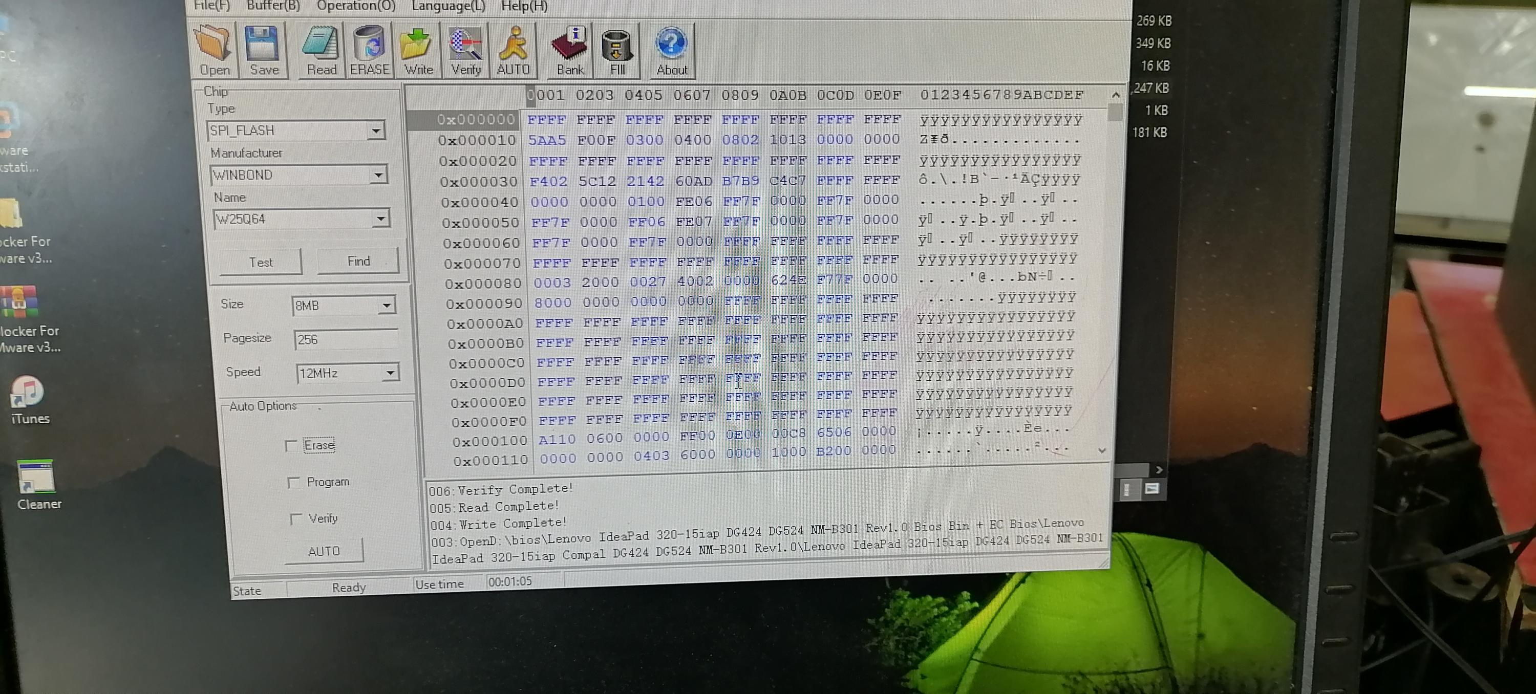

        so i try to flash the bios chips in EZP2019 flasher..first move is to back up the bios chip..then i flash..i insert the file lenovoideapad 320-15iap DG424 DG524 NM-B301 GD25LQ64B.bin and all the tested file i download i insert to bios chips but the result is the laptop turn on but no display long press power on to power the unit...so im just decide to i insert again the back up bin file...but it same no problem...long press power and no display...please help....

                              Check the programmer again, read the chip failed, the bios file is corrupted. Be careful.
                              • upstore
                                • Apr 2022
                                • 13
                                • rivera
                                #35
                                Re: lenovo 320-15iap please help
                                huh... so you mean the file i read is currapted???
                                my programmer tool is only EZP2019 HIGH SPEED
                                ALL PROCESS READ WRITE VERIFYING are done with no error..
                                what should i do now.. huhuhuhu...

                                  Choose the bios chip manually,not auto-detect.Get the part number etched on top
