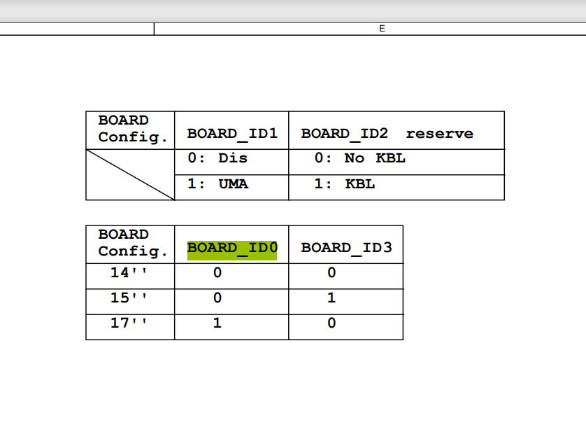

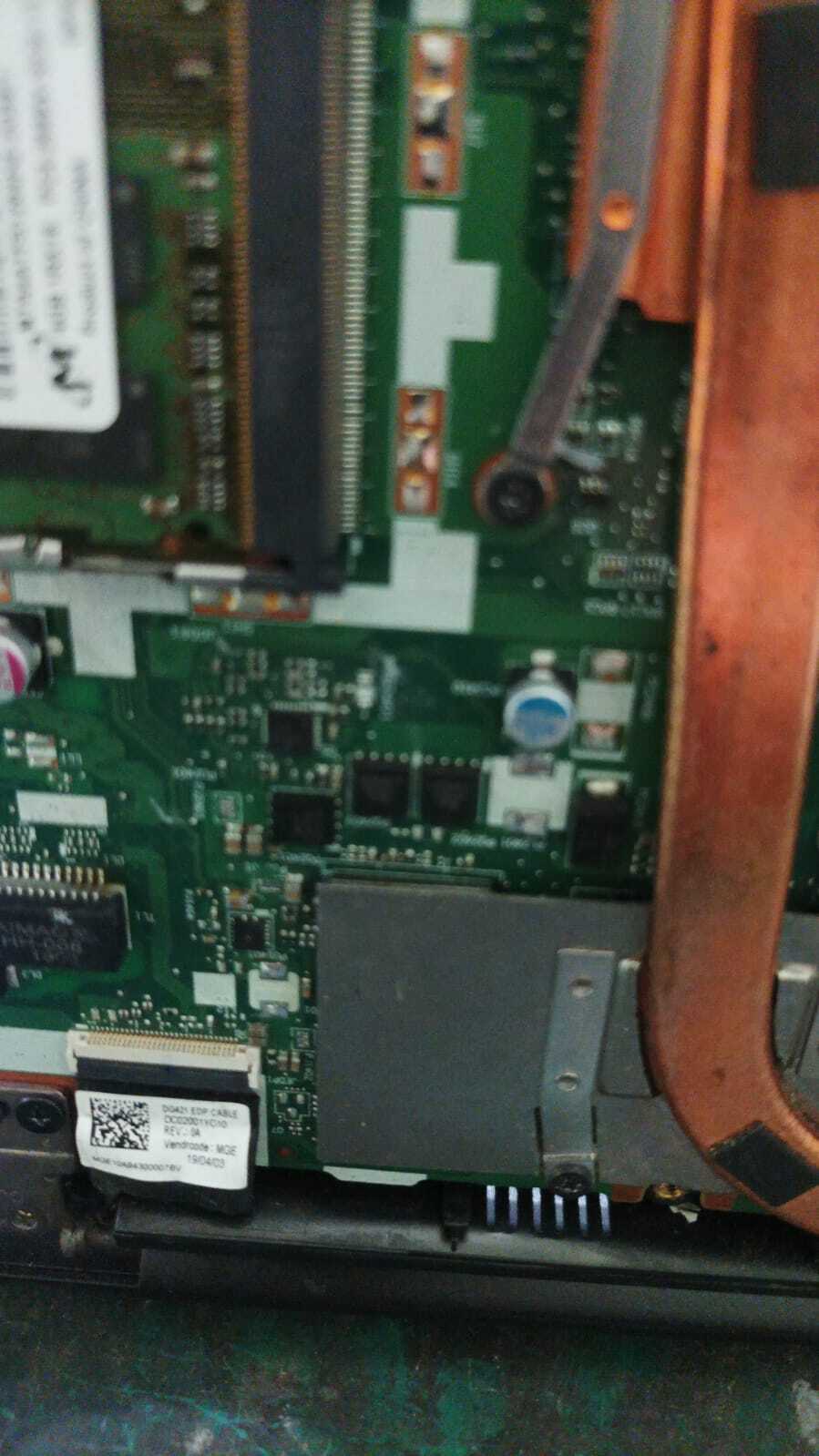

    can someone help me the GPU ram is shorted i wanna convert this to UMA coz amd A6 has integrated graphics.
    but i dont know how to covert this. i tried removing coils in gpu rail and gpu ram the short is gone but it doesn't display.
    i attached the schematic ang boardview.

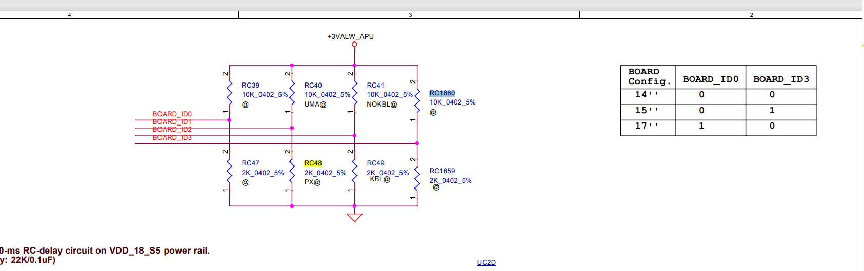

    Try removing RC48 and stuffing RC40)10K)

      RC40 is not present in the board only the RC48

        I removed RC48 and still it does'nt display only fan spin so fast.

          RC39 not present
          RC248 present
          RC1660 not present
          RC40 not present
          RC41 present
          i tried removing RC41,RC48 and put the RC48 in the RC39. doesn't work.
          i also tried removing RC41, RC48 and put the RC48 in RC1660 and it still doesn't work.

            You have not understood my post#2. RC40 is not supposed to be present for dis mb-you need to stuff 10K at RC40 postion. RC48 should be present on your mb and you need to remove it. Thats should be the only 2 steps.

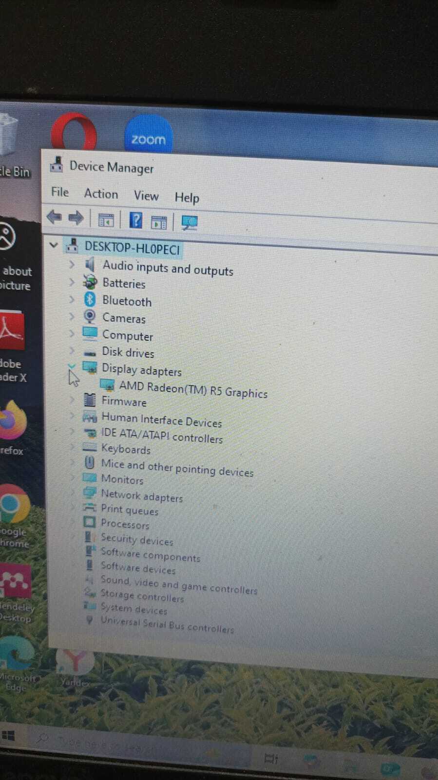

              thanks it works.

                thanks for guide everyone .
                laptop fixed .i appreciate everyone uma discrete ok​
