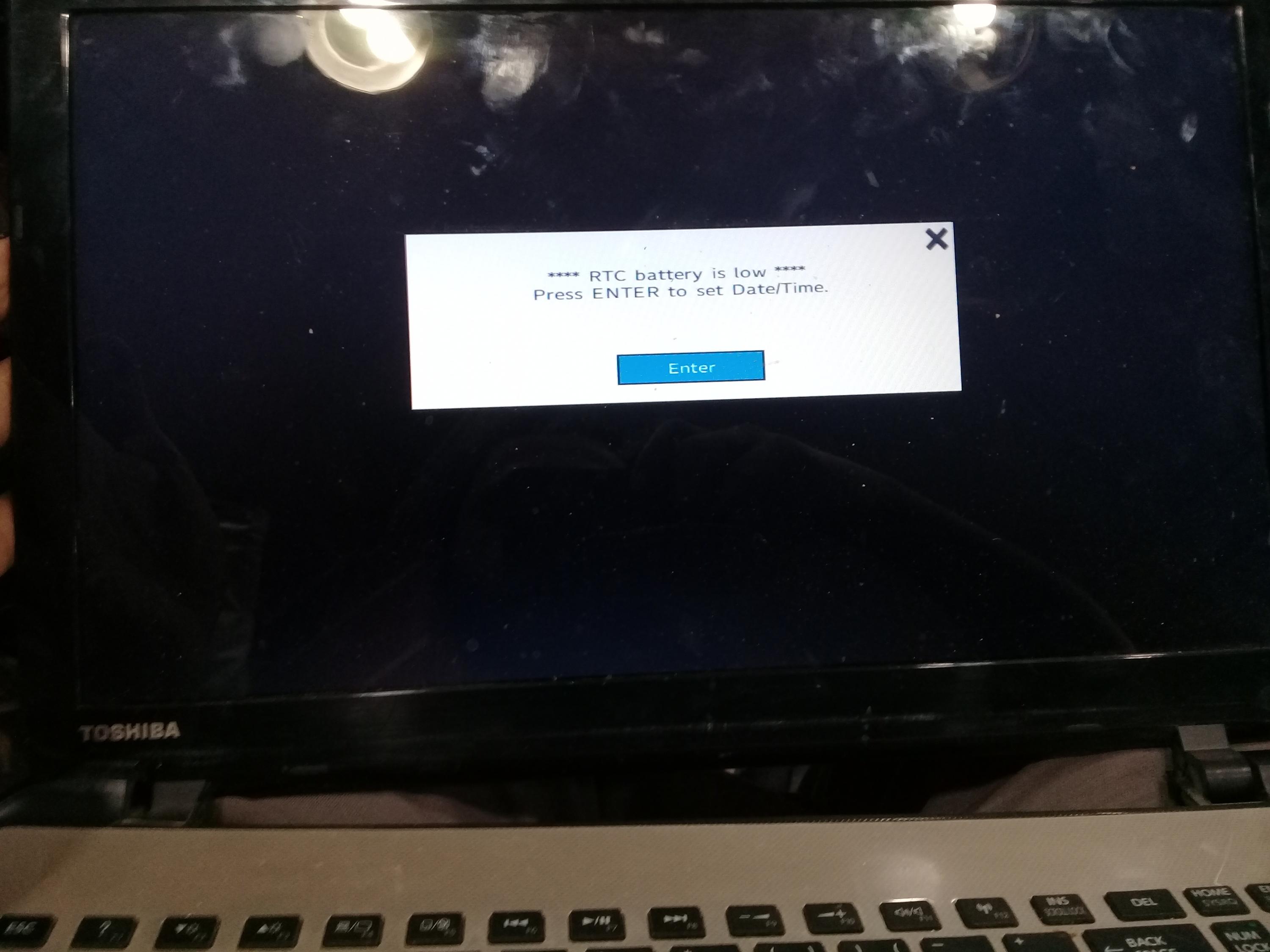

    hi all
    i need Toshiba c55d-b1273 MB DA0BLMMB6E0 REV: E bios
    i found it in this link
    https://www.badcaps.net/forum/showthread.php?t=61369
    but my file is 4mb
    when i replace the flash IC and program by 8mb file the MB don't power on
    can i found this file 4mb
    thanks

    Re: Toshiba c55d-b1273 bios
    Post your old dump .
        New Bios + your DMI + EC file .
          thanks a lot ...good job
          its working
