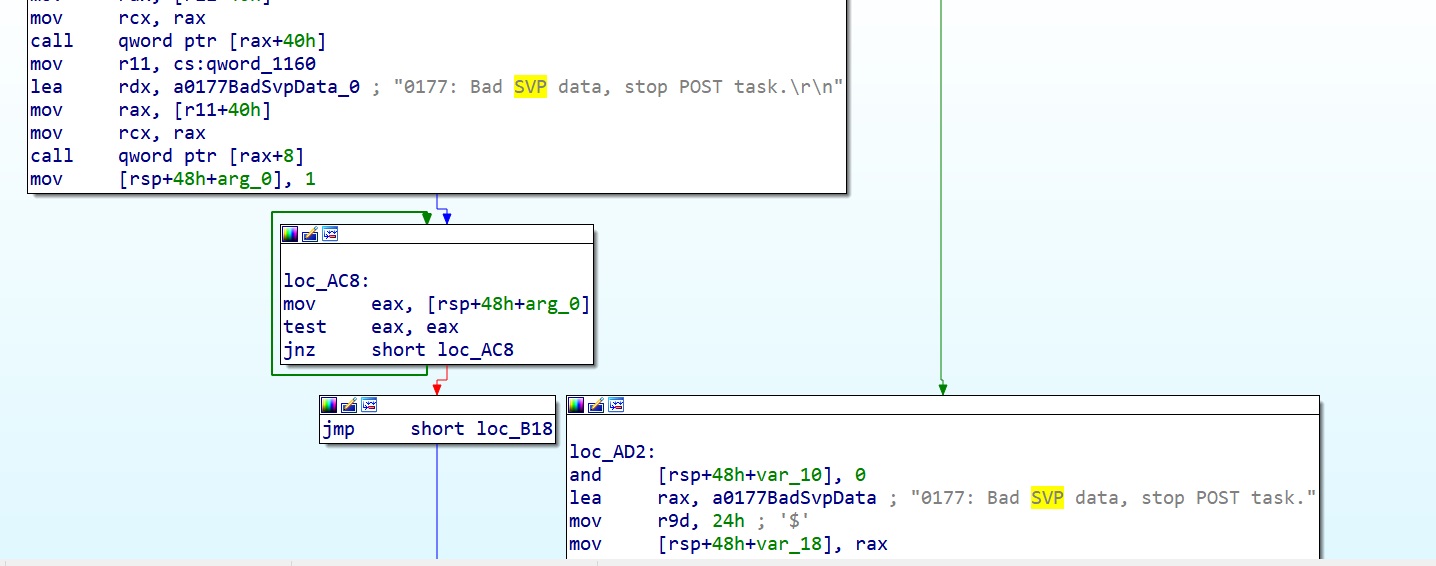

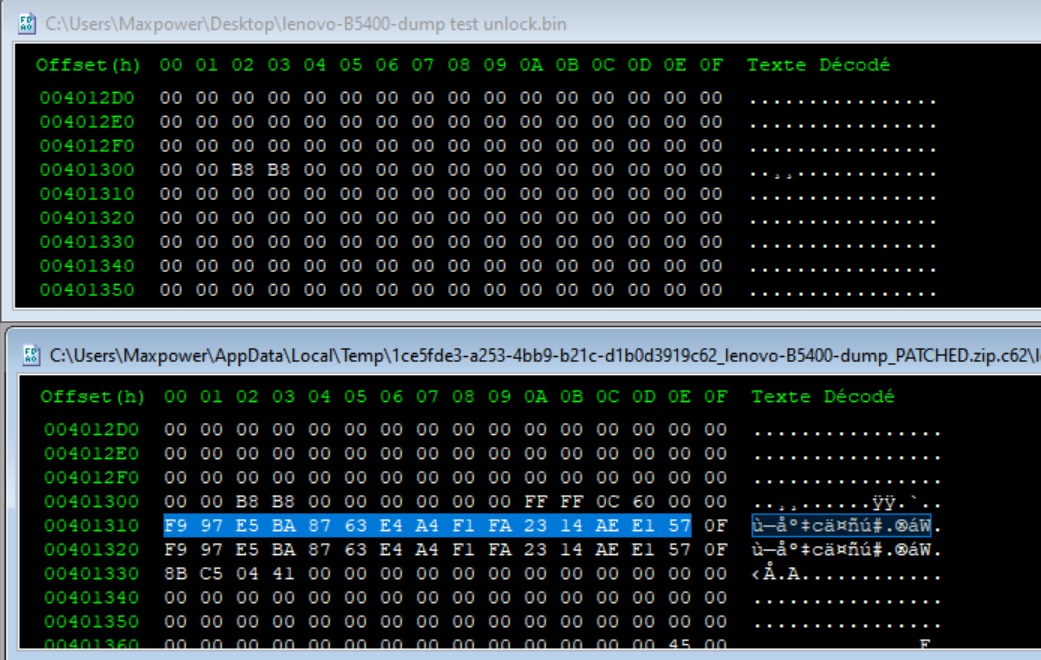

              Re: LENOVO BIOS AUTO-PATCHER for Supervisor Password Removal
              Hi, i have a Lenovo B5400 with locked bios (supervisor password) and seems that Auto-Patcher doesn't work with it.
              I tried to flash patched bios, and it boots up because i receive the screen "press any key, press two times space bar, etc.. and the final screen "turn off machine", but when i reflash stock dumped bios, the lock is always here.
              Any ideas??
              Here my Serial Number: QB08704354
              In attachment dumped and patched bios files.
                Any ideas??

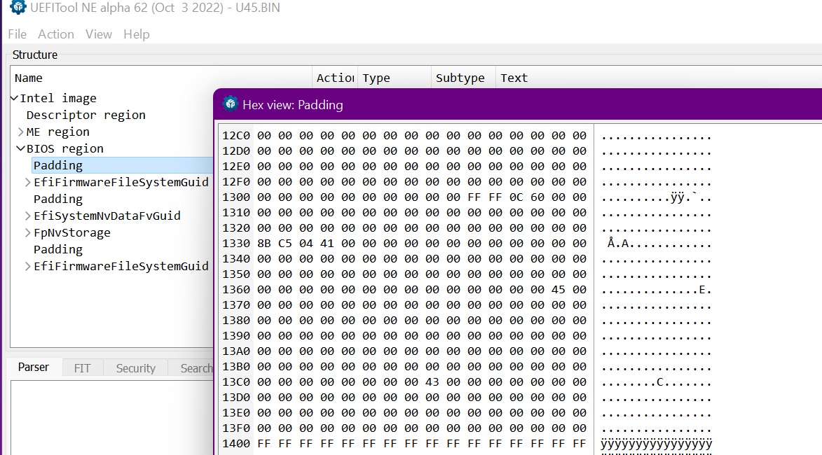

                try clean this
                  try clean this
                  i see inside dumped and patched bios, but i don't have this value like your screen, i have "empty" values (all "FF")
                  • Maxpower3
                    Bad Veteran
                    • Feb 2018
                    • 1226
                    • France
                    yet I find good in both dumps
                    try test unlock
                    EDIT : I forgot 2 values, I modified , test both unlock
                    B8 B8
                      try test unlock
                      ah ok, now i find it also in my files! so now i clear this 4 lines and will try to dump and check if it works.
                      can you give me the name of the tool that i can see on the left side of your first screenshot? thanks

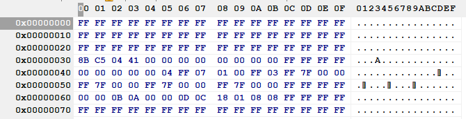

                          try test unlock
                          B8 B8
                          if you have error bad SVP data, change the end put back the 8B C5 04 41, remove only the 3 lines from the beginning
                          look pics for compare with clean by setup
                            i have exactly "SVP" error...but deleting the first three lines, now i have black screen and no boot or sound.

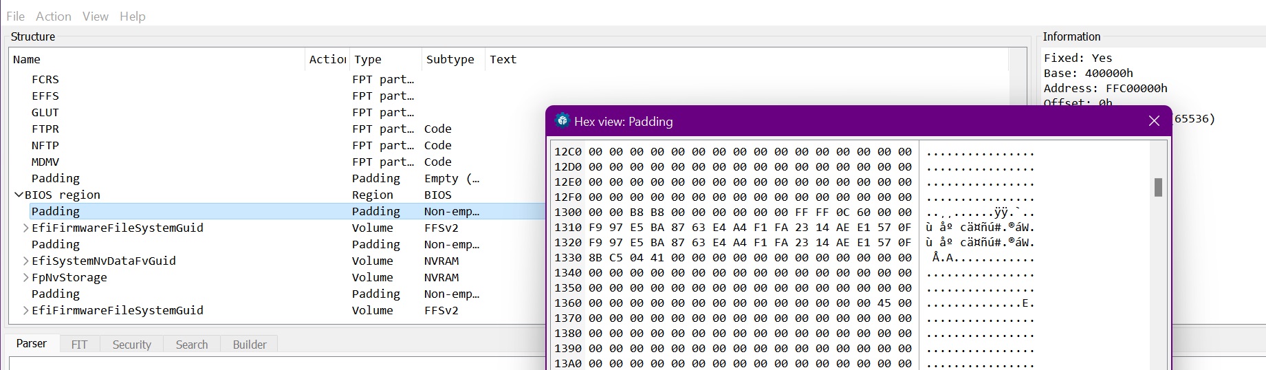

                              do you have access when SVP error or power off direct?
                              try another maybe
                              edit:
                              otherwise we can try a jump here, if no one has any other solution.
                              After bypass you will have to enter a new password or otherwise blank with entry.
                              the checksum will thus be corrected, you can leave bypass or remove with a new read and restore the modification
                              00 isn't FF
                              Multi edit We should continue here, https://www.badcaps.net/forum/showth...t=Lenovo+B5400
                              I hadn't seen that they talked about EC for this model. We are in the right place given the SVP error, must have a mirror map in the KBC maybe.
                                in the SMDFlea files it's like this
                                https://www.badcaps.net/forum/showpo...32&postcount=5
                                  try another maybe
                                  edit:
                                  00 isn't FF
                                  a moderator can move the thread perhaps ??

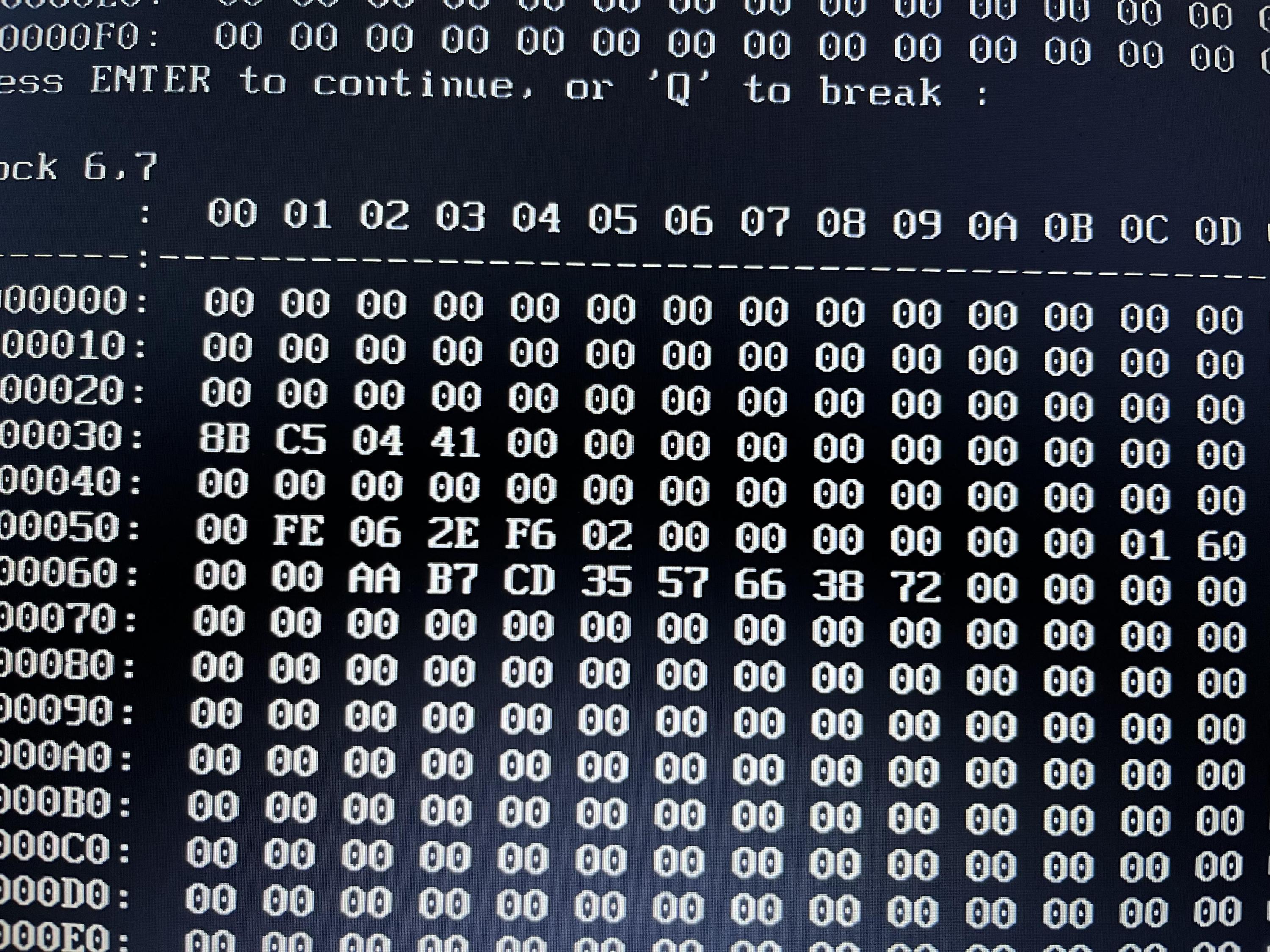

                                  "test3" file in the rar WORKS! so now i have no password and unlocked bios! thanks!!
                                  • Maxpower3
                                    Bad Veteran
                                    • Feb 2018
                                    • 1226
                                    • France
                                    no point doing the KBC then
