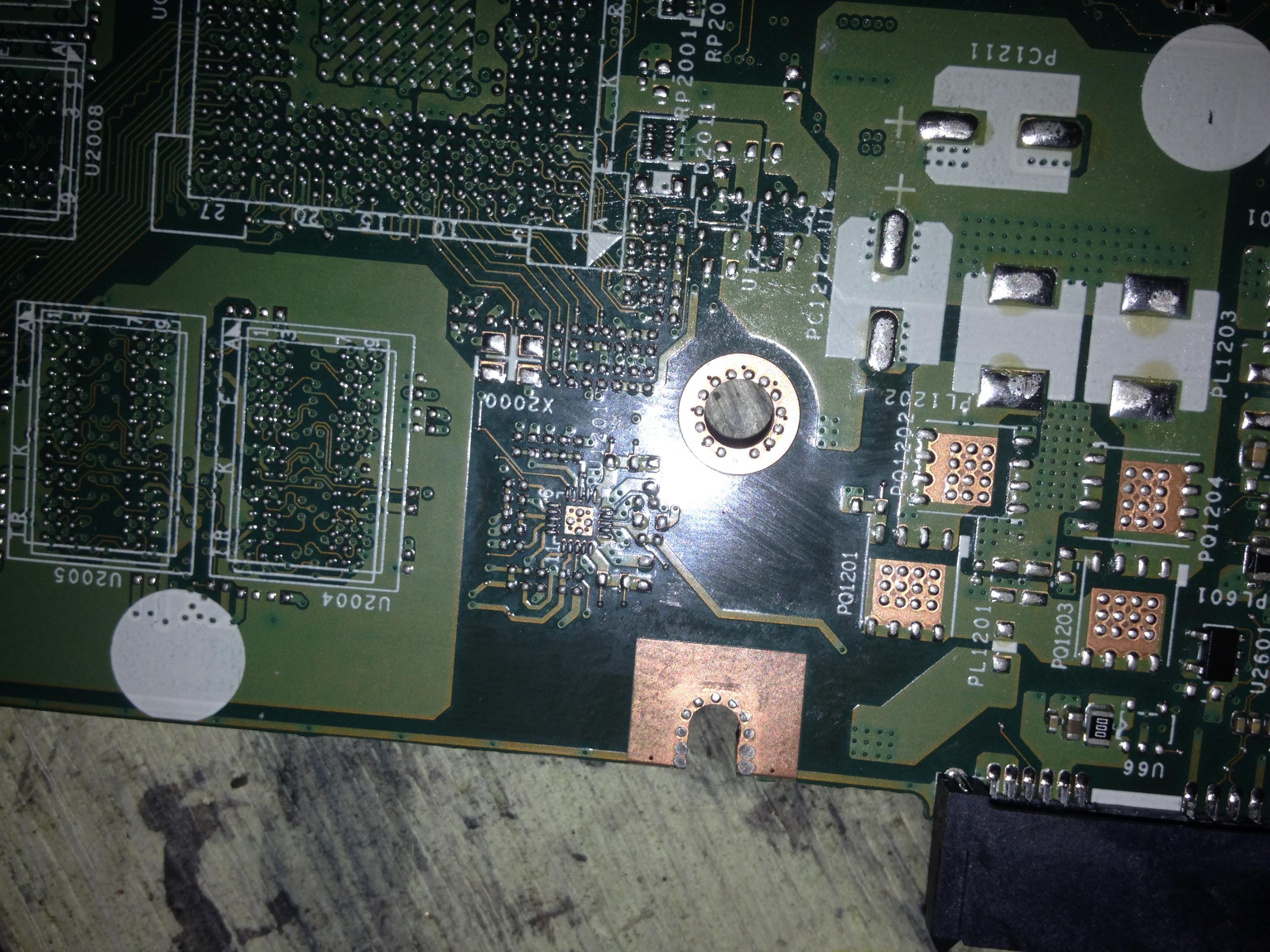

    I need help can someone fix this original dump the problem it turns on fan spins at full speed but there is no display the board id:A4WAB LA-C341P REV 1.0

              Do you have VCC core?? If VCC core is missing then fan also at full speed on some mb.

                I think bios is ok there is somewhere else is the problem,because sometimes it shows display once and then it will not and fan at full speed vcc core is missing and U16 pin 2 and 6 of transistor has no voltage standby but if i turn on voltage is present anyone please help guide this please

                  anyone please help on this there is no voltage on PL1203

                      Hi, give me all the voltages on the PU1201 chip.

                        Thanks for the reply jarotech i cannot find the pu1201 chip on the board

                          Re: Acer e5-473 no display
                          It should be near the PL1203 which has no voltage.
                            i found the pu1201 but there is no chip on the board see attached
                              i found a chip near a pl1203 it pu601
                                I am referring with only the schematics of the Acer Aspire E5-473. If you do not have the PU1201 chip, you should not have the PL1203 coil either.
                                  you are correct i check it again i dont have pl1203 its pl602 above of that coil is pl1203 and its blank and don't have coil
                                      Ok, but what are the voltages you miss?
                                        update: if i rest overnight when i try to turn on display comes on but when i shut down now it blinks and then fans spins at full speed but there is no display. tried already mild reflow on cpu but still same issue
