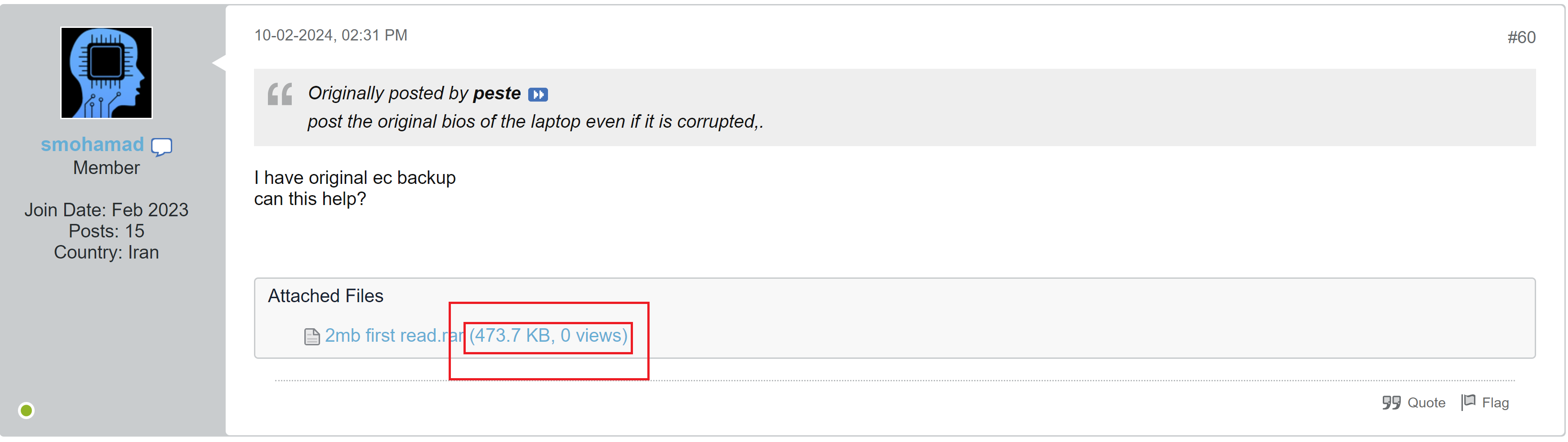

    I have original ec backup
    can this help?
    Backup fault

      Originally posted by hoaca388
      Backup fault
      How? Can you explain what you want to do with ec backup?
      It's not faulty and it is working I backup it up 3 times and compared them with each other and those were completely identical
        It is only 473.7KB after compression.
          ok, I understand what you mean
          It's okay I checked file, it's true before extracting 473.7KB after extracting 2MB
