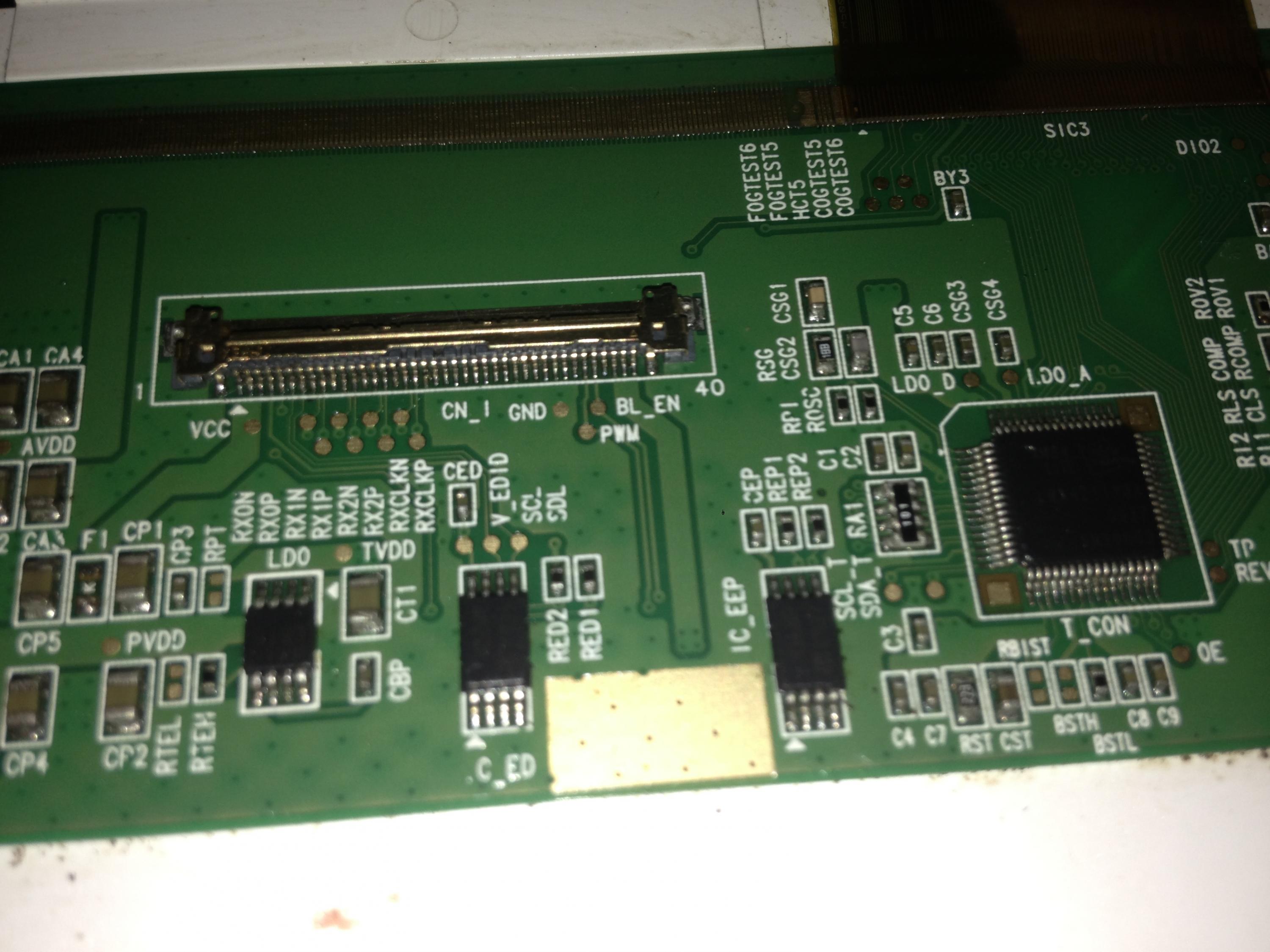

    Hi friends i need a working bios for this model Lenovo ideapad s10-2 notebook board id:KIUNO LA-5071P REV 1.0.The problem notebook turns on fans spins 10 seconds turns off but light steady and i can press capslock on and off but there is no display on the screen already tried external the same.I already tried slight reflow on cpu and pch but the same issue i need to try flash bios.Anyone can share a working dump for this please

      thanks second file is working bios, but i have second problem the screen has no backlight but when i replaced with good one image is ok the screen is the problem.I have check bclight enable have 3.3v and PWM have 3.3v.Is there a chance to fix this screen backlight?I have upload the images board of the screen can someone please help on this
