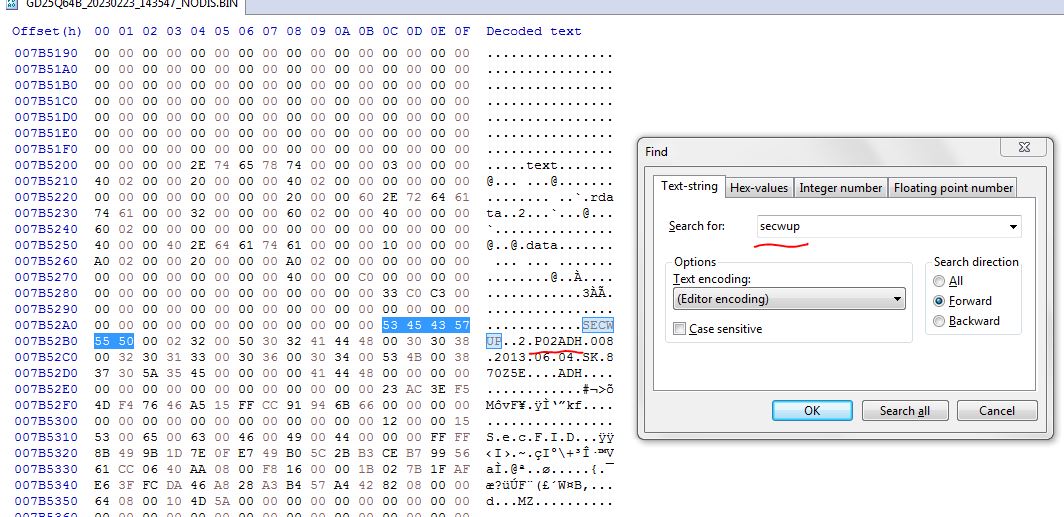

            maybe someone could repair my attached backup with no display problem.
            infos:
            Samsung NP870Z5E
            nike2-15H_QC
            rev: 1.1
            intel processor with RADEON GPU
            thanks
              • 22279
              Re: Need - Bios Samsung NP870Z5G BA41-02337A
              infos:
              Samsung NP870Z5E
              nike2-15H_QC
              rev: 1.1
              thanks
              With these old samsung models its usually the NVRAM that gets corrupted,so cleaning the ME firmware might not fix it.To find the right bios look for platform ID in your backup using a hex editors search function https://www.badcaps.net/forum/showthread.php?t=88206
              The bios at post #4 is P09RCL ,P09 is the bios version, RCL is the platform ID .Your bios is P02ADH , platform ID ADH
                • 22279
                P05ADH ME_Clean + DMI.
                • salawayon
                  • Nov 2012
                  • 578
                  • philippines
                  thanks. maybe someone could share the right bios file...
                    • 22279
                    You have the right one at post #8
