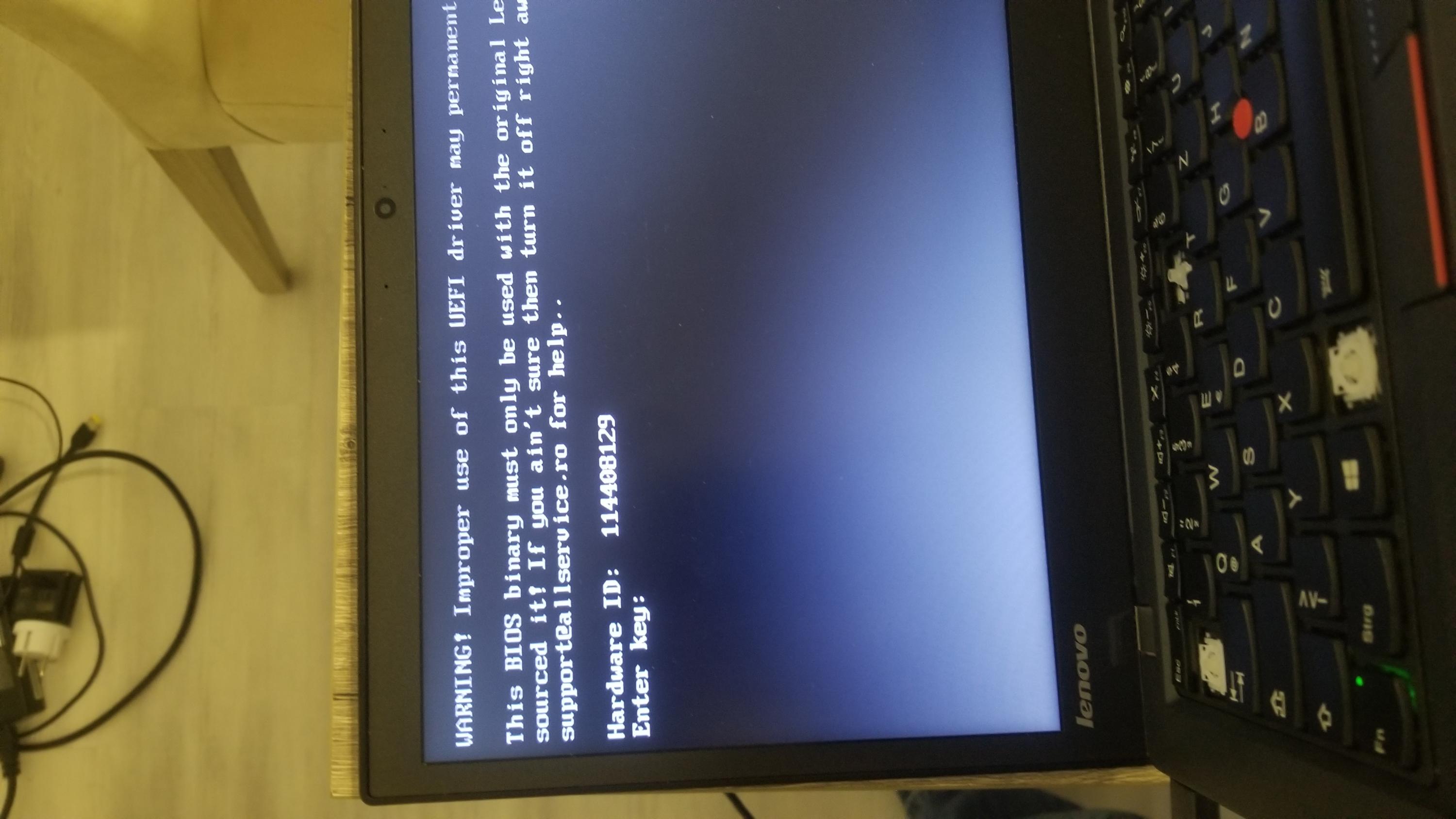

                  • maslantas
                    • Oct 2020
                    • 13
                    • Türkiye
                    #1209
                    Re: Remove_SMM... UEFI.

                        #1211
                        Originally posted by qayyum786
                        instruction from post #1211
                        froze here
                        • maslantas

                          #1212
                          ok i passed there
                          key?

                            • maslantas
                              • Oct 2020
                              • 13
                              • Türkiye
                              #1214
                              in witch step its hangup ?
                              hardware ID :114408129
                              Enter Key ?
                              • maslantas
                                • Oct 2020
                                • 13
                                • Türkiye
                                #1215
                                I'm about to go crazy
                                Everything went very well.
                                I uploaded the decoded biowater
                                I typed 1234 in the hardware id part and passed
                                but the screen does not go any further than thinkpad text
                                bios i wrote it again it stays there
                                I do f1 esc, bios information is coming, I press a button
                                It says "thinkvantage active protection sensor diagonostics start" then goes away, screen stays black
                                • qayyum786
                                  • Aug 2018
                                  • 1959
                                  • INDIA
                                  #1216
                                  tyr with another bios chip

                                          #1220
                                          Thnak You thank you thank you
                                          thank you so much
                                          my computer is working now
                                          i am grateful
