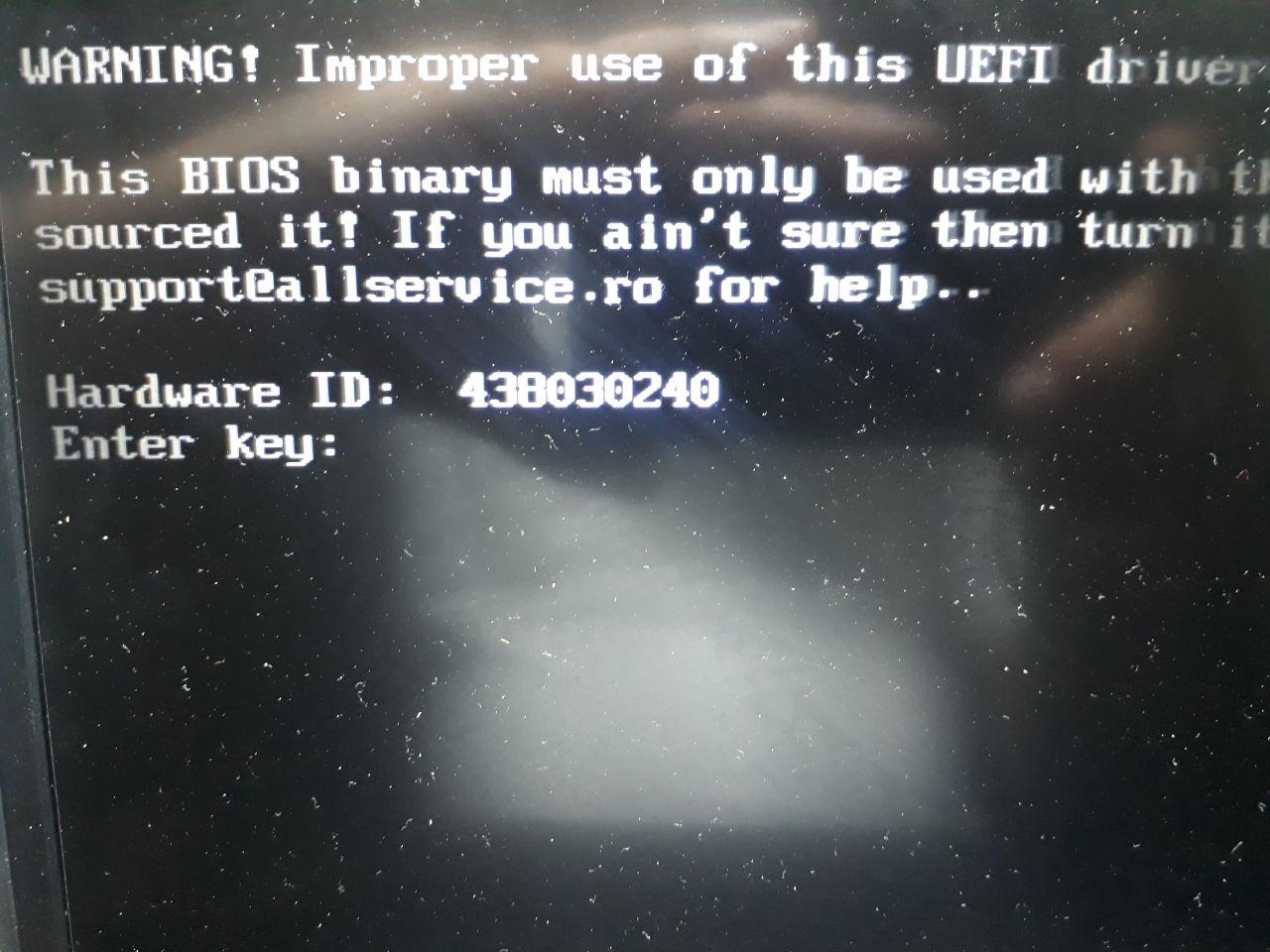

                                          #640
                                          Re: Remove_SMM... UEFI.
                                          i patched
                                          it go to hw id
                                          password when pressing enter or space two time
                                          no response
