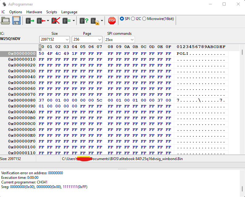

                    • wolf3d.exe
                      • Jan 2023
                      • 33
                      #170
                      Re: HP Elitebook 840 G2
                      My problem is solved. Issue was the lazy soldering job. Also I will attach the image that worked for me. After reprogramming chip log in to bios as a guest user, surprisingly create an admin account, login to that account and delete existing accounts. Also remove the password for the admin. Voila!
                      Thanks for the original poster for the BIOS also I used Colibri as programmer. Thanks again for the poster of Colibri. It worked without any errors. I will attach that too.
